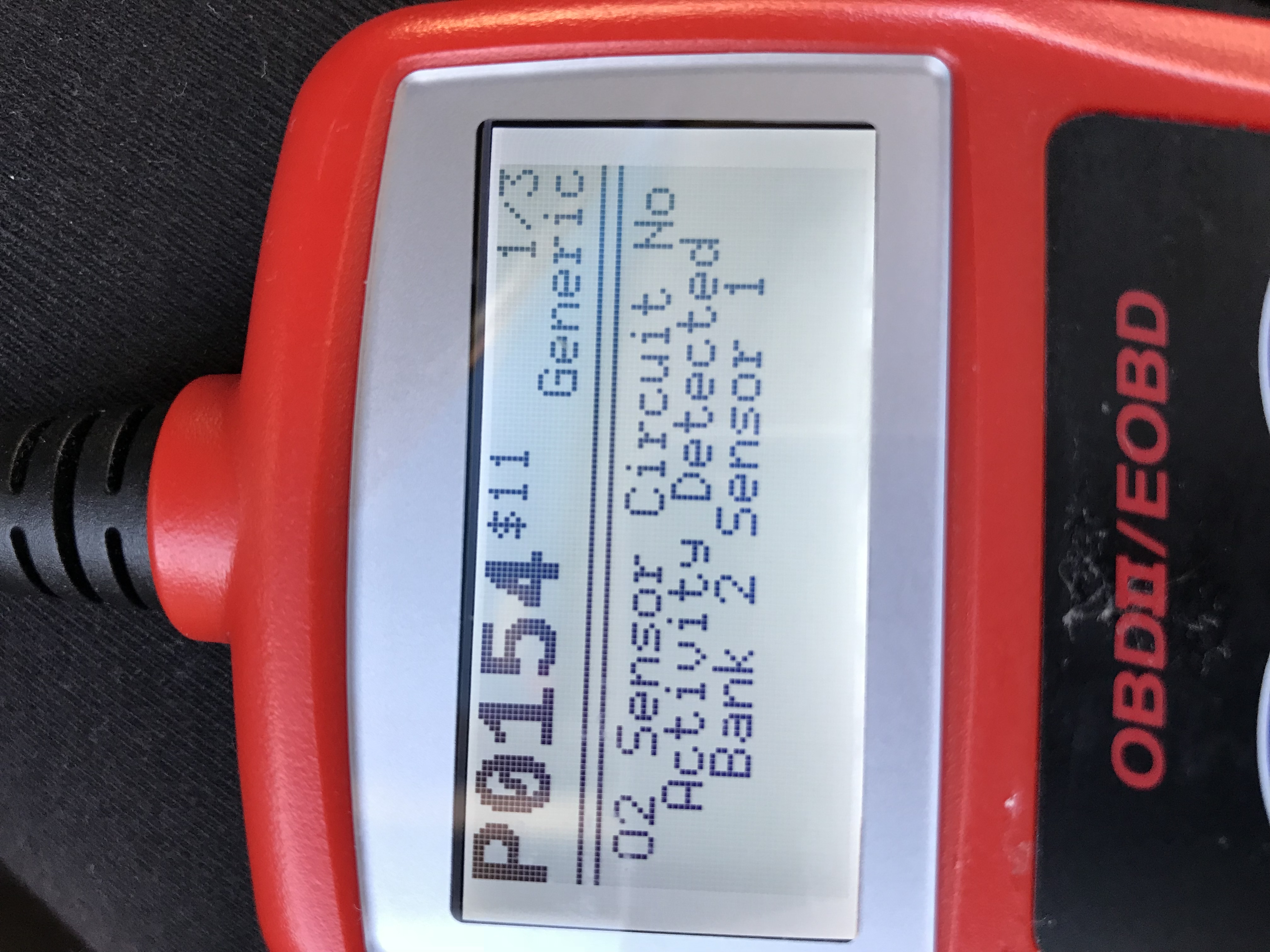

P0154 Error code picture attached
- RickHaleParker
- Posts: 7209
- Joined: 25 May 2015, 14:30
- Location: Kansas
- Been thanked: 980 times
284: ECM-290A (P0154) Front lambda probe, bank 2. Signal too low. Permanent fault
