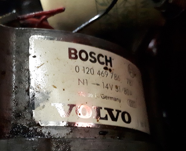

This car comes with a Bosch 80 AMP alternator but I have handy from a previous 1983 DL another Bosch but 55 AMP one, I am wondering if I don't use the heated seats and since there is no air conditioner, could I just use this smaller output alternator? Or at least it's voltage regulator if it comes to be the culprit?

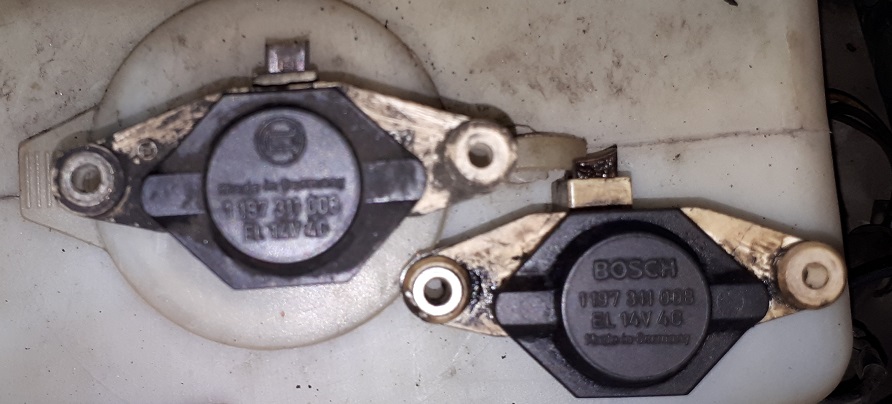

The voltage regulator from an older 55amp Bosch alternator is exactly the same than in an 80 amps later Bosch unit, same part number and identical pieces as you can see in this pic. So they are interchangeable. Part number: 1-197-311-008
The hardware attaching them to the alternator is different though, the newer unit had Phillips than were almost stripped but somehow a Robertson #1 would also fit in there and with some effort, I manage to bring it out. The older hardware is two flat heads, so better for not stripping the head, but actually, the tip of the screw has a square profile and makes it a PITA to find the holes when reinstalling the Voltage regulator into the alternator. I did not remove the alternator from the car, just the VR from it. The newer hardware is easier to strip the head but the tip has a round profile and it's easier to find the holes with them. So after a while trying with no success with the old screws I tried the new ones and it was much easier.
I also remove some of the other wire connections and clean them of all the oil that has been dripping into this unit from somewhere in the cylinder head.
After revealing my brushes in the faulty alternator they came out to be really short, way under the wear limit (7mm) and all dirty with some copperish greasy paste. The 55 amps alternator brushes were maybe 2 or 3 mm longer than these. So I thought I would give it a try.

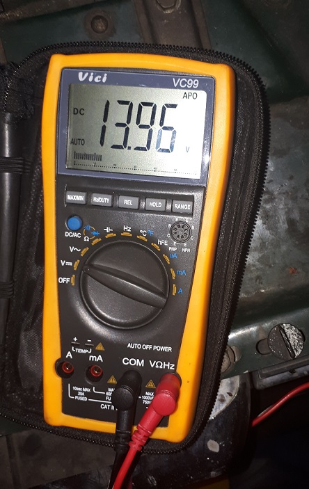

After installing this older Voltage Regulator and messing around with some stripped bolts in the battery connections, I finally got my other Volvo battery and installed it. Checked voltage in this battery and it was around 12.23 Volts.
Started the car and the voltage at battery connections was 13.96 Volts while idling at 800 RPMs. Idle was steady and the battery sign light was totally off.
Very satisfied with this, I will now order some new brushes for this Voltage regulator to keep it as a spare. Then when the warning battery charging light start getting dim again I will know its time to change this again, now with the experience of what to do and how to do it.
