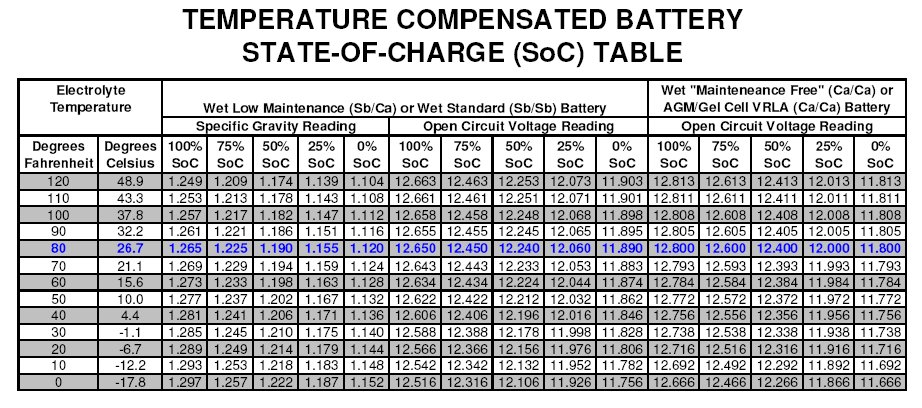

12.05v at battery terminals seems pretty low.Of course....it is temperature dependant:

XHeart probably at 5-10F courtesy of Canadian air mass at present...

Whatever....it's around 30%.According to the table it's almost discharged.
I wonder how it even cranks with voltage that low.X-heart says that engine turns quickly.In that case i would say that multimeter reading is incorrect....or it was 12.5v instead of 12.05v.
