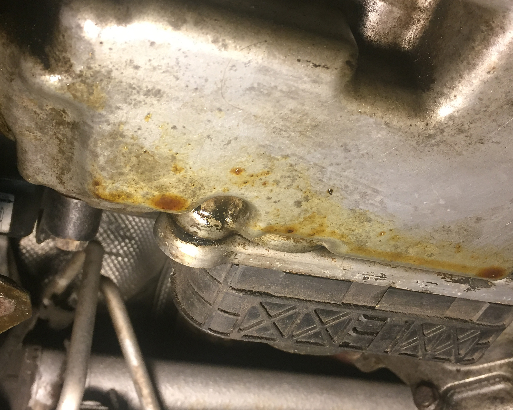

Over on V70XC, it is Platinum Full Synthetic 5W-30 grade. There wasn't much loss of oil on dipstick, but the bottom of oil filter housing collected fine material mixed with oil -- a teaspoon worth. Here is a photo of oil pan before the oil & filter change. What to expect?

I think the pan is tilt towards the rear so the oil will accumulate at the rear bottom of the pan but may be leaking actually from the front of the engine ? I stand corrected. If it leaks from the front of the engine, look with a flash light if it leaks from under the intake manifold, it could be a broken PCV hose. The PCV on these cars needs be done preferably around 80000 miles.
If the leak is from the rear it may be the oil cooler (the black part in the picture)

Just after my first oil change on this S60, I was fooled by a minor spill at the oil filler that had slowly made its way down to the pan.
(I thought I had cleaned it up) but it looked like a scary leak from the top PCV hose.
