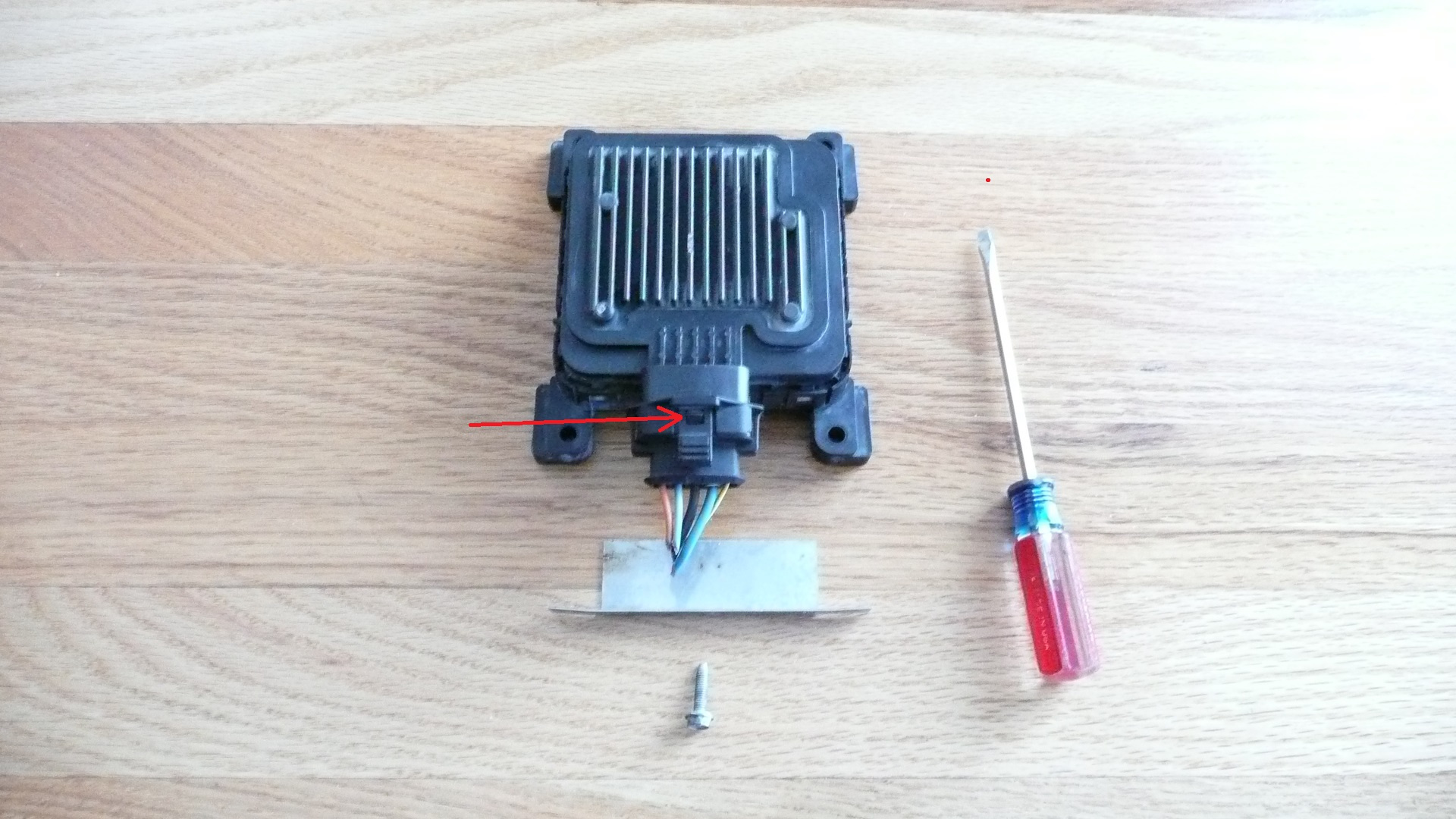

I agree with replacing it.
It is just electronic component(s) failure more than sand getting in.
When buying used on ebay, I'd recommend searching for a PEM unit with Velcro (check ebay photos) bc
Velcro is used for PEM units that are located inside the car (under rear seat or trunk).
These units are probably better than the units that sit outside (under the car).
Although the video by "Peppermint" is nice, there are some minor errors.
Peppermint said the bolt is 6-mm and commented on the metal plate orientation:
1. The bolt is 7-mm, not 6-mm.
The retaining metal plate should be oriented as in my photos below (the Volvo logo
facing you, good advertisement lol).
2. Do NOT disconnect the connector in situ, very difficult,
one can actually damage the connector doing so.
3. The trick is to loosen (NO need to remove) the 7-mm bolt,
slide the metal retaining plate out. Then slide the PEM out.
4. Now you can squeeze the tab with fingers (usually this is NOT enough to lift the
inner tab enough), so use a small screwdriver GENTLY to lift it up as shown.
Then it will be easy to disconnect.
Hope this helps...
