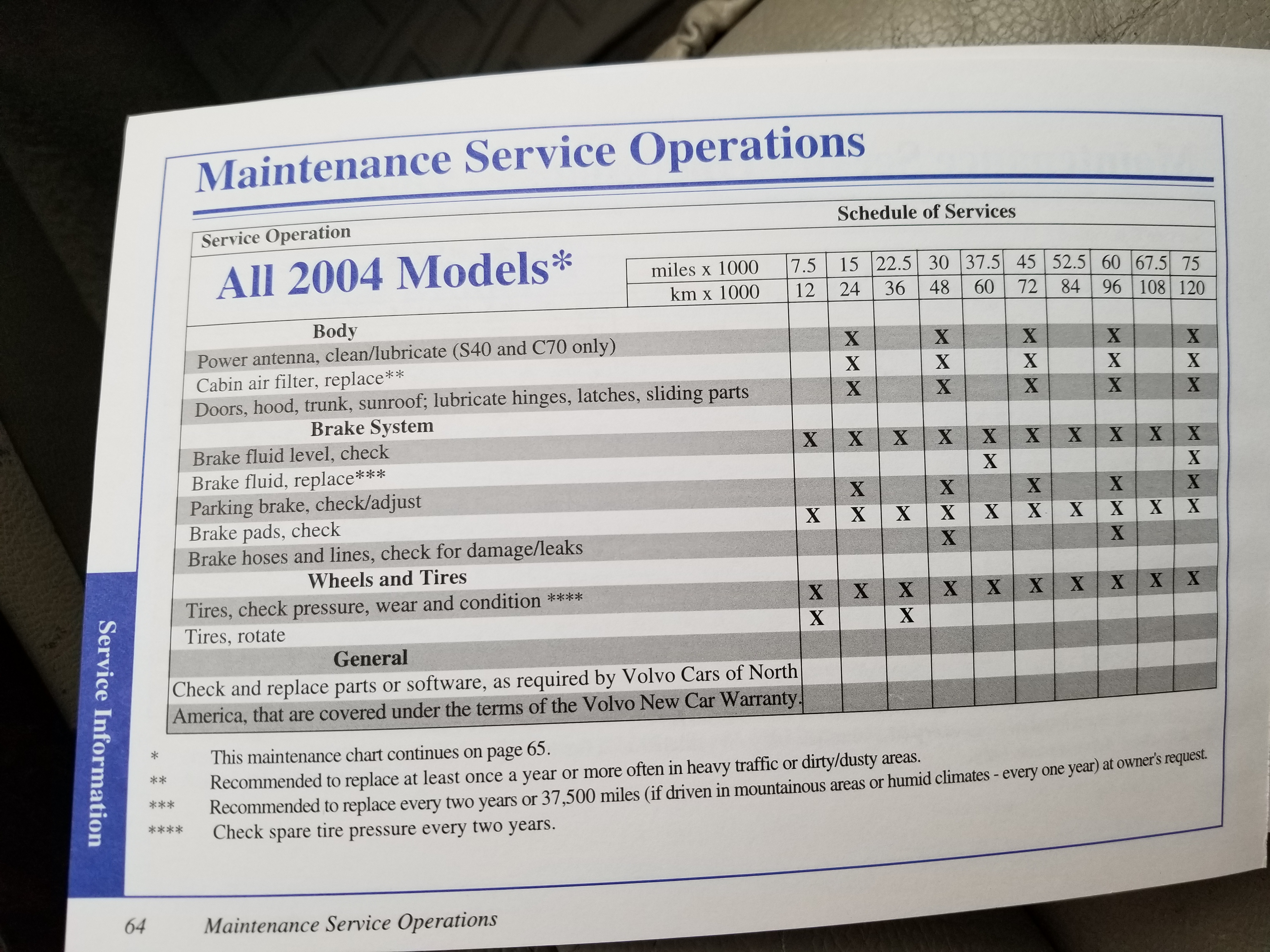

One thing you did not mention is the break fluid change interval? These cars have one. I have mine changed much more often than Volvo recommends. I have been having it done every two years or 30K. By then it is rather dark and afterwards it seems for quite a while the front and rear breaks seem to work better together. June

You might be right on the 2 years, but with the expensive ABS unit who would want to leave old fluid in there? I personally live on the water at Jacksonville Beach so high humidity for sure. It's only $100 at the dealer for the flush Dot 4 so I see it as cheap. JuneRattnalle wrote: ↑22 Jan 2018, 14:39 June's brake consumption sounds more in line with what I'd expect and what I've seen on my P2 (and P80) cars.
I think every two years is actually the recommended interval for brake fluid but it's a recommendation not a must among the service items. A humid climate will require it more often than a dry one though. With excessive wear I'd suspect the calipers don't move as they should and a fluid change is worth a try and quite cheap and easy to do.
Worst I've seen was on a 745 '87 I bought for $150 with a promise I could return it if it didn't pass inspection. It passed with flying colours but later when I checked the brake fluid a rust coloured goo came out rather than a fluid..
Addendum says*** 2 years or 37,500 miles I am going to start replacing it every year. You should be familiar with the maintenance schedule and don't do any less than minimum. Some fool tells you something like run the oil 15 K or 1 year don't listen, these cars have minimum requirements in the book and Keep in mind these are not 2018 new cars. On the other hand many on here think I am a fool for exceeding the maintenance requirements servicing more often. I want my car to last the rest of my life if possible as I love the car.
