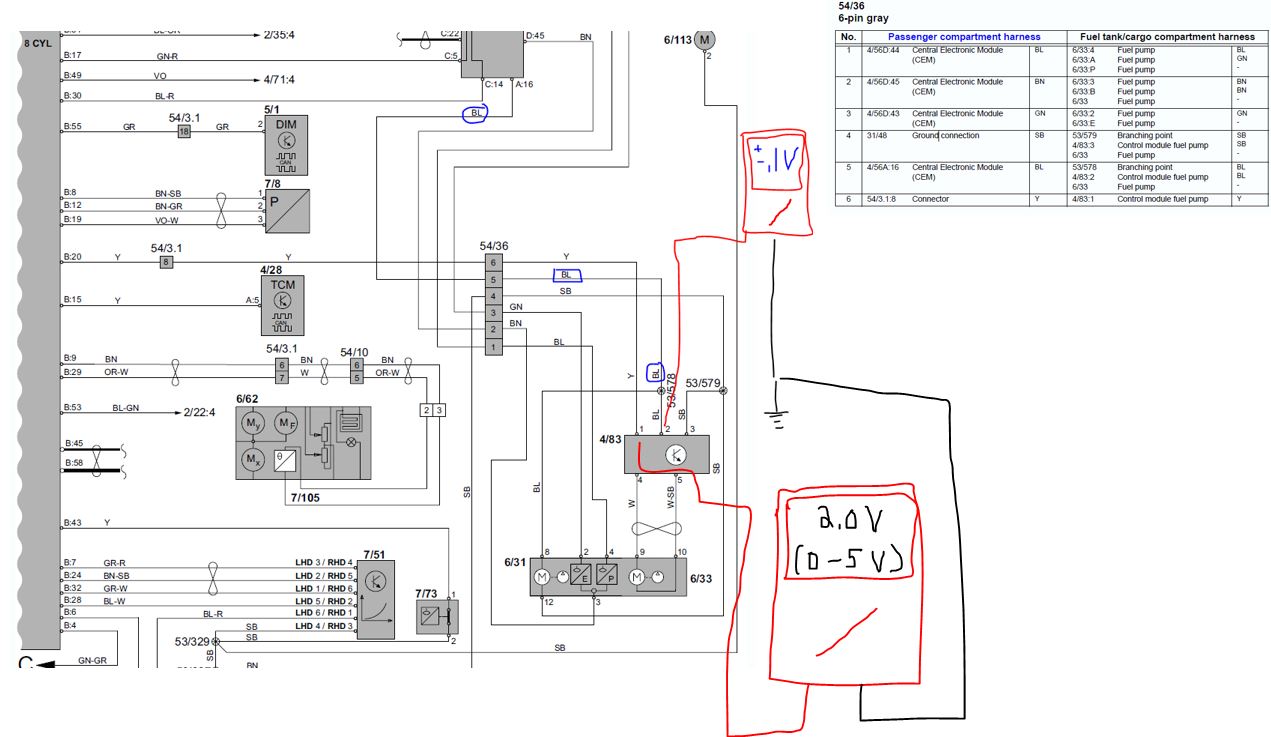

SHOCKWAVE
Posts: 42
Joined: 3 January 2018
Year and Model: 2007 XC90V8S
Location: IRVINE, CA
Has thanked: 24 times
Been thanked: 4 times
Post by SHOCKWAVE »
No electrical testing yet...Haven't done much of this on an auto so I'll be learning a new skill here. I need to get some backprobes first...However, the CEM would generate a code if the voltage is too low from what I understand of the description I posted ..."From 372: CEM-3F90 Fuel pump relay. Open circuit or short circuit to ground."
(B+ = BL ?)
Test like this?
