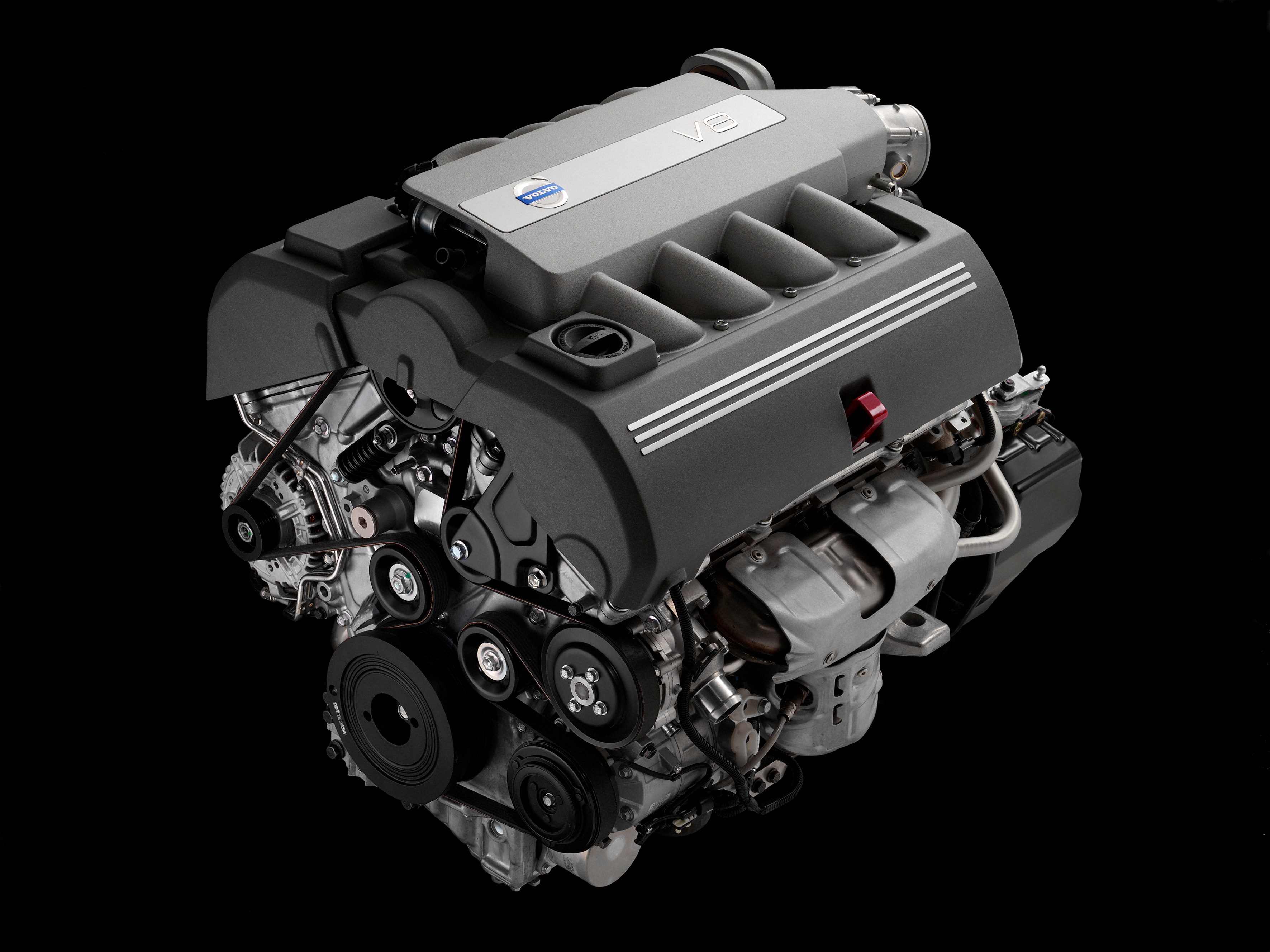

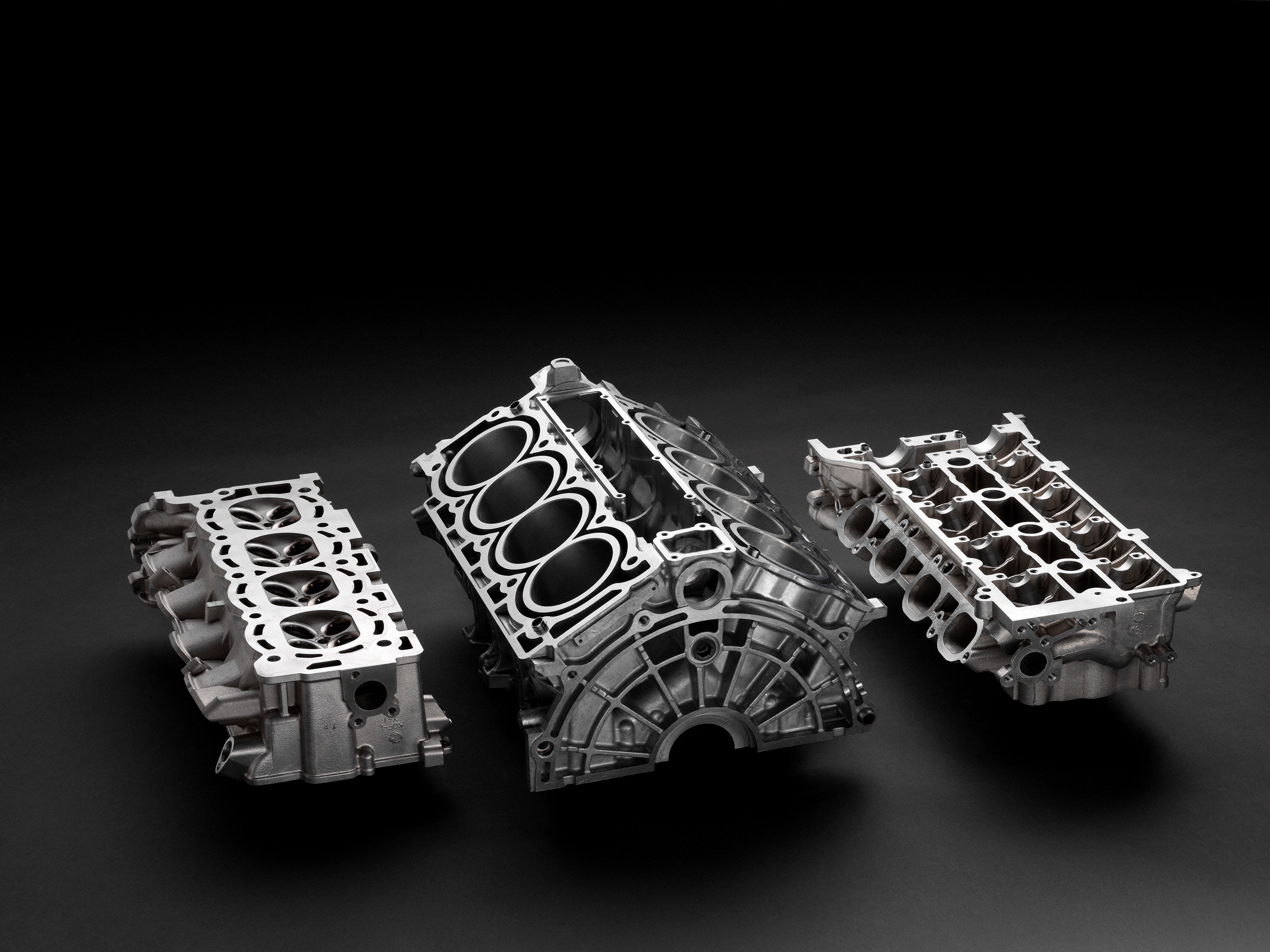

While waiting for the next installment, enjoy some stock XC90 V8 photos, courtesy Volvo North America:
