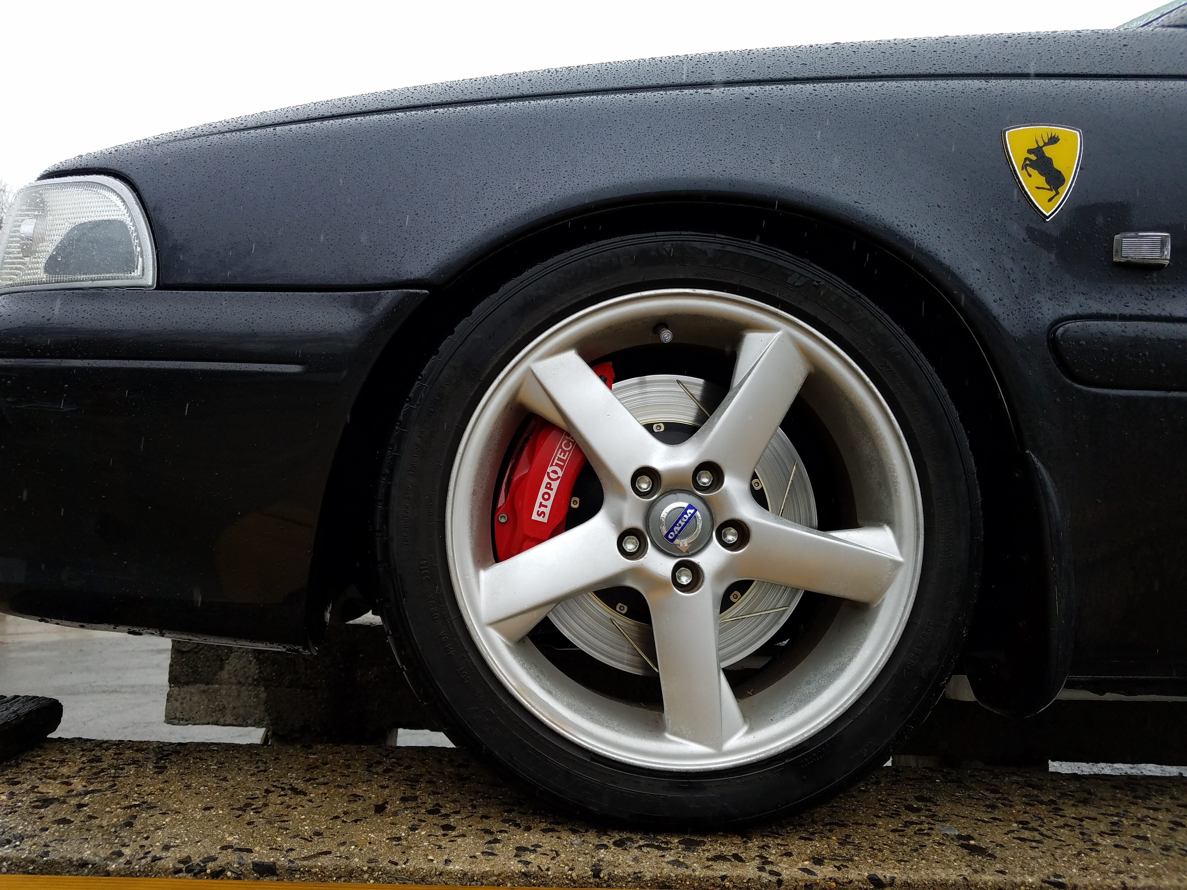

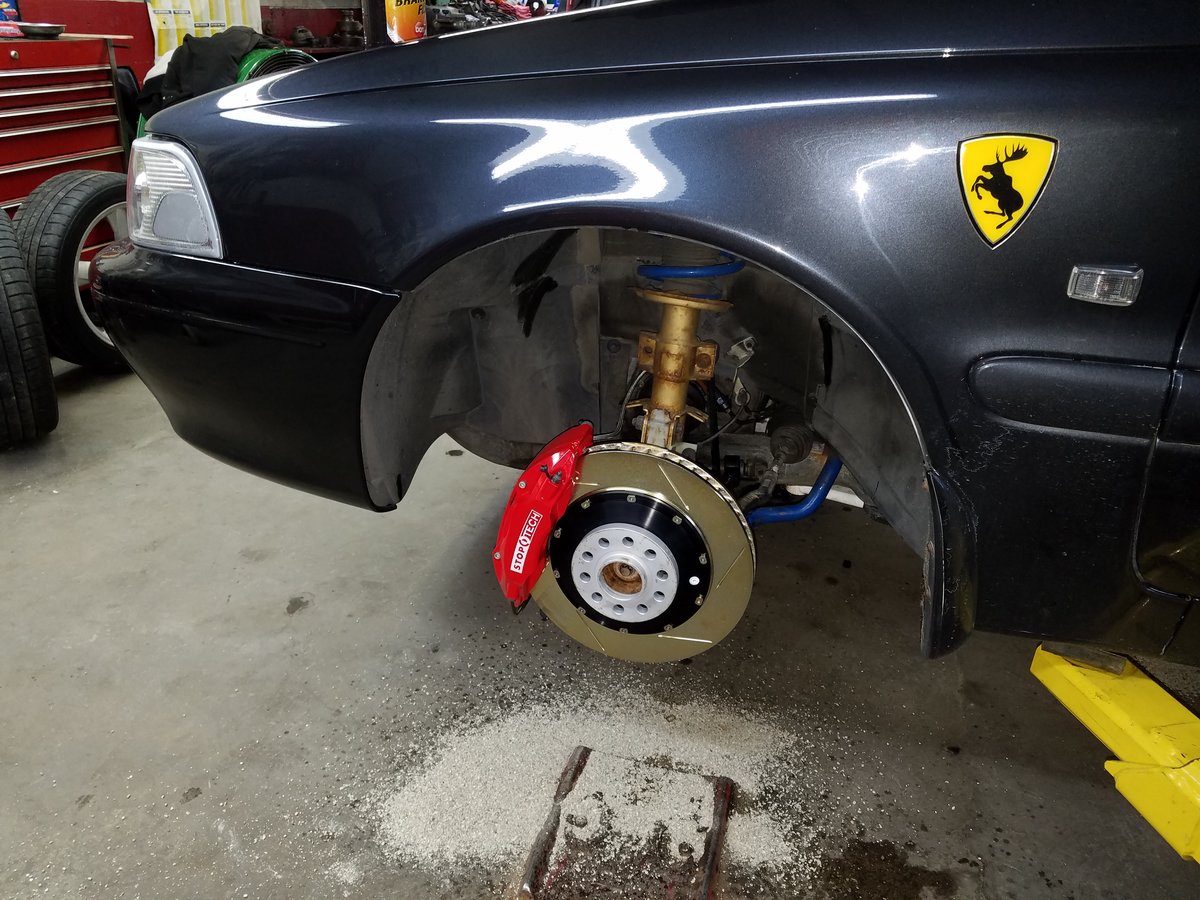

So...Thru some trial and error, and conversations with fellow enthusiasts as well as staff at Discount Tire, I have mounted StopTech brakes ST-40 332x32 and found wheels that fit.
See photos.![Image]()
My stock rims are 17x7.5 with a 42mm offset. They will fit over the StopTechs...BUT...only with H&R 15mm spacers and longer wheel bolts. However, after talking with a Discount Tire helpful person, I found a beautiful set of TSW Nurburgring 17x8 wheels that fit direct bolt on, no spacers required.
I wanted to stay with the 17" diameter wheel in order to have a 45 aspect ratio tire...to absorb more road bumps and potholes. With an already lowered and stiff suspension, going with 18" rims and a 40 aspect ratio tire, the ride would potentially be too severe.
Sorry, no photo of the new wheels yet. What you see on the car are my Volvo originals.
See photos.
