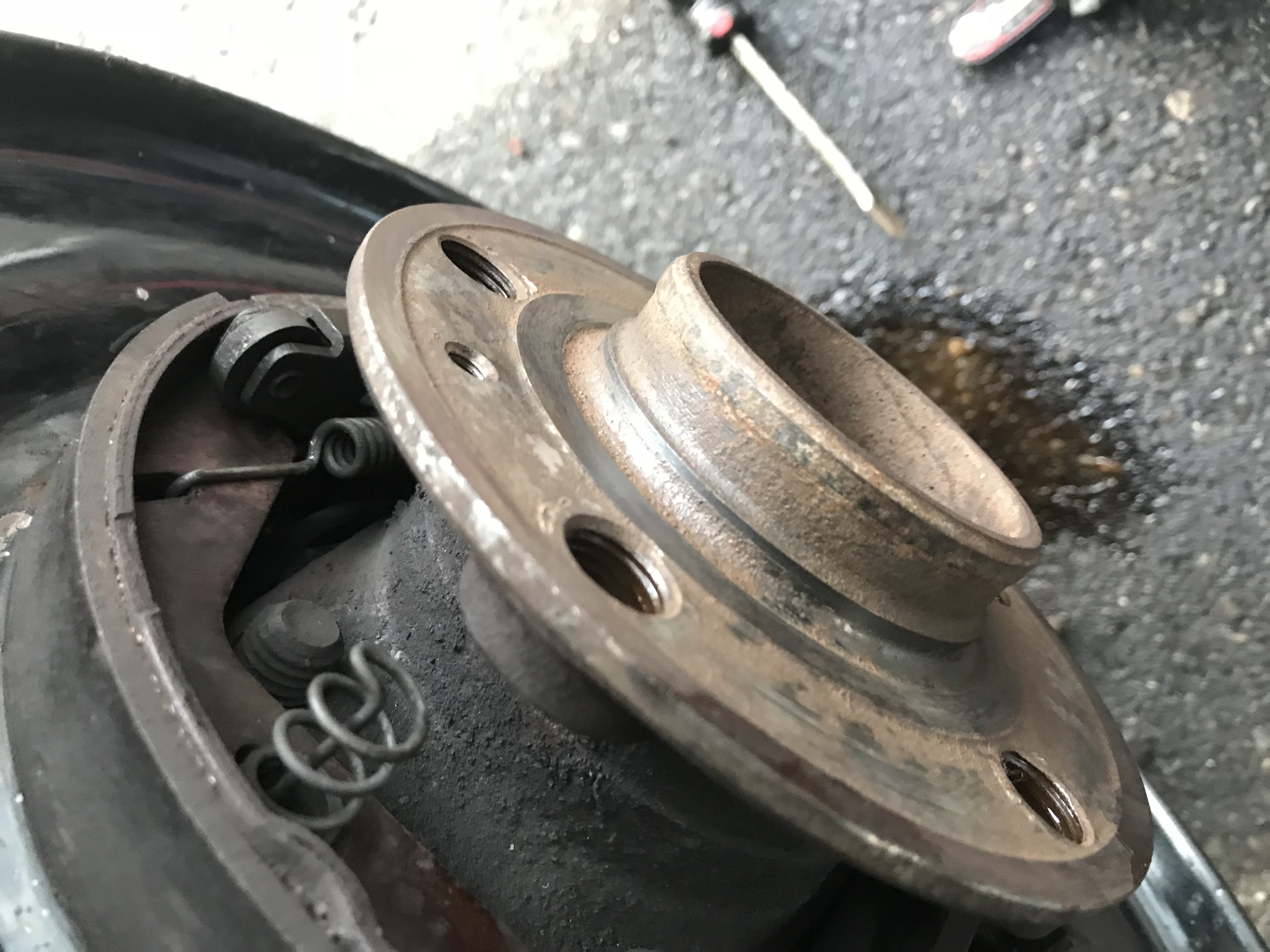

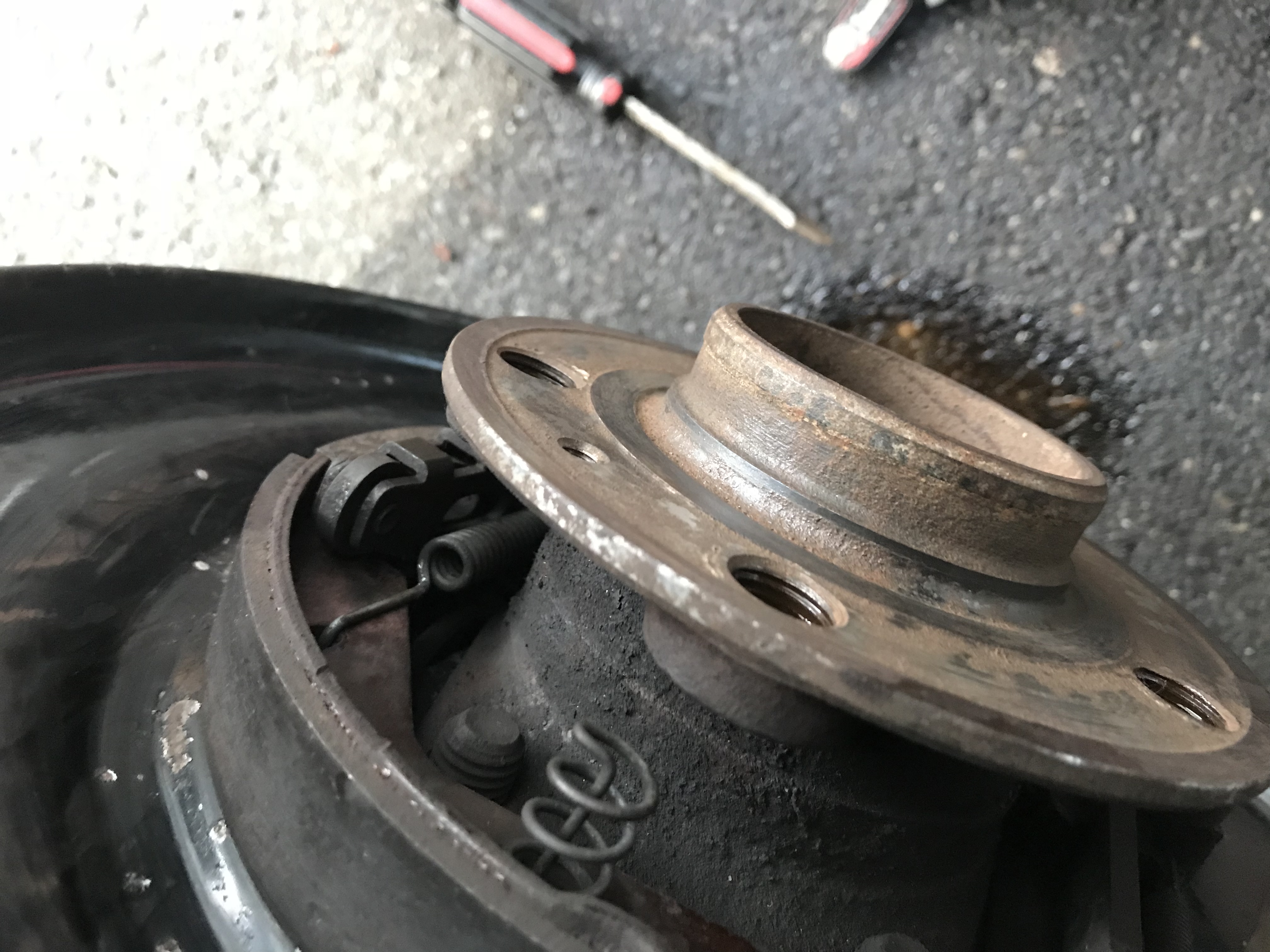

Looking at pictures of new wheel hubs and mine looks pretty worn... does this need replaced, or does it have some life in it still?
The new rotor seems not to sit as flush as the old ones did (looking at the lug holes there is a small gap on all five, where the old rotor was completely flush).
2002 S60 non-turbo, 114k
- Posts: 35307
- Has thanked: 1506 times
- Been thanked: 3818 times
Those hubs are fine. You might have a little rust lip which is holding up the rotor from sliding on completely. Wire brush them aggressively from the inside of the bolt holes to the snout, then "wet" a paper towel with grease and " lightly grease the outer face of the hub where the rotor touches it. Keep grease away from the brake surfaces , you just want a light film.
That M6 bolt that holds the rotor on can be just finger tight and a tiny tweak with a short wrench. The lug nuts will pull the rotor firmly onto the hub,not to worry.
Replacing those hubs is a big job too, they are integral with the wheel bearing so they'd run 100-125 a piece plus 2-3 hours
Those brake linings look good, I would run them.
