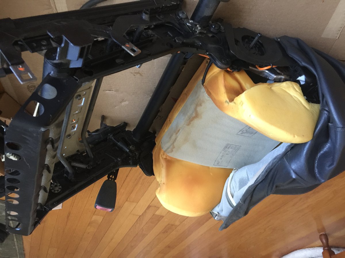

Collection of shots from a leather skin swap
182C370EEFD0.jpeg[/attachment]

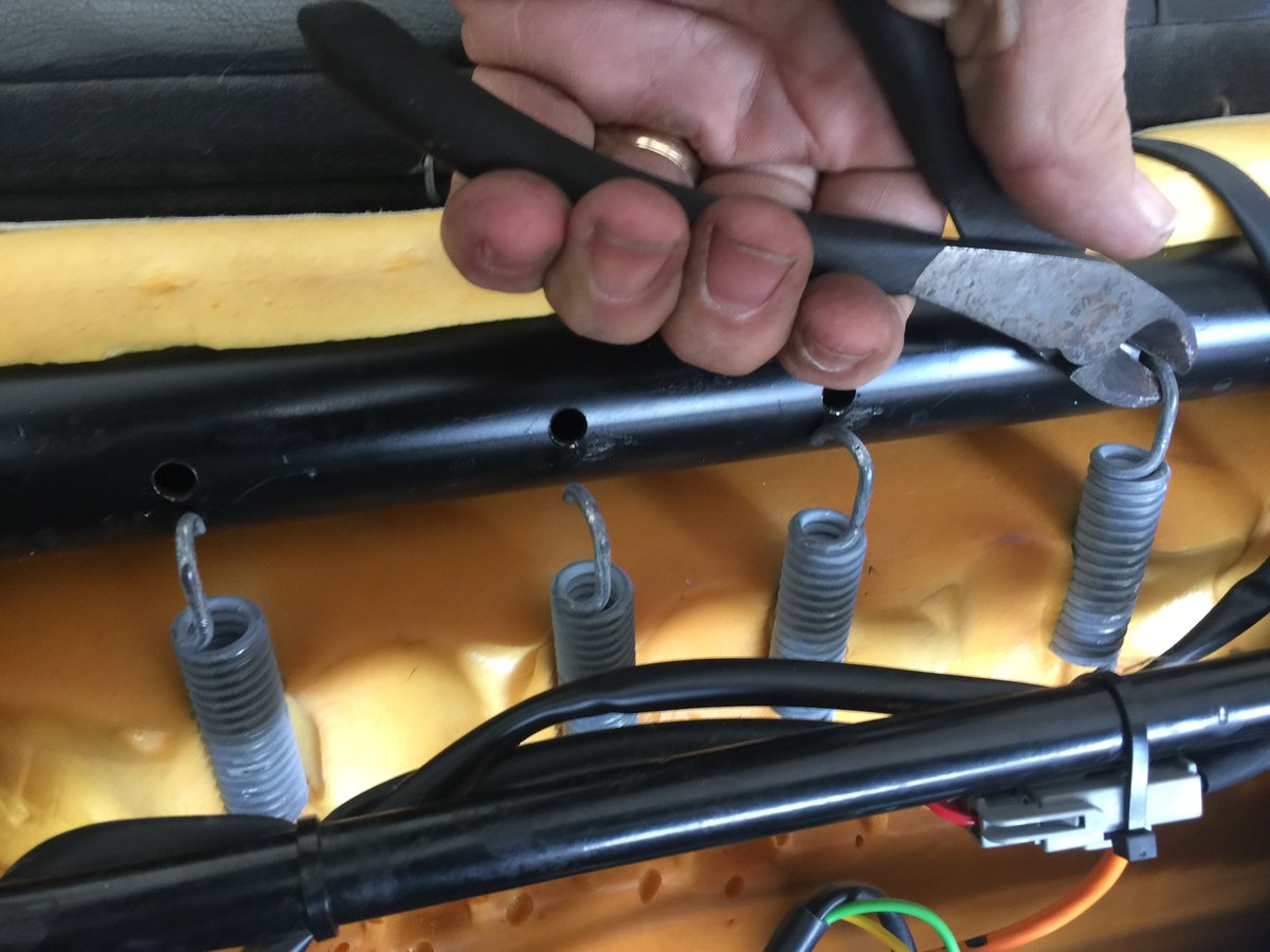

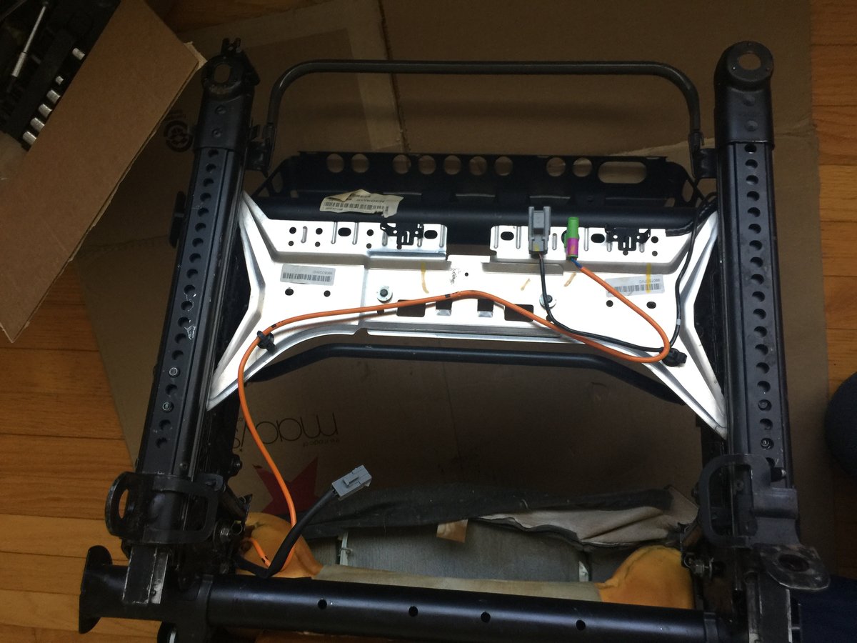

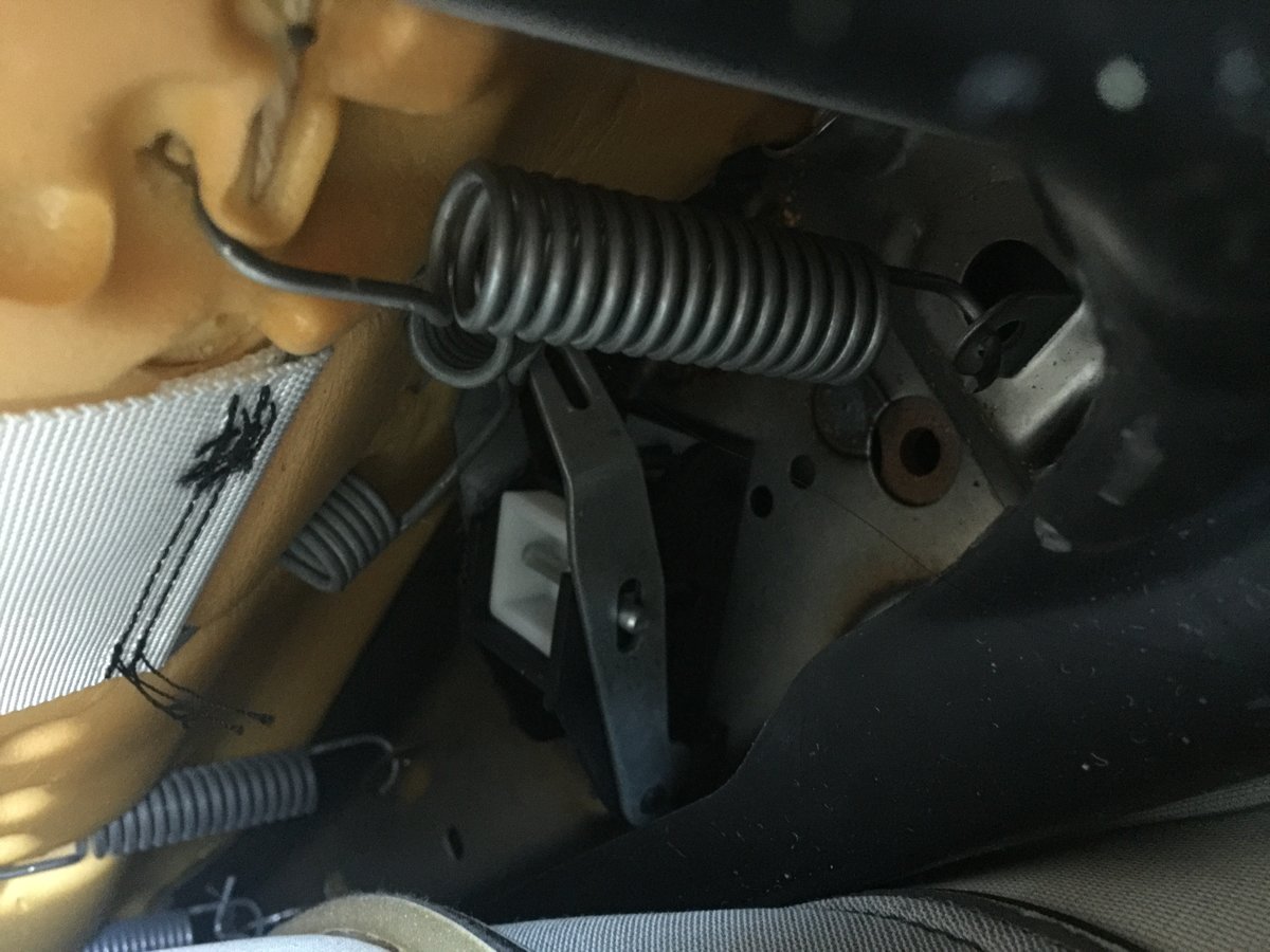

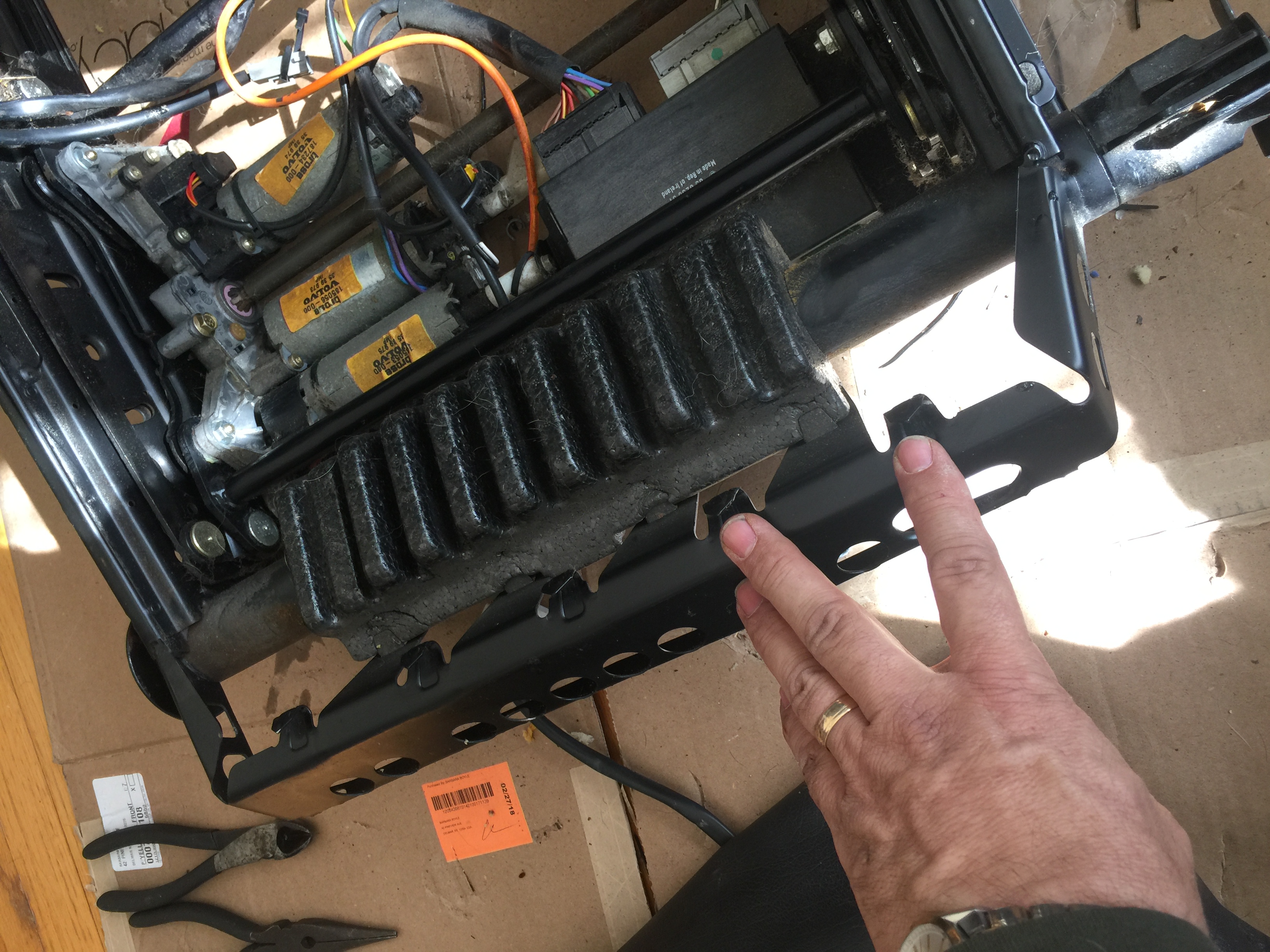

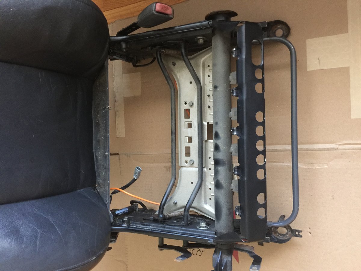

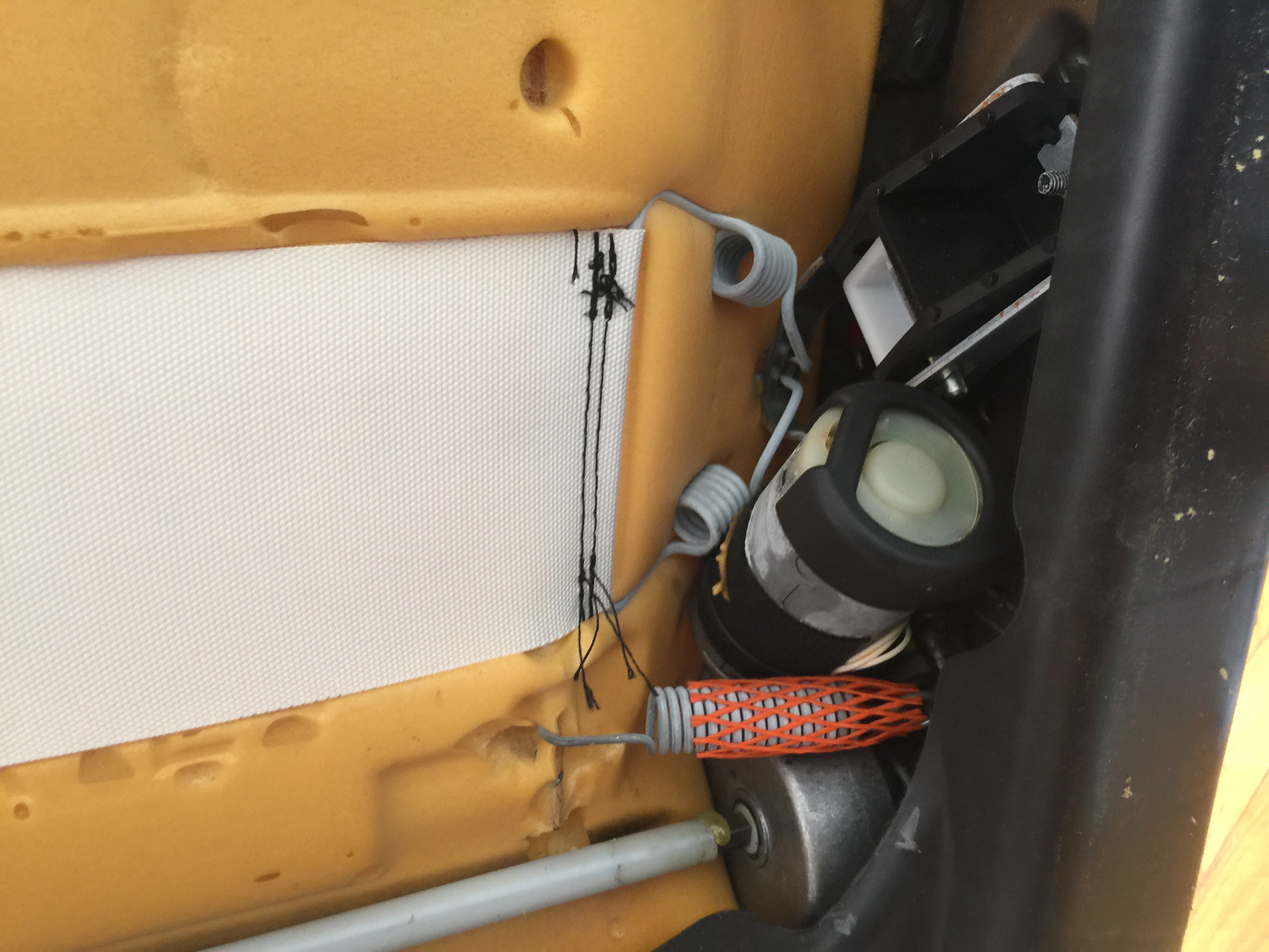

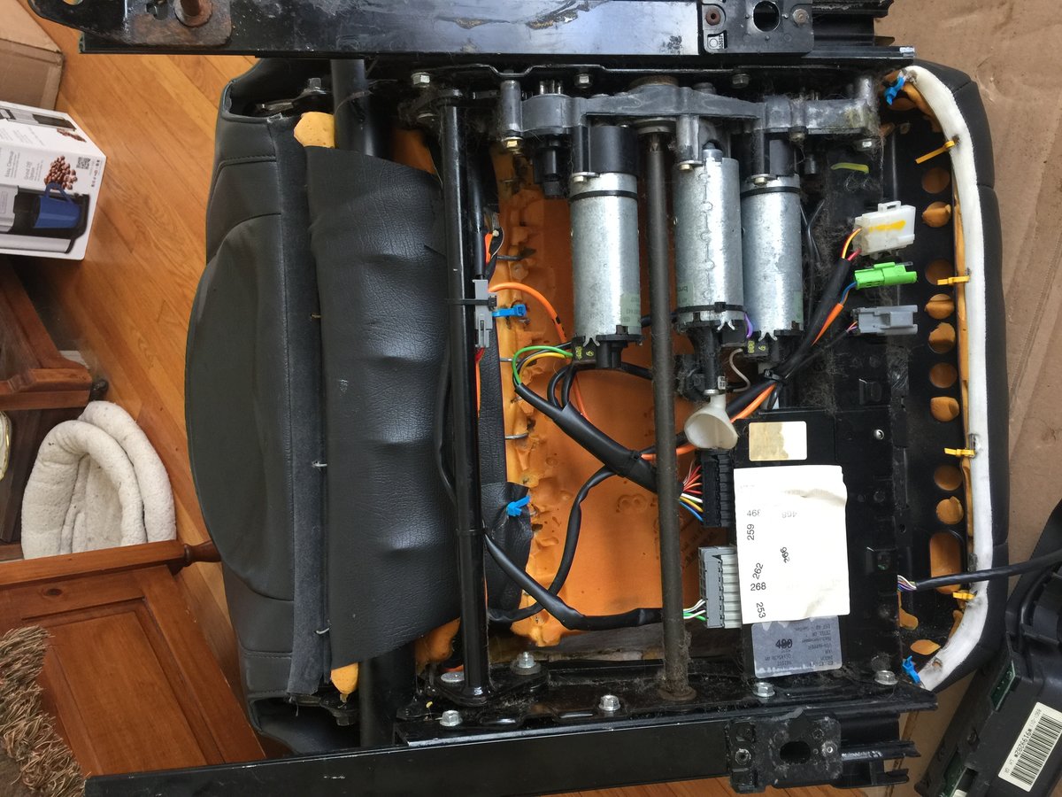

P80 seat dissection photos (1999 base and T5)

I pilled a seat from a 98 to fit to a 00, and found them slightly different in the way the cables fit. Can't remember the specifics, but you can modify a 98 lower cushion and heater to fit a 00.
Good photos there to abscate!

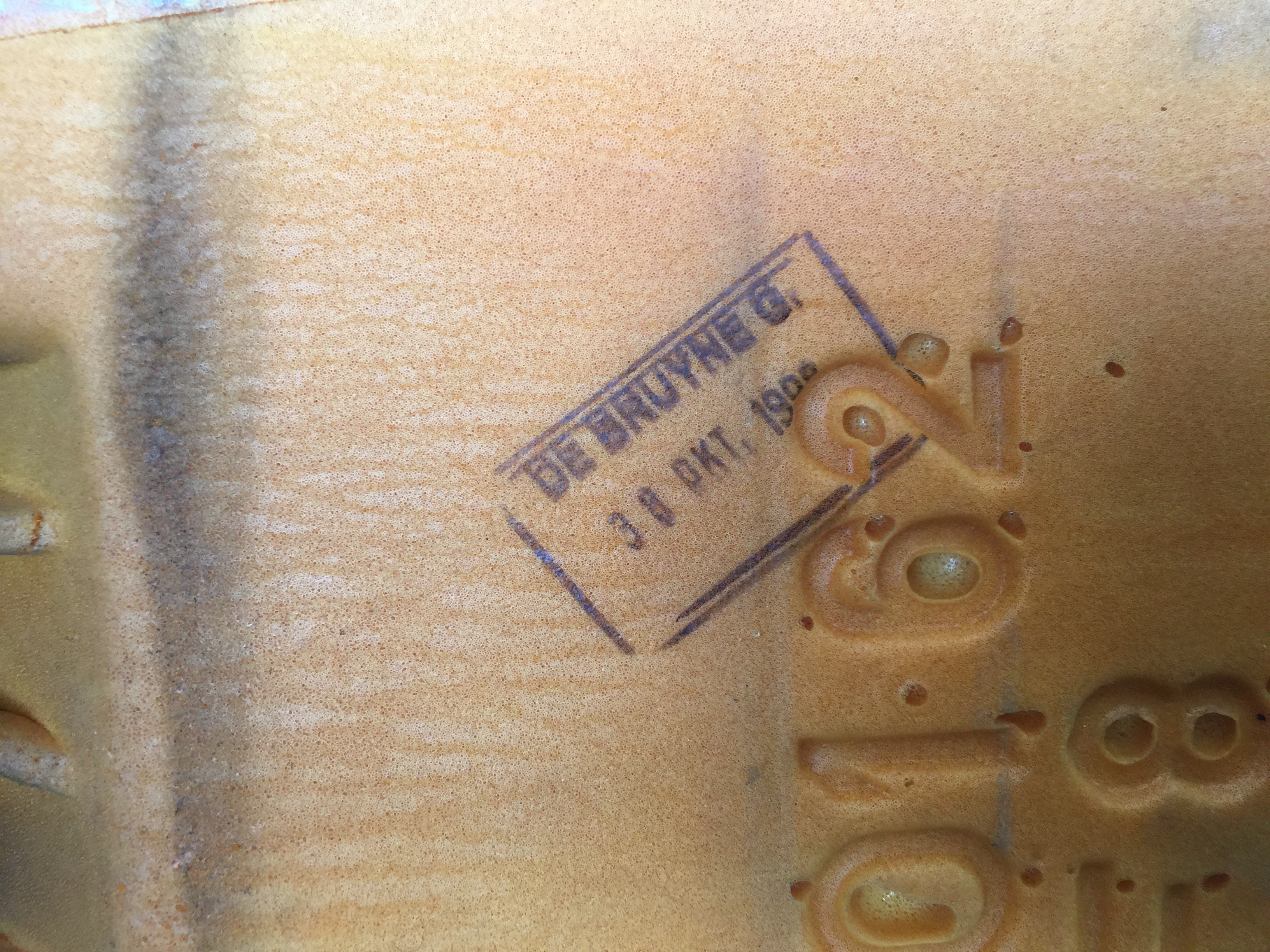

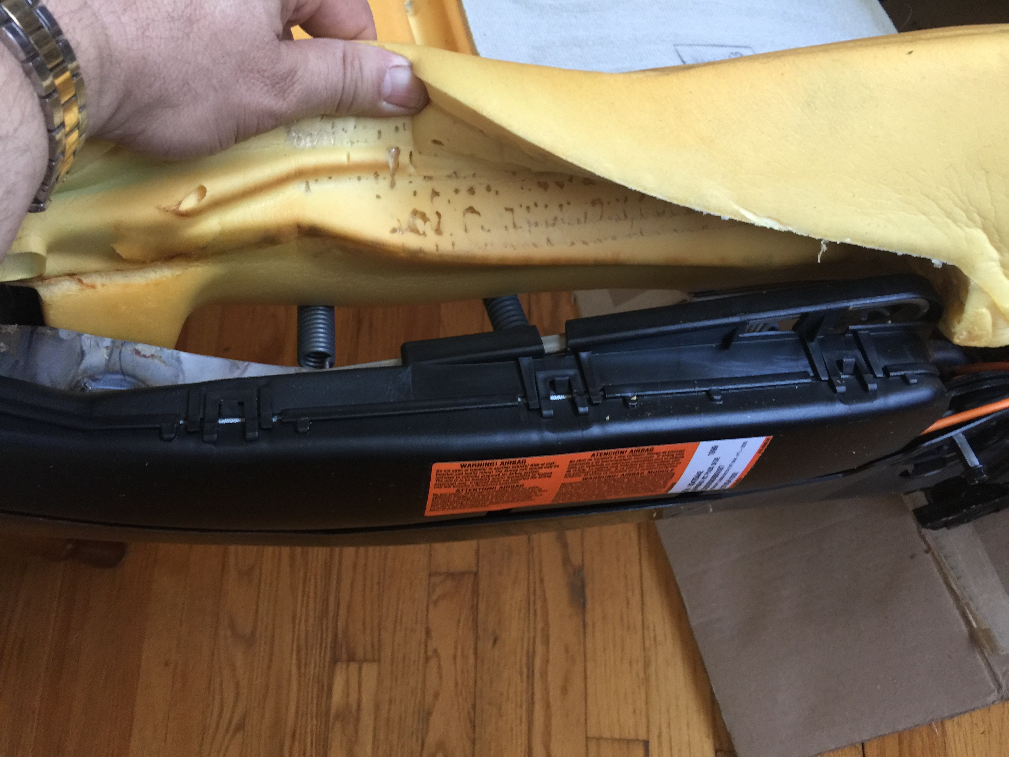

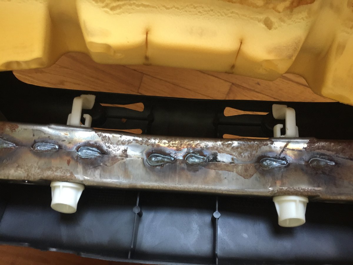

I found the seat base ( foam part) for the base, manual seat and the power seat had identical part numbers
The new base had few butt miles on it, or perhaps a petite passenger, as it feels a lot better than my old abused driver seat base.
Still I owe it to two people for keeping me comfy for two hundred thousand miles...picture to come
Thank you Mr/s Debruyne
