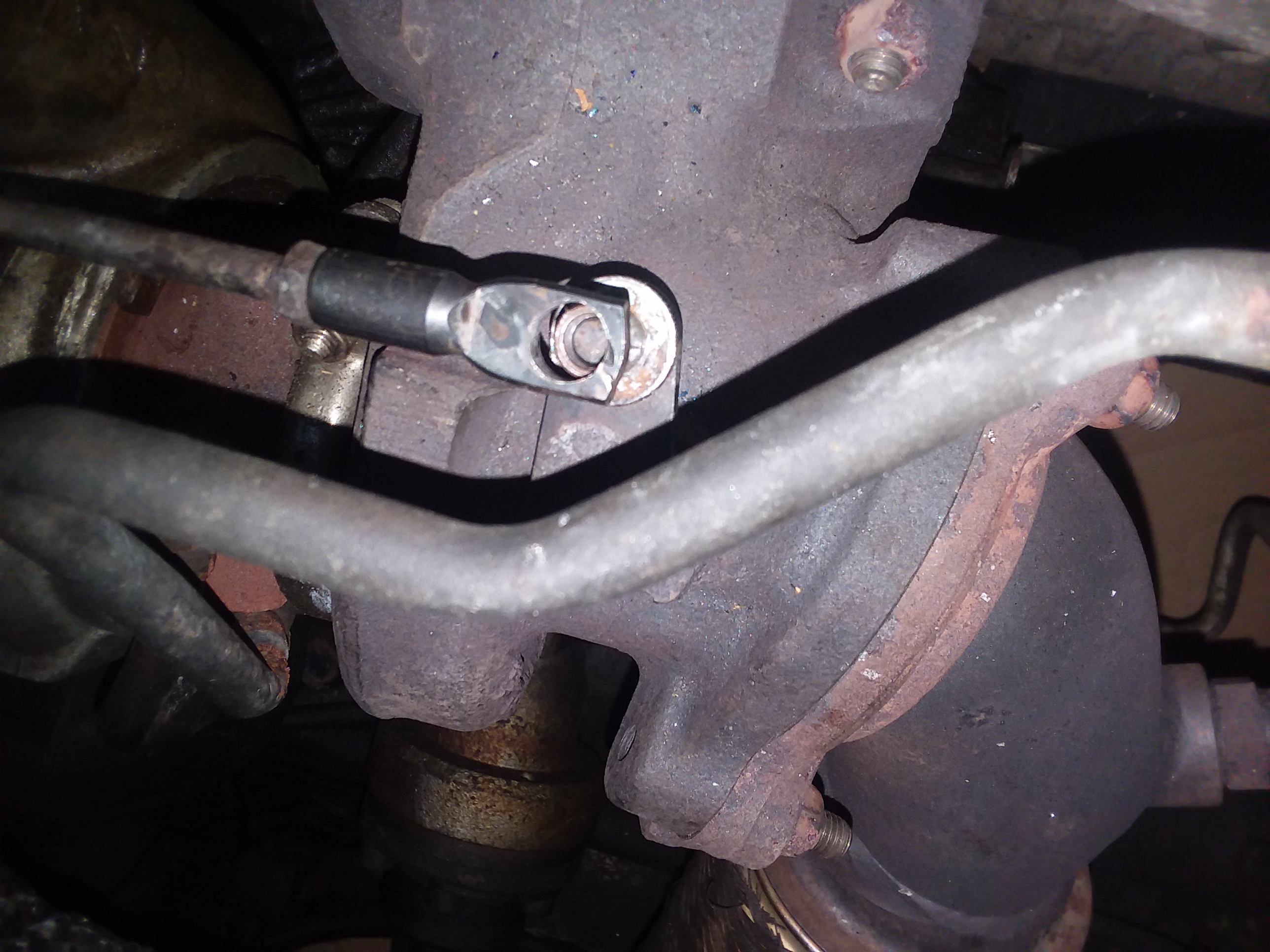

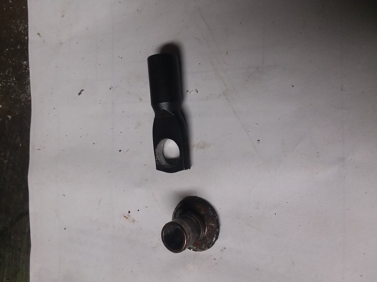

On mine the coupler wore a deep slot into the wastegate actuator pin. Fixed it by putting a sleeve over the wastegate actuator pin and drilling the hole in the coupler to fit the slightly larger sleeve.
If there's no pre-load on the coupling it will rattle and cause wear. There's a spring inside the vac actuator that keeps it under tension. The spring weakens in time and the arm is threaded at the coupler to accommodate wear.
Just grab the wastegate arm and see if you can wiggle it. If its under tension with engine off I'd look elsewhere. If the photo appears you can see the preload , set it so the rod has to be pulled out to fit over the pin.
I found the sleeve in my junk drawer, red loctited it onto the pin.
