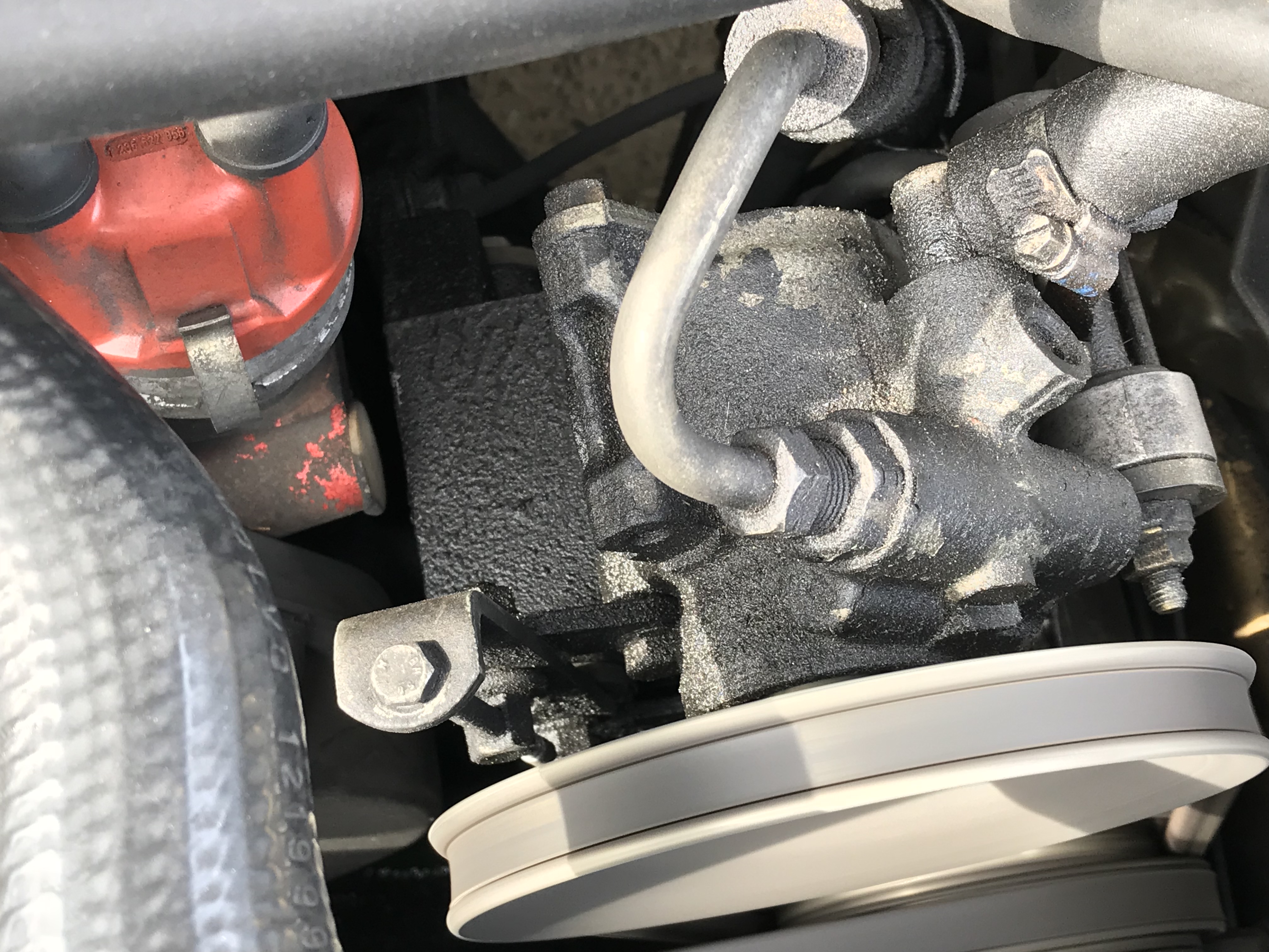

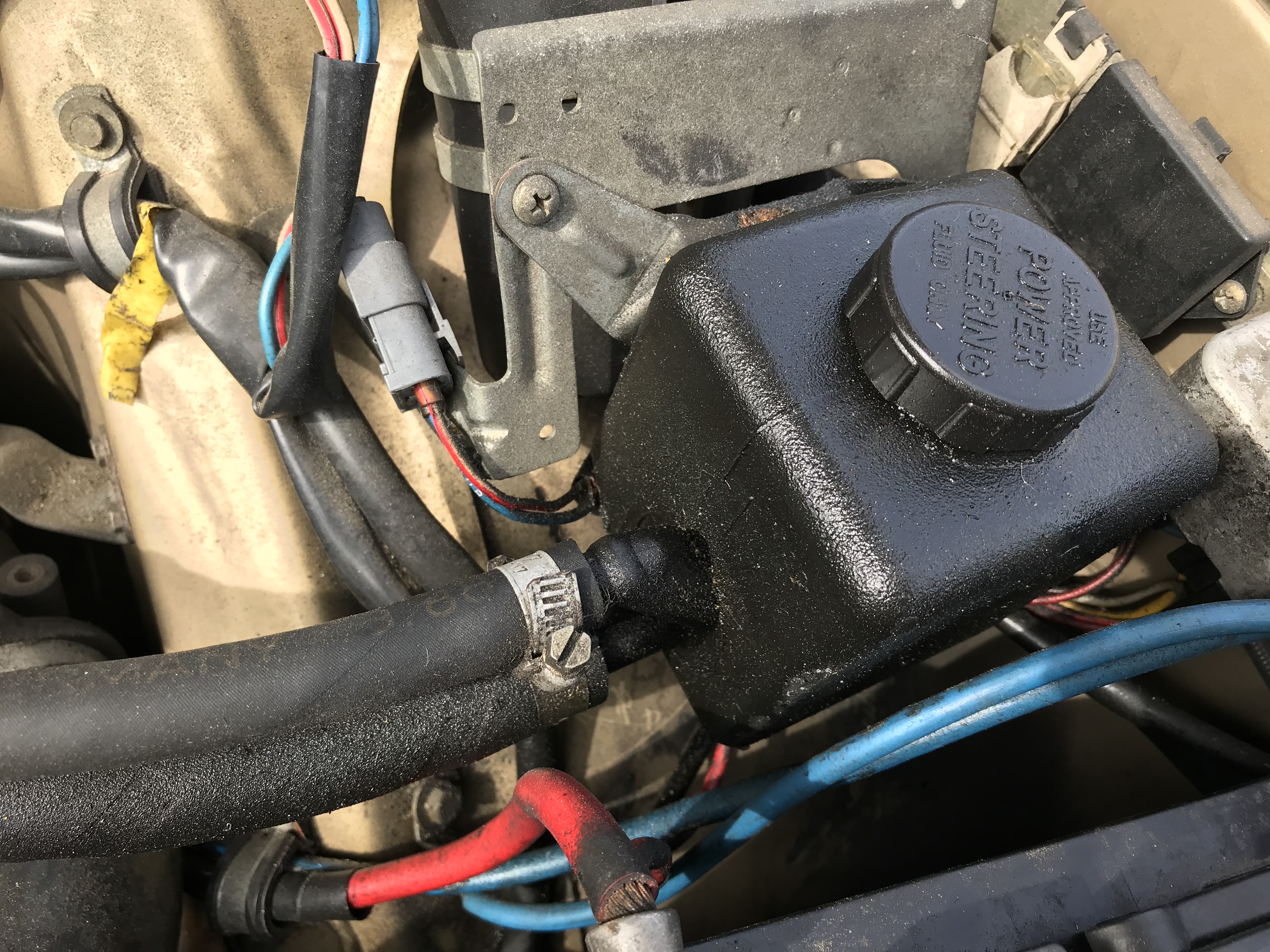

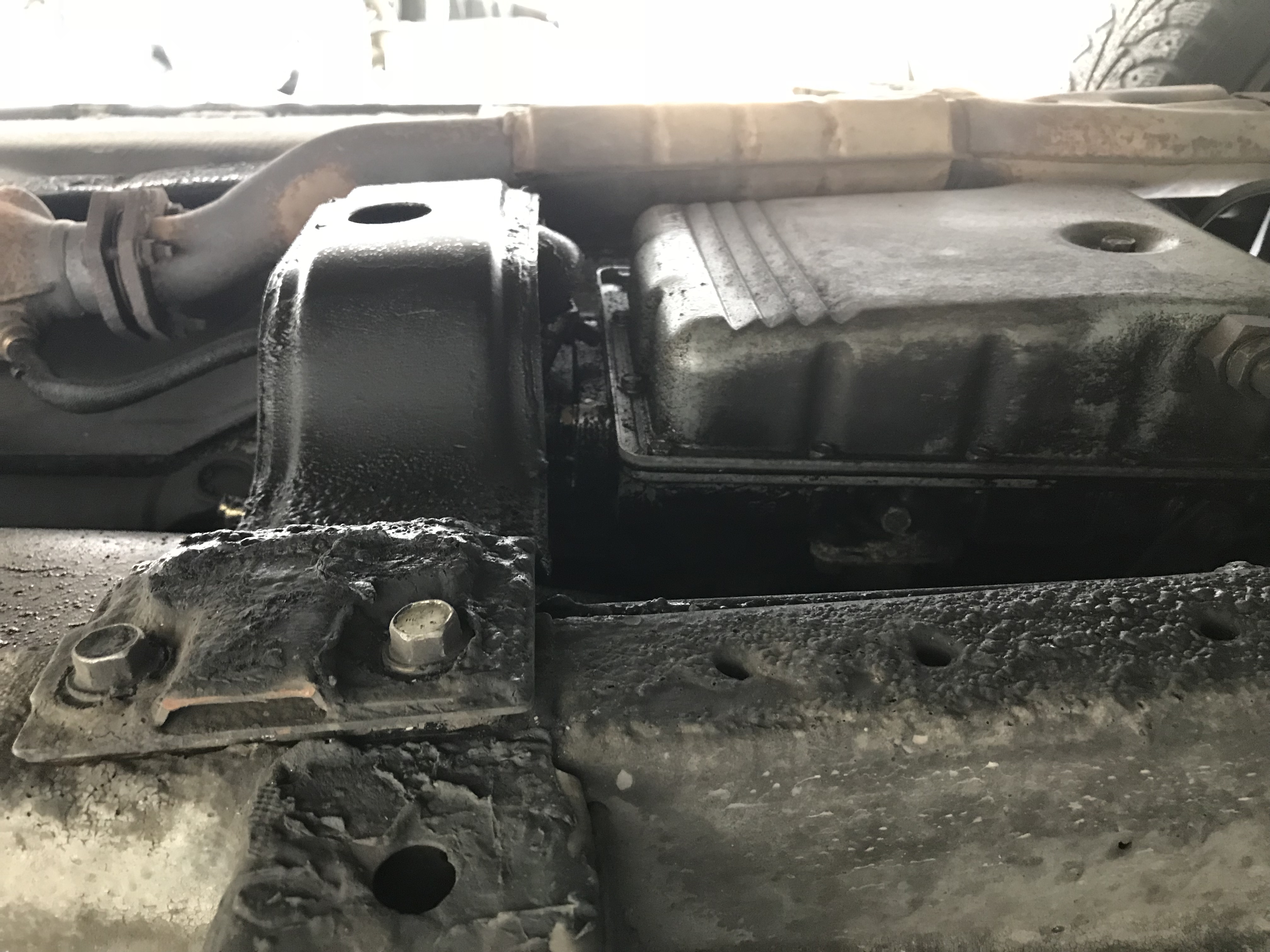

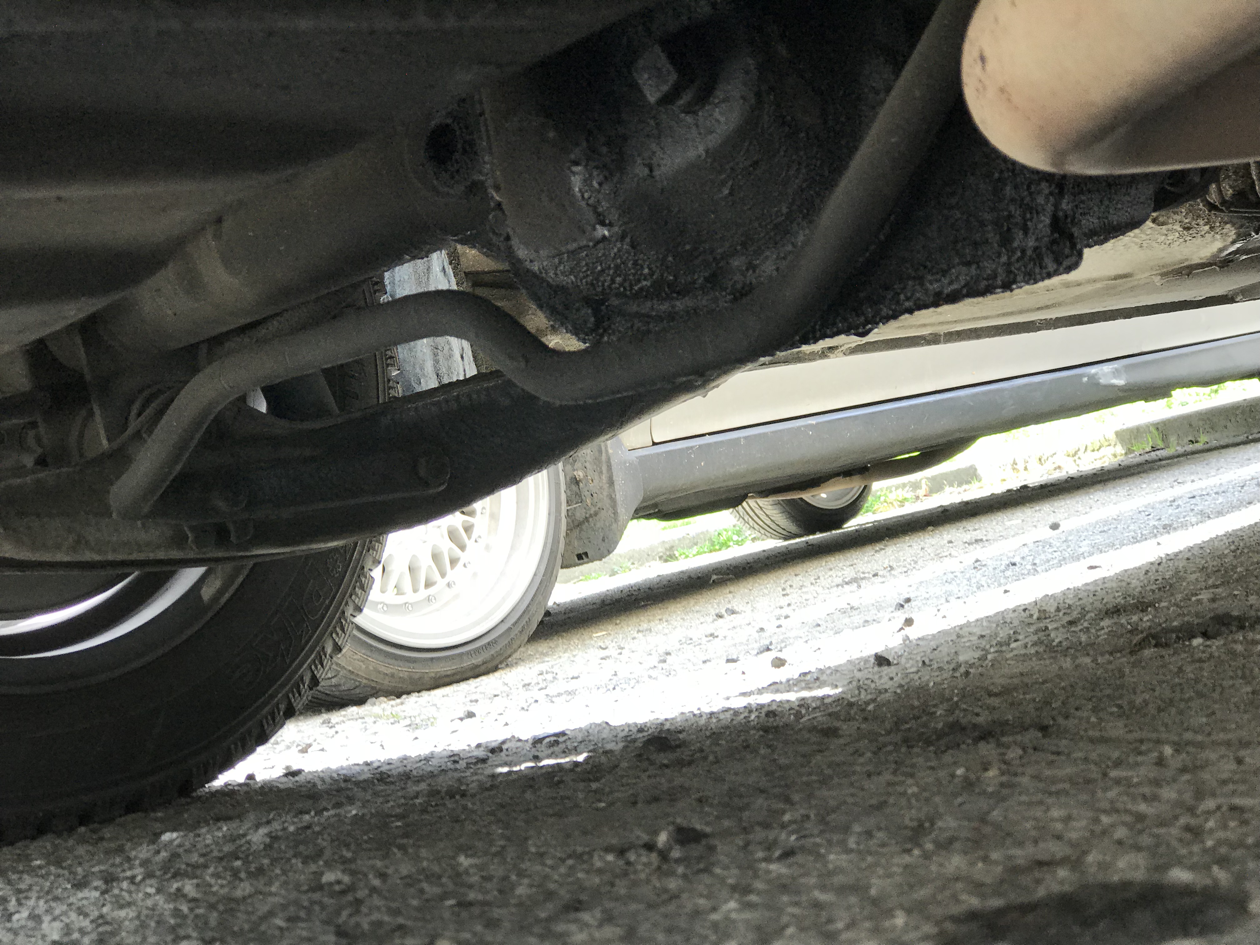

What I’m worried about is oil/fluid leaks. Has quite a bit of grime on the engine. I’m not afraid of replacing seals and such myself, just want to know what I’m getting into and how much work we’d be looking at.

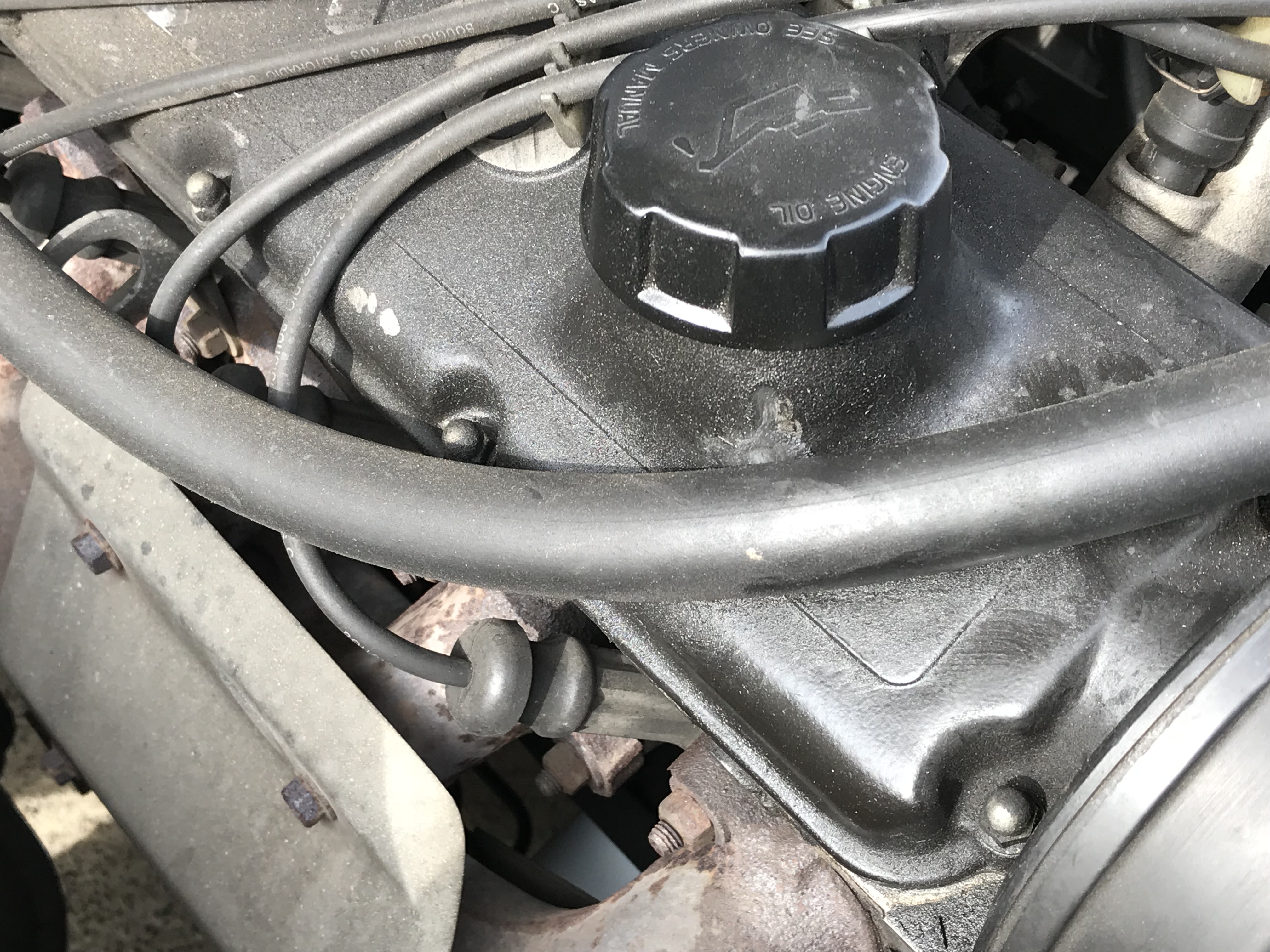

I did the rubber glove test, and it didn’t inflate per se, but did seem to be “spitting” some flecks of oil when I took the oil cap off with the engine running: does this mean bad or blocked PCV? How hard is that to fix?

Here are photos of the fluid leaks I was talking about — how bad is this?
(They’re asking $1500, for what it’s worth.)
Looking at 1989 240GL: how bad are these oil leaks?

Honestly from the pictures you've included, it looks pretty decent. Sure there are spots of oil under the hood, but it's hard to tell how long those have been there, it may just be seepage over a long amount of time.
The flecks of oil with the cap off are fairly regular, the camshaft is right under the cap, flinging oil like it's supposed to.
