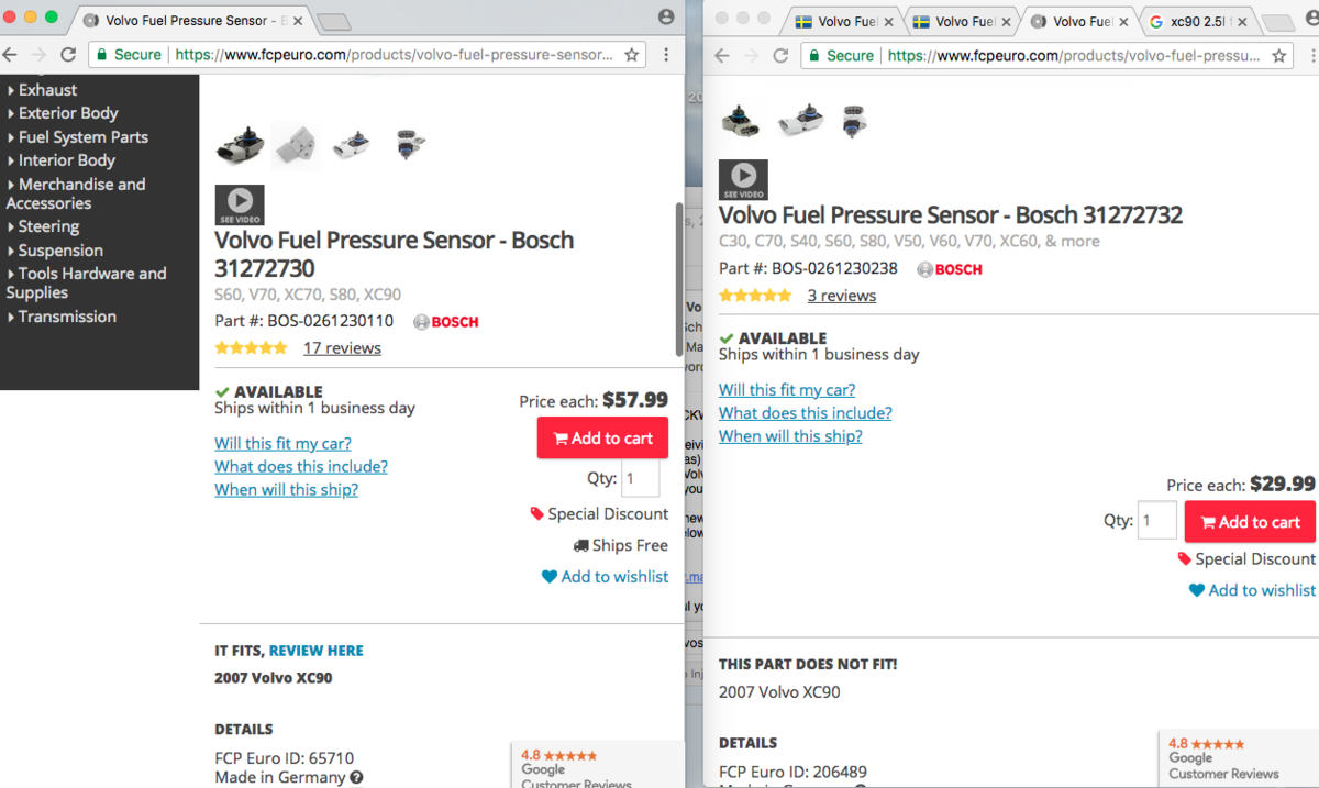

Finally got the car into Volvo on THURSDAY last week. Been wrestling with my BMW in the meantime (fuel pump, axles, brakes, vac leaks, oil leaks, etc. etc.). 3 MO baby had a trip to the ER this weekend as well. Turned out to be her trying to breath in a funny way, so she's all good.
At any rate, Volvo seemed to be dragging their feet especially since I told them about the ill discovery of the FUEL PUMP KINK. Got a call on Saturday saying they needed a Volvo specialist to look at it on Monday- WHOAAA, WHAT?

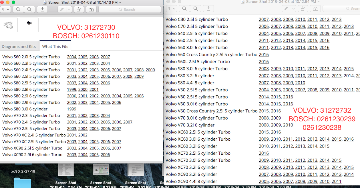

So, I FINALLY get calls/texts today asking about the fuel pressure sensor late this afternoon. I asked if they looked at the fuel pump, and I got a somber yes and that's it.
No mention of that being the issue. Then, the service rep asks what fuel pressure sensor was installed...I sent the info and he said he'd get back to me tomorrow. Majority of this was by text.
So it got me thinking that I have the wrong PN for the FPS. Bottom line is I ordered the FPS from FCPEURO who has the turbos and V8 (and I6) pressure sensor PN's swapped.
Most other sites and VIDA back this statement up. 31272732 = V8; 31272730 = turbo. Both should be seeing 480 kpa at idle. Maybe the software handles them differently. The V8 voltage specification is not in VIDA (that I can find), but the turbos (I just used a sample VIN) has the specification shown in the screenshot. I get a good signal and VIDA outputs 480 kpa. It should go haywire immediately if the signal scale is off due to a sensor that is calibrated differently. My symptoms were present before I swapped out the FPS, so it should be a non-starter.
I hope they don't use this to skate the FUEL PUMP KINK, but by the looks of it, that may happen.
I guess we'll see tomorrow!
Screenshot reference (FPS APPLICATIONS)
https://www.volvopartswebstore.com/prod ... gJzofD_BwE
- 5cyl turbo FPS spec
- Screen Shot 2018-04-03 at 9.39.00 PM.png (74.09 KiB) Viewed 3577 times

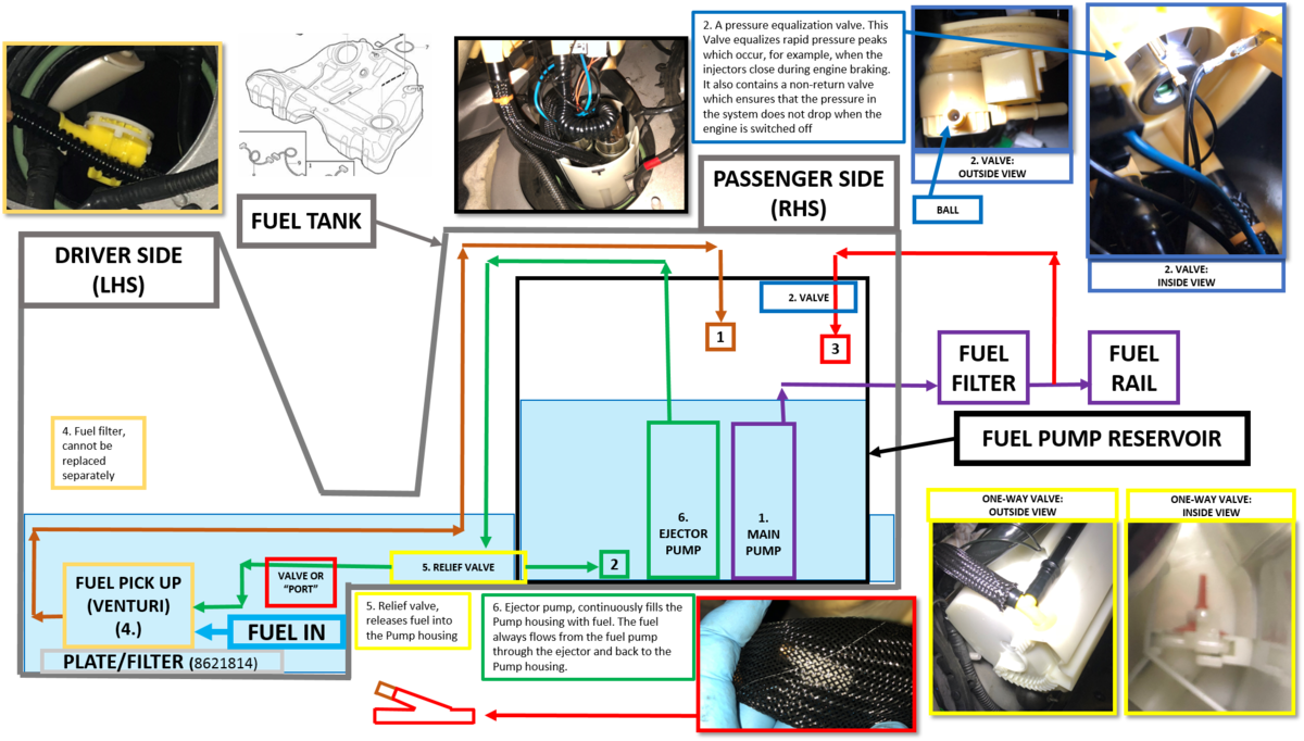

I guess this is just an FYI, because if any component fails in the fuel pump assembly, the whole unit has to be replaced (or diy fixed). I don't know what the piece is at the bottom of the schematic (in red). Descriptions are taken from VIDA.
I'd still like to see what the venturi looks like inside, so if I ever get my hands on a failed pump, I'll cut it in half to see how it works. I know it creates a dP where the ejector pump only has to overcome the last portion of pressure head to get it back to the reservoir ( similar to sucking on a tube to start a siphon).
Also, the fuel tank is plastic so magnets aren't going to be effective at "trapping" debris. At least on this model. I know some have metal but I don't know the applications at this point.

My theory is that once the reservoir empties and cannot be filled at a sufficient rate, the pump starts choking. I think some fuel was getting pulled in, but clearly not enough to keep up with demand. Also, shutting the car off may cause the pressures in the hoses to change allowing the left hand side head pressure to push some fuel over- theoretically. That's why shutting it off and starting would get some fuel back. My remedy of filling the car when it occurred obviously gets some fuel into the reservoir although the fill spout entry into the tank didn't look directly over the reservoir. I could be wrong on that though. If I have to replace the pump myself, I'll take a closer look.

FUEL PUMP HAS NOT BEEN REPLACED FROM WHAT I UNDERSTAND. They said they looked at it but are looking into the pressure sensor.
-PO isn't too savvy with cars and I don't think I can easily get more info. Each time I contacted them, they became more and more short with me. They said both trips to the shop were for the same reason. My guess is the original FP gave out at 150k miles.
-The primary issue may be different with the PO. They noted they had complete failure on the freeway and towed it in. I never had that. I towed it once because it was SoCal rush hour and I was miles from a gas station. Started fine getting on/off the tow truck.
-Not sure why the first installation went awry. They did punt to Volvo. It is more than obvious there is a major kink in the fuel delivery line on this second installation by Volvo... You saw those pictures of the kink? Holding the tube straight there is a significant bend/reduction in area. Moving it slightly in the direction of the kink results in almost a completely pinched hose due to the kink. I put it back to together as is to have Volvo fix their work. That is where it stands.
-I mentioned to Volvo to look at the SW
-I don't know why they are looking at electrical unless they replaced the pump/hose and are still having difficulty with fuel delivery. They will not be forthcoming if they replaced it yet...
"I'm not fully buying the sender side pickup hose kink as the root cause" If that delivery gets interrupted (kink), there's nothing to replenish the pump reservoir and the delivery pump will starve. Note that if the car is left running during a fuel delivery/pressure issue, the fuel pressure gets progressively worse up to the point it completely chokes and dies.
-Electrical checks carried out a month ago by (1) abscate and myself and (2) an independent shop showed no electrical issues. abscate and the indy said there has to be a blockage in the pump. I concur and found the kink. I was extremely deliberate in pulling the pump out so as not to cause any damage during my initial inspection of the pump. It pulled through with little to no resistance.
Notwithstanding, I do appreciate a look from a different point of view...If there is an ECM/CEM issue, it is exactly the same every time causing a fuel pressure issue and there are no other symptoms. That doesn't seem probable, but who knows with computers. The system seems to be operating as it should (see page 3 of this post). Fuel pressure drops (as shown by the FPS), ECM fuel pressure drops almost identically (uses the FPS to get this value), pump duty cycle is increased to increase fuel pressure. It then catches more fuel and pressure goes up but goes too high because the pump duty is too high. I imagine some air is getting in there at this point causing more havoc on pressure.

Timeline:
PO (previous owner-2nd owner, 120k to 150k, no records of anything done by 1st owner (0k -120k))-
-Unknown Indy Replaced FP in March '17 (report was of car dying on freeway)
-Took into Volvo June '17 (replaced FP and Fuel Filter). Indy's insurance paid for most of this. I don't know why they punted to Volvo to do a second replacement.
PO SUMMARY: Two fuel pumps and one fuel filter installed
ME (shockwave)-
-Bought in NOV '17 (not knowing about fuel issue)
-Cutting out started after a few days of driving
-Replaced Fuel Filter, Spark Plugs, Air Filter, Fuel Pressure Sensor
-Continued to have issue sporadically
-Replaced PEM
-Still had pressure issue/driveability
-Electrical diagnosis with abscate
-Took into Indy for inspection- They indicated everything looked good except for there's probably something in the tank causing the loss of pressure
-I opened up fuel tank to inspect pump- found kink
-Took into Volvo on Thursday hoping for a warranty replacement
-Who knows what they are doing at this point...I've been trying to let it play out...
