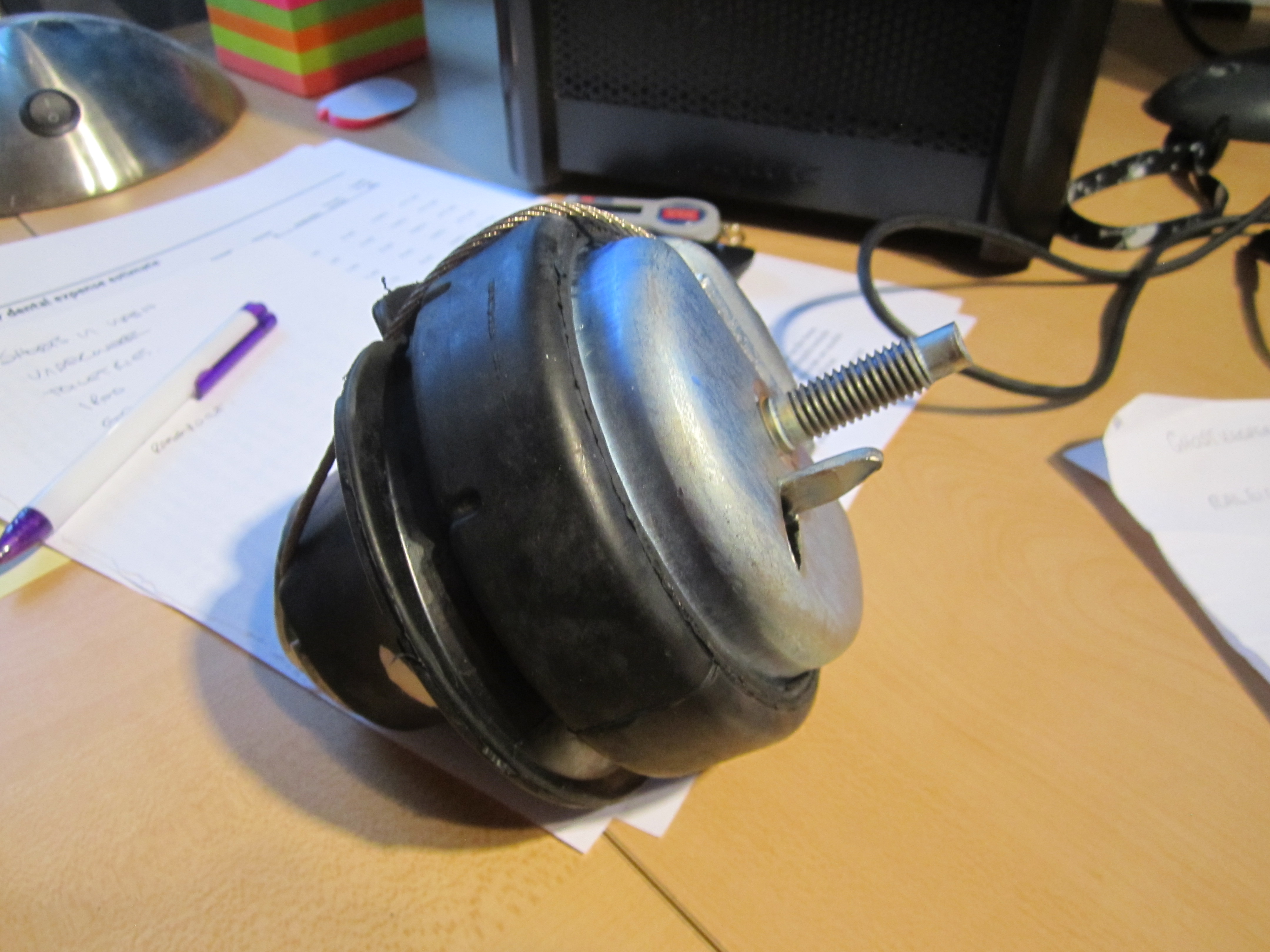

On the top plate that the top stud is attached to. As everyone should have, it just so happens I have a rear mount for a S60/V70R P2 sitting on my desk (doesn't everyone?) so attached below are pictures of the locating pin/tab. Release the lower nut to allow it to move and tilt/align the tab in the locating hole in the top mounting bracket.
Hope this helps.
Hope this helps.
