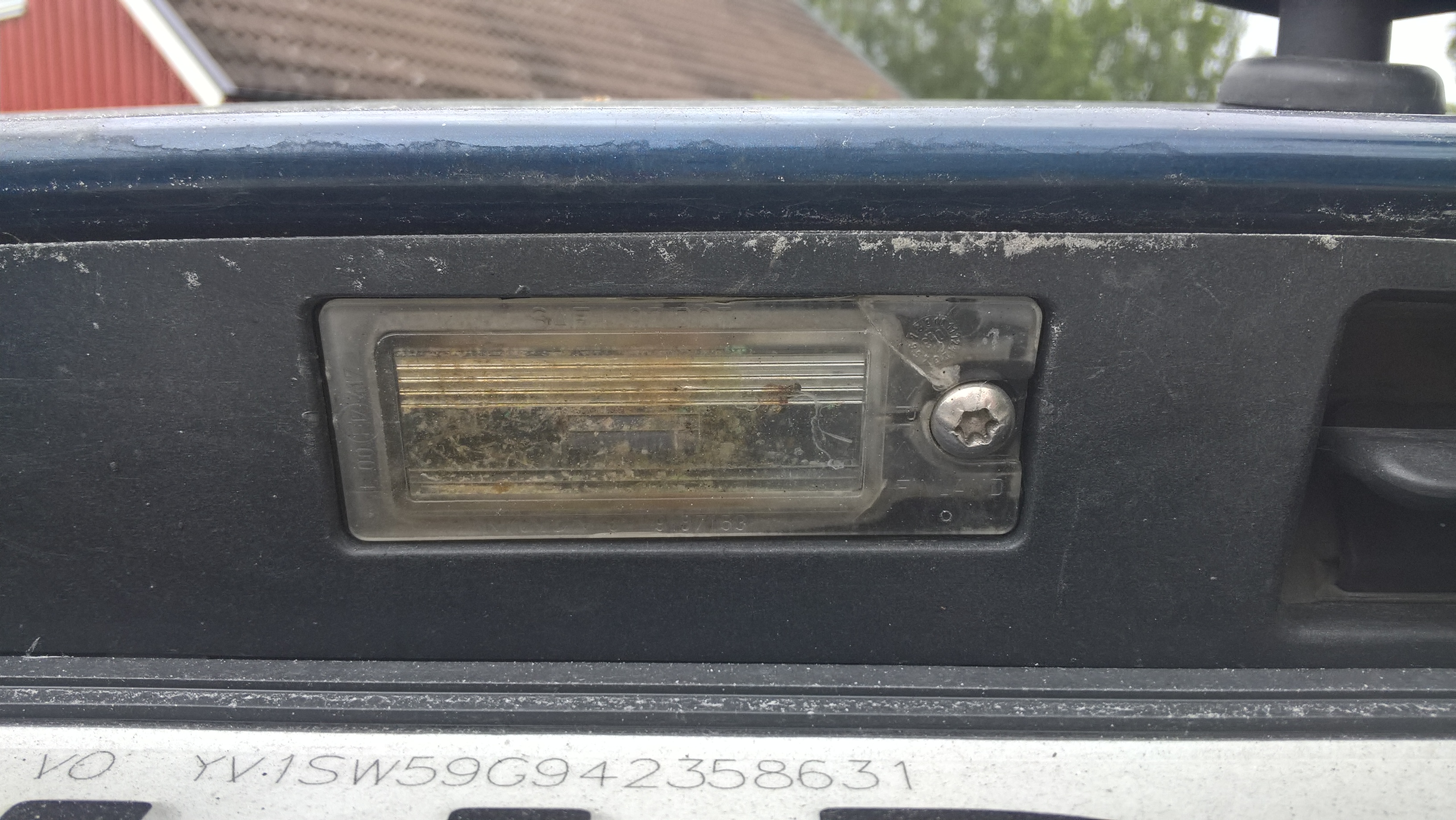

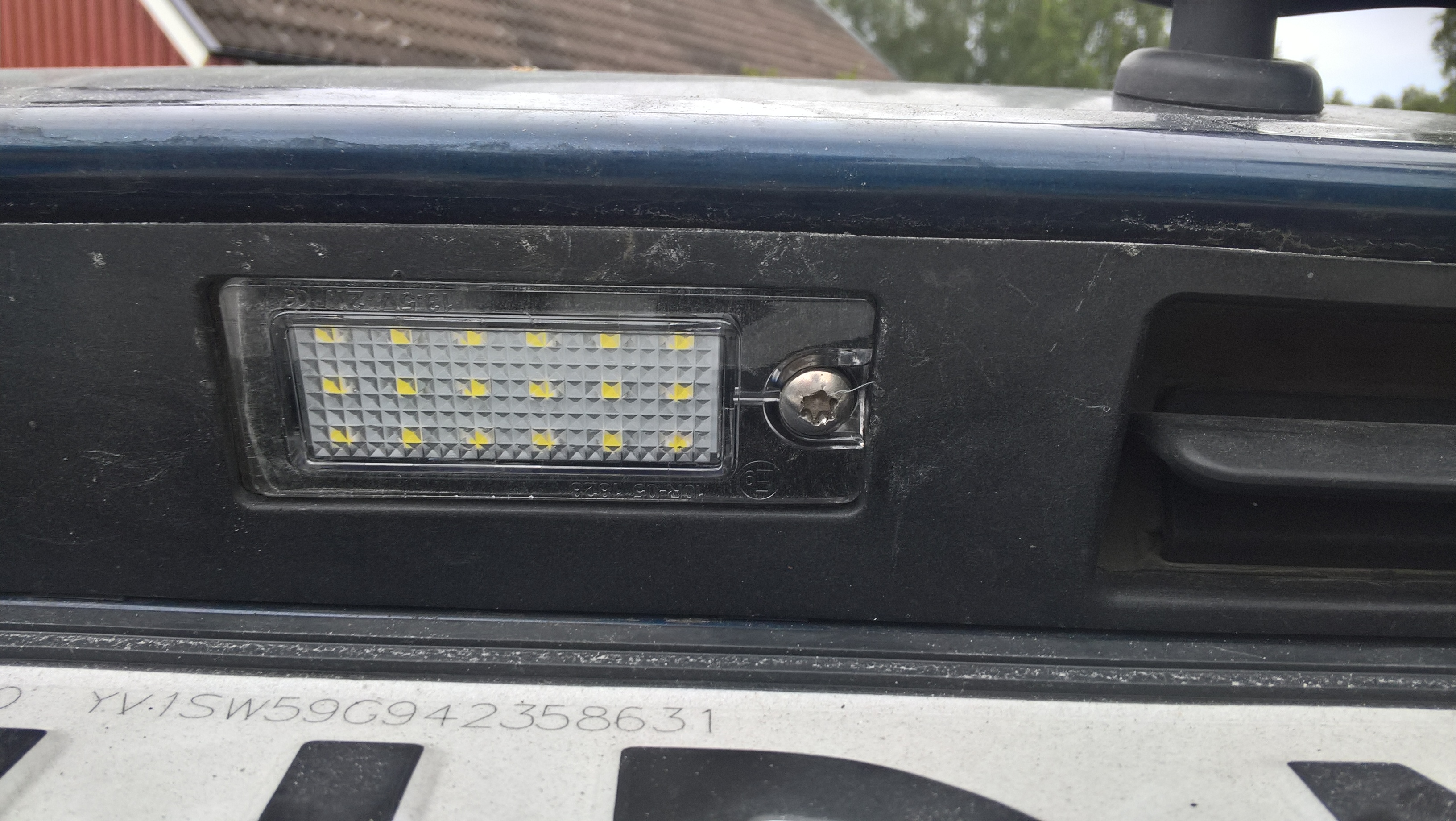

I replaced the entire units awith sealed LED modules. The old ones weren't in very good shape.. The LEDs still look like new after two years.Georgeandkira wrote: 23 Apr 2018, 06:07 Those rear license plate light sockets:
Need to be inspected frequently because the socket doesn't seat into the "fixture" securely. Moisture gets in.
All bulbs and sockets like dielectric grease. This lowers resistance, heat, warpage thus benefitting the whole system apparently.
Of paramount importance is the correct 5W5 (and so many other numbers) bulb NOT a 193 (3 watt) or 194 (4 watt) bulb. These older style bulbs have thinner bases and may light up when installed. They always shake loose and cause buzz and heat.

Like this? https://www.aliexpress.com/store/produc ... 42659.html
A T10 LED bulb may also fit in there
They seem to snap into the existing sockets, but wouldn't it be a problem if the actual sockets are already shorted/damaged ?

Exactly like that. It's actually got a seal around the edge that the original plastic lamp doesn't have as well.oragex wrote: 23 Apr 2018, 18:14 Like this? https://www.aliexpress.com/store/produc ... 42659.html

A T10 will also fit since but as you say if the fitting or glass is in poor condition that won't help much.
