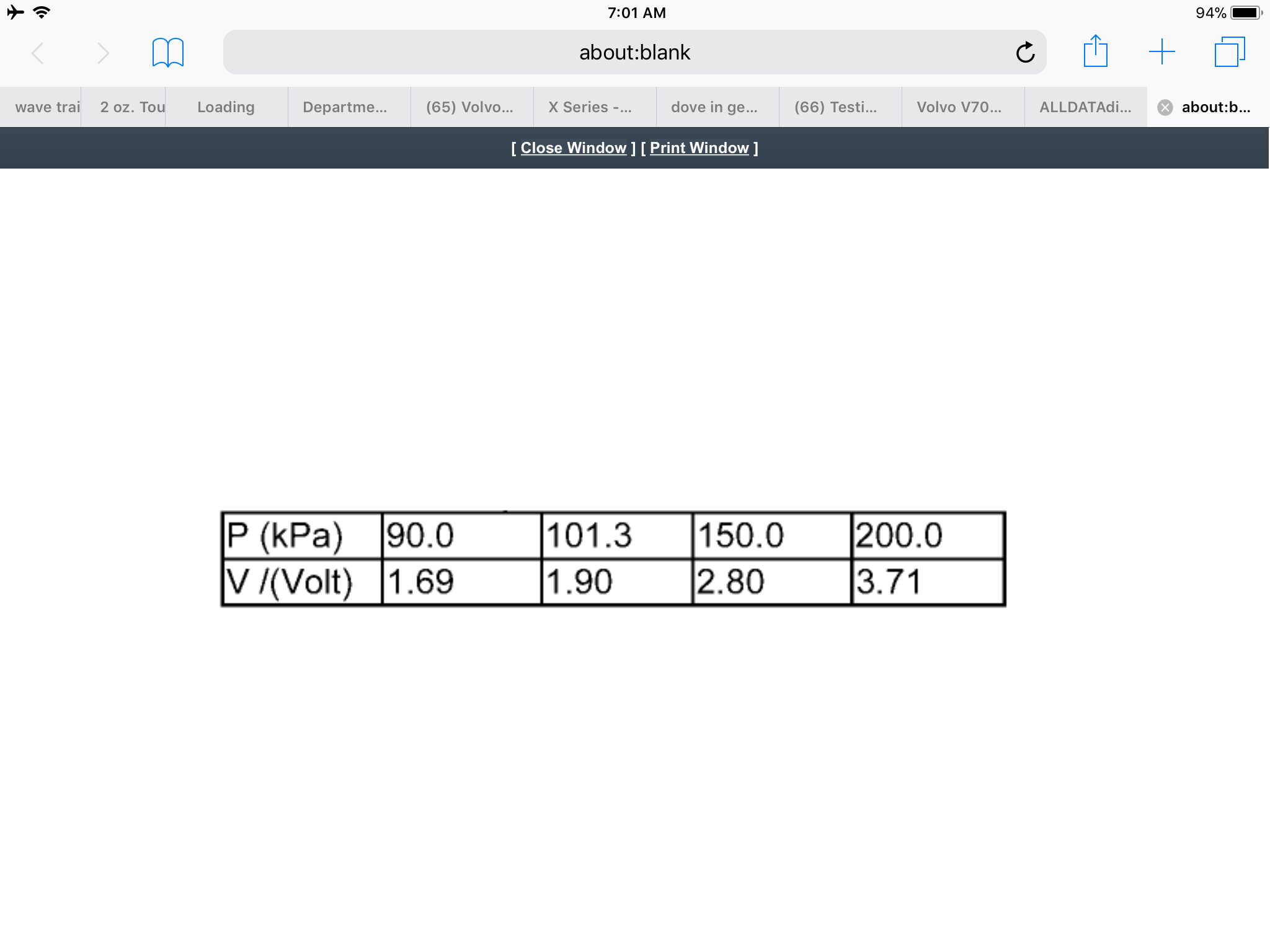

Hello, I have a 2007 Volvo S60 2.5T AWD sedan. I pulled codes P0238 & P0240, both related to the turbo boost sensor. Can I test the turbo boost sensor out of the car using an ohmmeter and if yes, what values should I expect to see from pin to pin?

I can’t find a part number for this sensor. My 1999 table is as follows
I seem to remember there were three pins on this , too , two are commons to the ECU bus and one is a resistance input.
I think I have a spare one and can try find tomorrow if it’s the same part number from late P80 s and P2s
