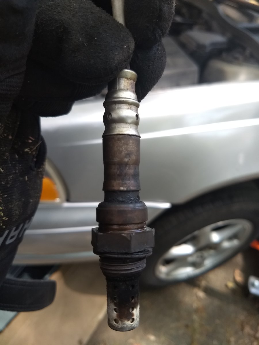

Swapped O2 sensors in the '00 V70. Denso sensors went in, replacing Volvo/Denso-branded ones.
I was surprised how far forward the rear sensor was located compared to the '98 V70, which I did a few weeks ago. Ended up using a nylon strap to pull on the ratchet handle, for greater leverage.
The rear sensor (below) was caked in black soot. The front one had some slight white residue.

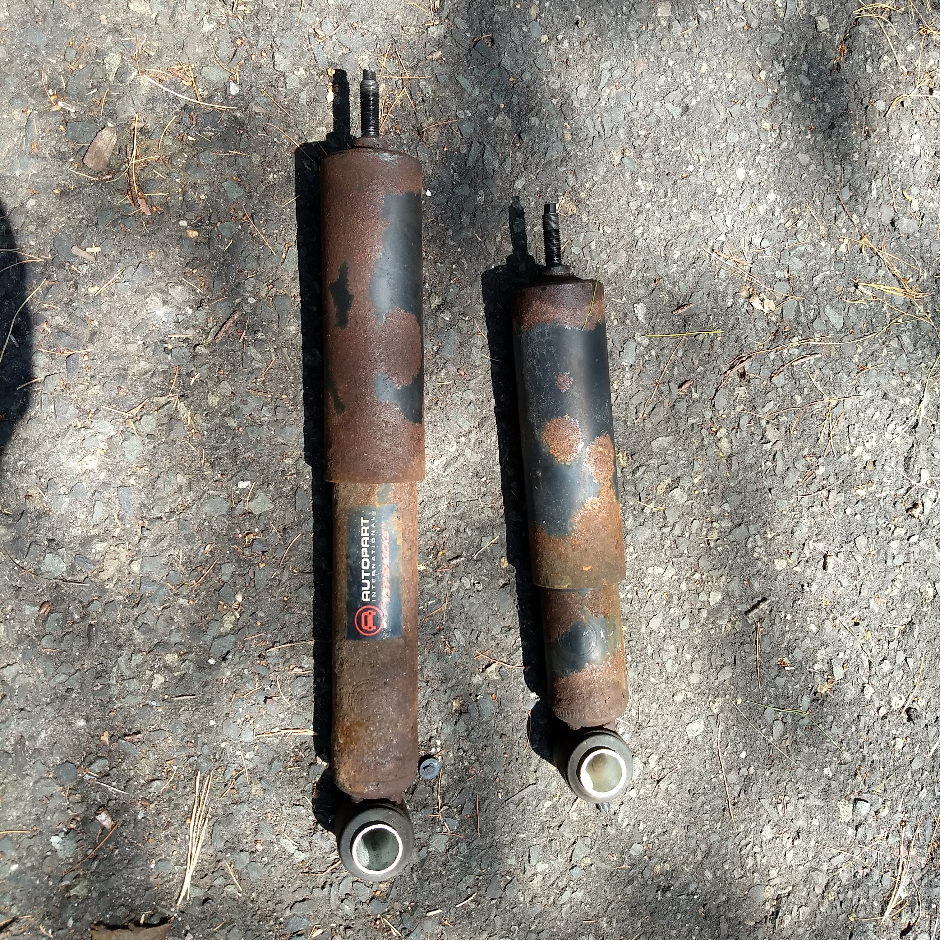

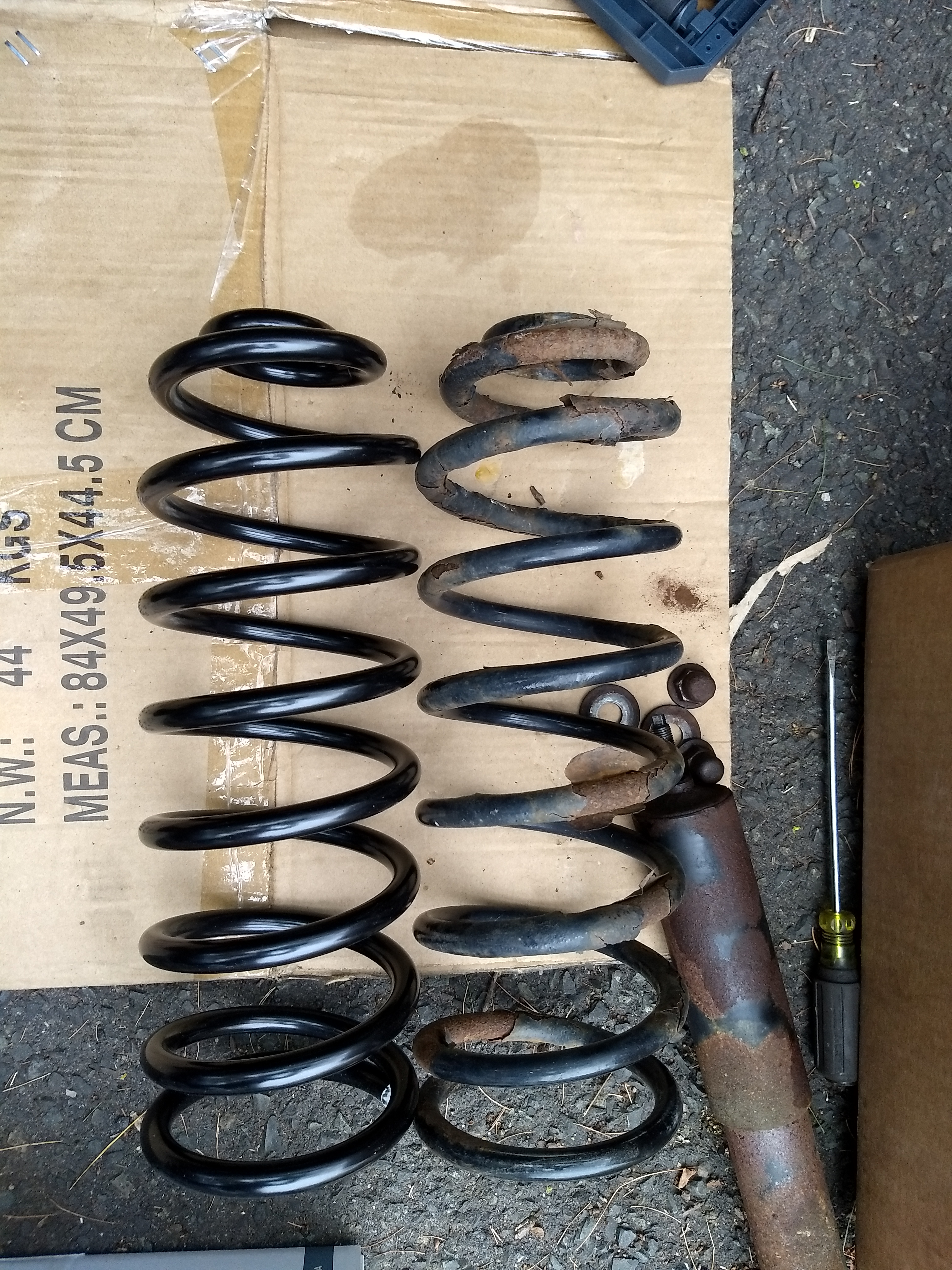

I replaced the coil springs in my 2000 V70 in order to address the sagging rear end. Original green Volvo springs came out. Heavy-duty Lesjoforrs springs went in. I also swapped out the aftermarket shocks that were in there with a Sachs pair I found on sale.
The car feels a bit like a pickup truck in how stiff it drives. Hoping the springs break in all right.

I made that mistake once a long time ago ...heavy duty springs on a passenger car where I didn't actually need them. Someday in the future you may look back and regret the decision. Especially if you generally drive alone without much cargo.brunocerous wrote: 12 May 2018, 12:19 I replaced the coil springs in my 2000 V70 in order to address the sagging rear end. Original green Volvo springs came out. Heavy-duty Lesjoforrs springs went in. I also swapped out the aftermarket shocks that were in there with a Sachs pair I found on sale.
