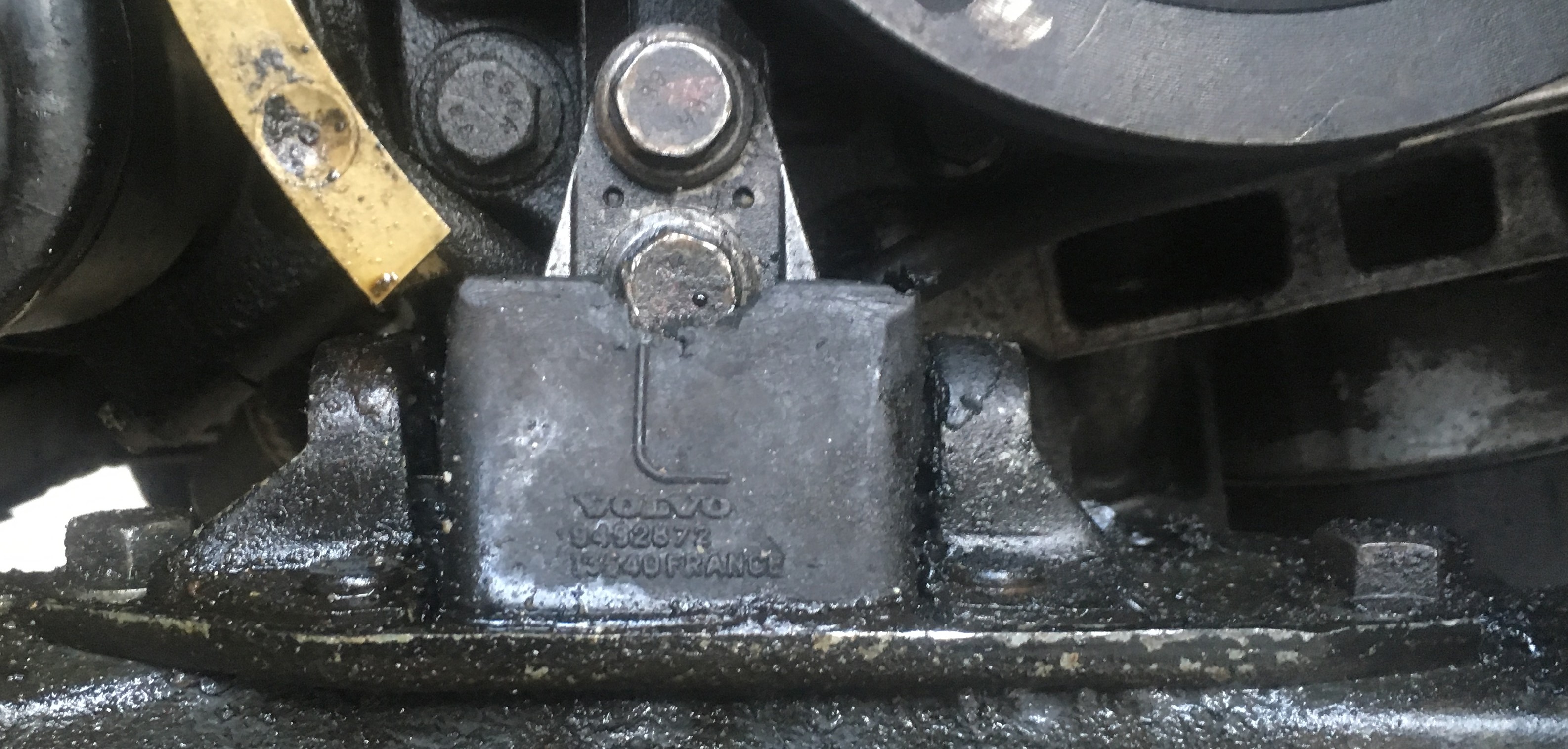

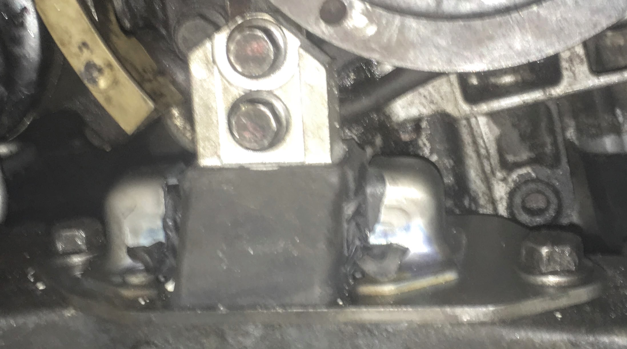

Update: I fixed it! The culprit? One hideously-busted right engine mount:
Old engine mount. BOTH screws should be above the rubber mount if the mount is in good shape.
New mount installed (notice how much higher the bottom screw is compared to the original mount).
Old Mount (cleaned up and repositioned) vs New Mount. Apart from being in new condition, the new one also appears to have a beefier design.
Engine sound and vibration are now extremely minimal. Everything is extremely smooth.
I'm thinking I should have fixed this a lot sooner. Who knows how many side effects could be traced back to the engine riding down an inch too low on the passenger side, or the vibration/movement caused by the engine essentially touching the subframe.
Here's a link to a video showing the difference in motion between the old and new mounts: https://photos.app.goo.gl/UtM1RFSQrJZCXx4EA

Thats a nasty, nasty engine mount. Yeah, the engine sitting on the pads is not good and lots of things can go wrong. Check all those hard lines for rub points and chafe damage.

Have to wonder if that collapsed lower mount damaged the upper mount.
