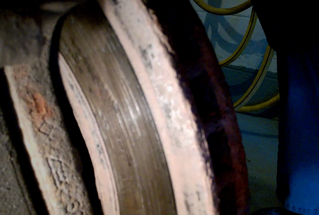

A leaking brake booster will also reduce significantly the braking power. Mine was leaking (hissing) near the pedals and the brake rotors were wearing only over a reduced area - see pic
