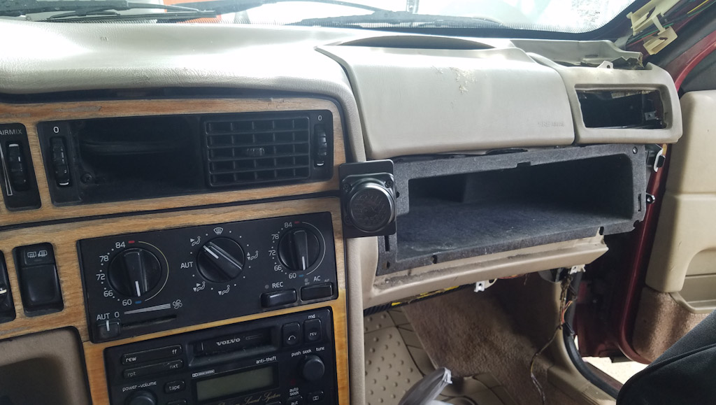

FInally got around to tightening the rearview mirror screws and installed my proclip phone mount. Ignore the tornado damaged dashboard.
