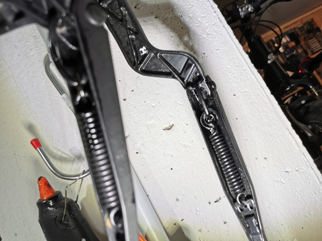

regarding wiper arms... I have tried a lot over the years.
- the fix in the first post (grind the stops), it helps, and is needed, but I still had issues
- s70 wipers. No, they do NOT fit, at least for me. I even tried grinding down the spot that rubs, it still rubs on the hood.
- new wipers and new wiper assembly (thought the old one might be damaged). this did help for a few months, but it then got worse than ever. The springs in the arms already were getting weaker again.
So I finally decided to take it to next level level
My latest version requires both 850 and s70 wiper arms for parts.
- remove the springs, and replace with the fat spring of an s/v70 wiper (drill out a hole to connect the spring )
- used a washer to connect the s70 spring to the s70 hook, its not designed for this length.
I have had this version in use for last year, and the shaft (very soft metal, not oem volvo part) broke out of the wiper (too much tension?). I have replaced it with a cut off nail and hope this will last better.
But I can say that these do not lift and actually the motor now has to do some work to drag them over the windscreen. As long as the shaft doesn't brake these are really good.

So, while they were great for a while (my last post) the aluminium base arms are bending slowly over time. My bad I didn't really believe it I guess. They look sturdy, but the passenger side was actually hitting the hood. Diver side is crazy bent.
I bent them back, but I don't see how I can prevent that... bolt them to a steel bracket? Someone should cast these arms out of steel and sell them.
