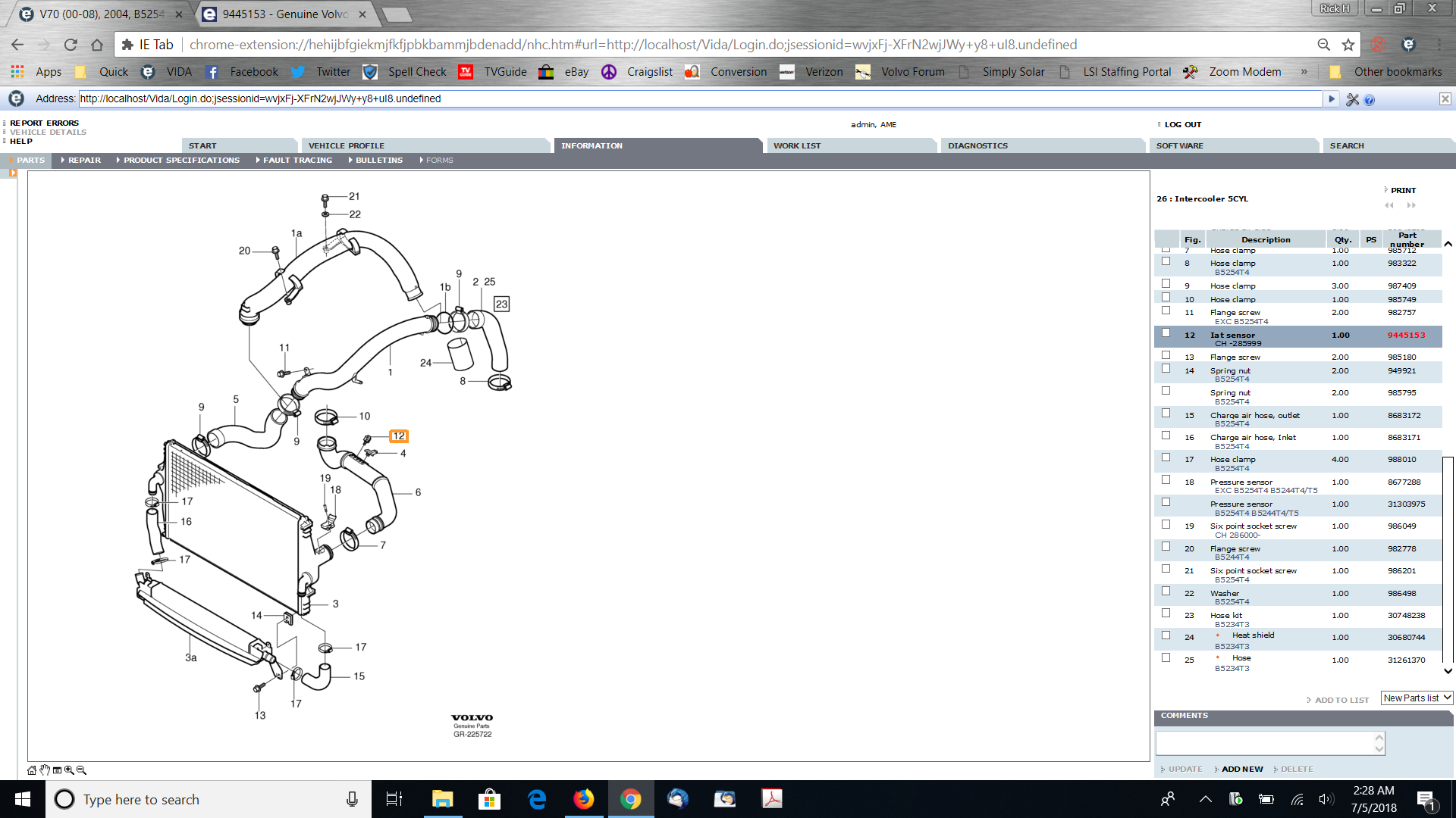

#12 ITA (Inlet Air Temperature) sensor. Volvo part number: 9445153.

Thank you RickHaleParker for the diagram. I had a quick look and verified that my car DOES NOT have item #12 or #4. That section of duct does not have any sensors of any type. It does have a sensor at item #18, though mine is a combined Pressure/Temperature Sensor (Bosch 0261230090), which I have replaced without any change to the IAT reading.

In the diagram above the BPS/MAP is #18. If you look at the part list there is a different BPS for the B5254T4.
Volvo part number 31303975 does cross reference to Bosch 0261230090 (B5254T4).
Volvo part number 8677288 cross references to Bosch 31355464 (B5254T2).
