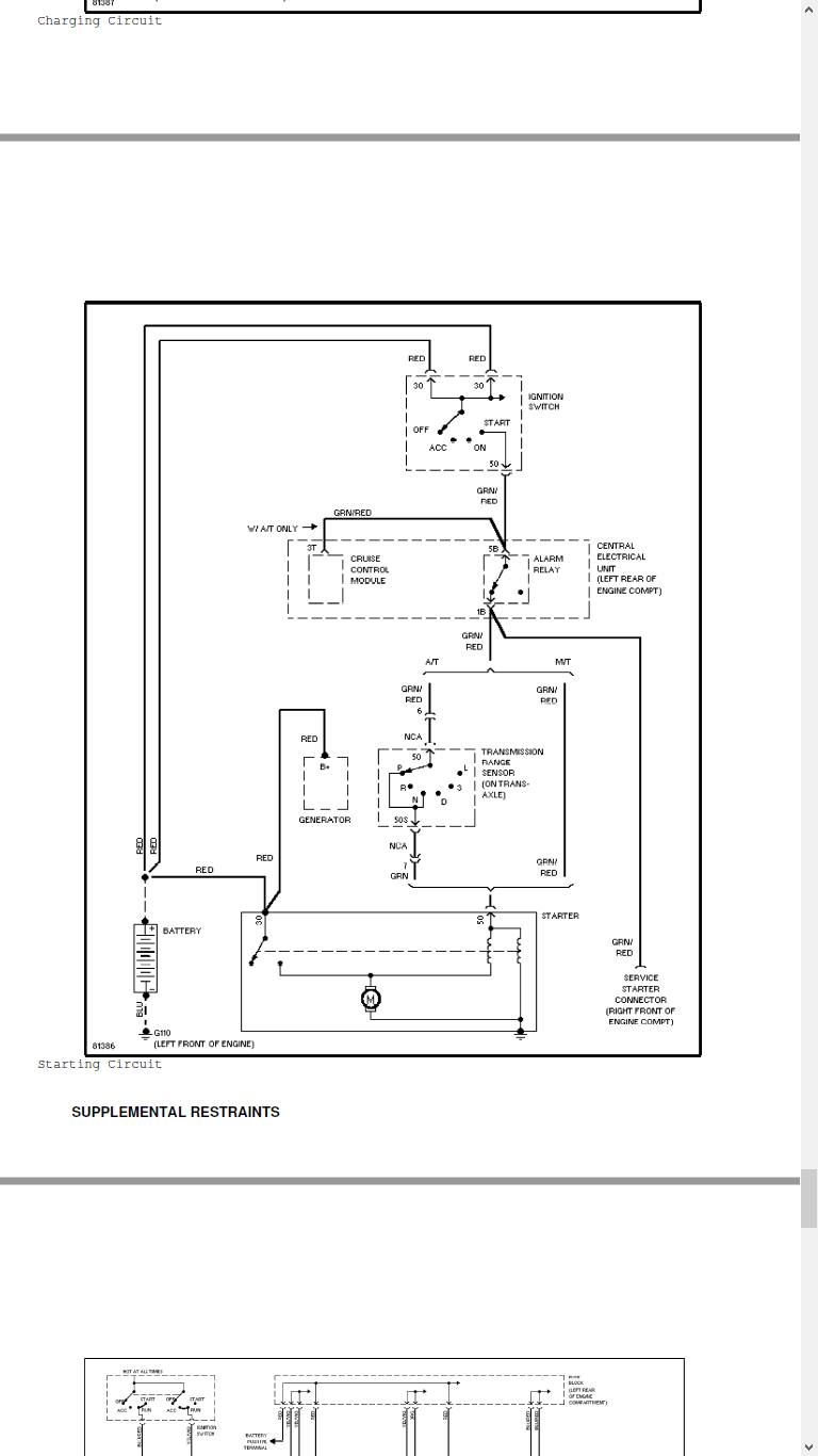

(somewhere along the line current wasn't going through. Still haven't found out what it was...)
There is a starter relay in the fuse box .....

The only relay I found that went to the starter was the alarm relay, which, oddly enough, my car never had... Mines didn't even come from the factory with an alarm...RickHaleParker wrote: 15 Jul 2018, 14:25 (somewhere along the line current wasn't going through. Still haven't found out what it was...)

Actually on the stock setup there is no starter relay but the path flows through the alarm relay. On a base model there may have been no alarm so there would be a dummy relay in the 210/211 relay position under the dash. Since it had an aftermarket alarm it is anyones guess as to what it goes through now. This is a typical butcher job for an aftermarket alarm setup.
I pulled that out of my son's 850 when it wouldn't start.
I too am very surprised that there is a Motronic on a '95 non turbo, that should be the LH 3.2 Jetronic setup. It is possible that it is a '96 model with a '95 build date. The title should tell you.
You found the relay.
Another thing that would keep it from cranking over is the Transmission range sensor. There are two Green/Red wires that are used to bridge the gap on manuals which do not have a Transmission range sensor. If you bridge the two Green/Red wires on an automatic and it cranks over as it should, the problem is the Transmission range sensor.
