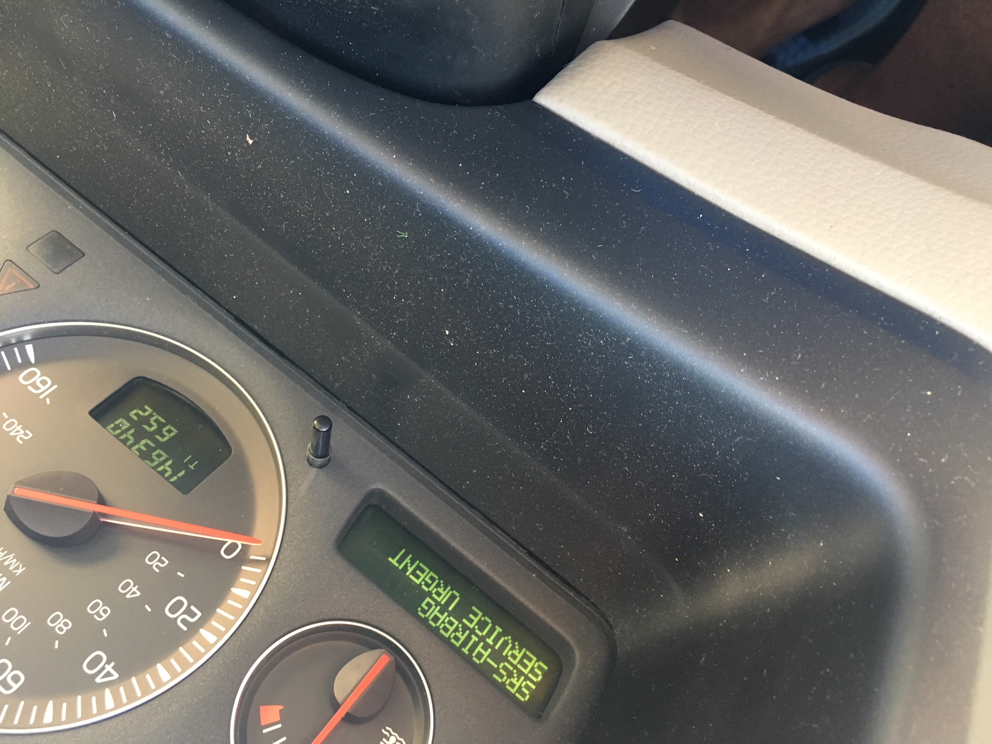

Update.
So, I dropped off the car at the Volvo specialist. He used the scan tool to reset the car and then kept the car for 7 days. They ran it through a battery of tests, including the CEM. They also drove it for about 50 miles. Nothing happened.
So, I brought the car home and it was fine for about 2 weeks until today. This time, it happened at a stoplight. The gauges went dead and I couldn't get out of second gear. It seemed to correct itself after I restarted the car, so I drove home. But the SRS air bag and brake failure warning lights came on. When I got to my house, I shut the engine off and then restarted it. I then noticed a strange clicking sound, which was accompanied by the gauges "jumping". I took a video clip of it as well.
Any idea where to go from here?
