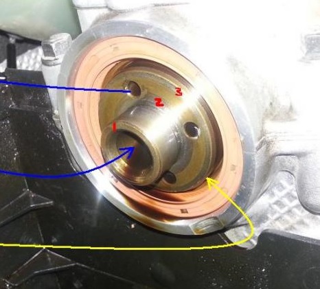

Off topic, but this photo makes it look impossible to press cam seals in too far..oragex wrote: ↑22 Jul 2018, 06:31 These are VVT engines, Variable valve timing (https://en.wikipedia.org/wiki/Variable_valve_timing). Near 3500 rpm when the valve opening timing changes, and the oil runs on different passages near the cam hub (my understanding).
I've seen the other photo that shows where the varnish stops as well so that just adds to the confusion.

This is a better view. There is a more clear area where the old seal was sitting, near the edge, and a darker area behind
