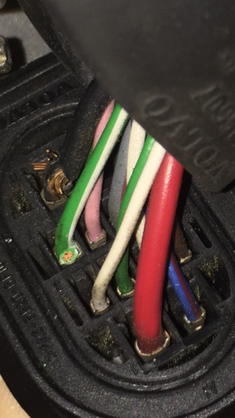

Look specifically at the green with white stripe conductor in the connector right at the door itself (pin 7 I think), should be 2 wires of the same color in a single crimp. Turn signal on left mirror working properly ? If yes, I would guess that one of those terminations- likely the conductor which heads back to the REM (A:21)- is compromised. Last link-first photo shows what it should look like in the door. Here's another link with a "like" issue- https://forums.swedespeed.com/showthrea ... gnal-is-on

bethanyXC90
- Posts: 8
- Joined: 27 July 2018
- Year and Model: 2007 XC90
- Location: NC
- Has thanked: 3 times
BINGO. One of the green wires is broken. I didn't even have to turn the signal on to figure it out ... as soon as I popped the rubber cover off and pulled out the wire harness, it was obvious that one of the green wires was broken in such a way that the ends could still connect if they were in a certain position. The black wire is frayed as well, but still connected enough to conduct (at least it appears so). Luckily there seem to be plenty of links showing how to fix this. I will follow up once I do the repair and let you know if it works. Fingers crossed!

Was thinking about this while you checked, the green/white wire is easy enough to resolve since it's the same conductor. It's the ground that's going to be a little more problematic. You could dump a bunch of solder in the area and hope for the best, but that spot is always going to be a flex point so you'll probably just buy some time (small tie wraps around the whole bundle in that area might make it flex less). For sure read up on what others have done and if there's the slightest chance the repair involves the metal inserts for a proper re-crimp, please post part numbers and tools used. Gotta be a pin repair kit for these types of connectors being sold somewhere in the world...
Push comes to shove you could pop the door panel, pull both pin and socket out from both sides of the connector and use a small bit to drill out the black wire path in the connector body itself. Run and solder with heat-shrink an appropriate gauge stranded wire (14ga maybe?) tie line, lock it down with tie wraps on both sides of the door, plug both sides of the connector hole with some silicone and close everything up. You would then have a permanent connection that's itself a flex point.
Great to see another photo, I'll have a look at both my cars and put it on the list of things to check from time to time. Apologies for the brake lamp mixup, was not reading thoroughly before responding.
Good luck with your repair !
