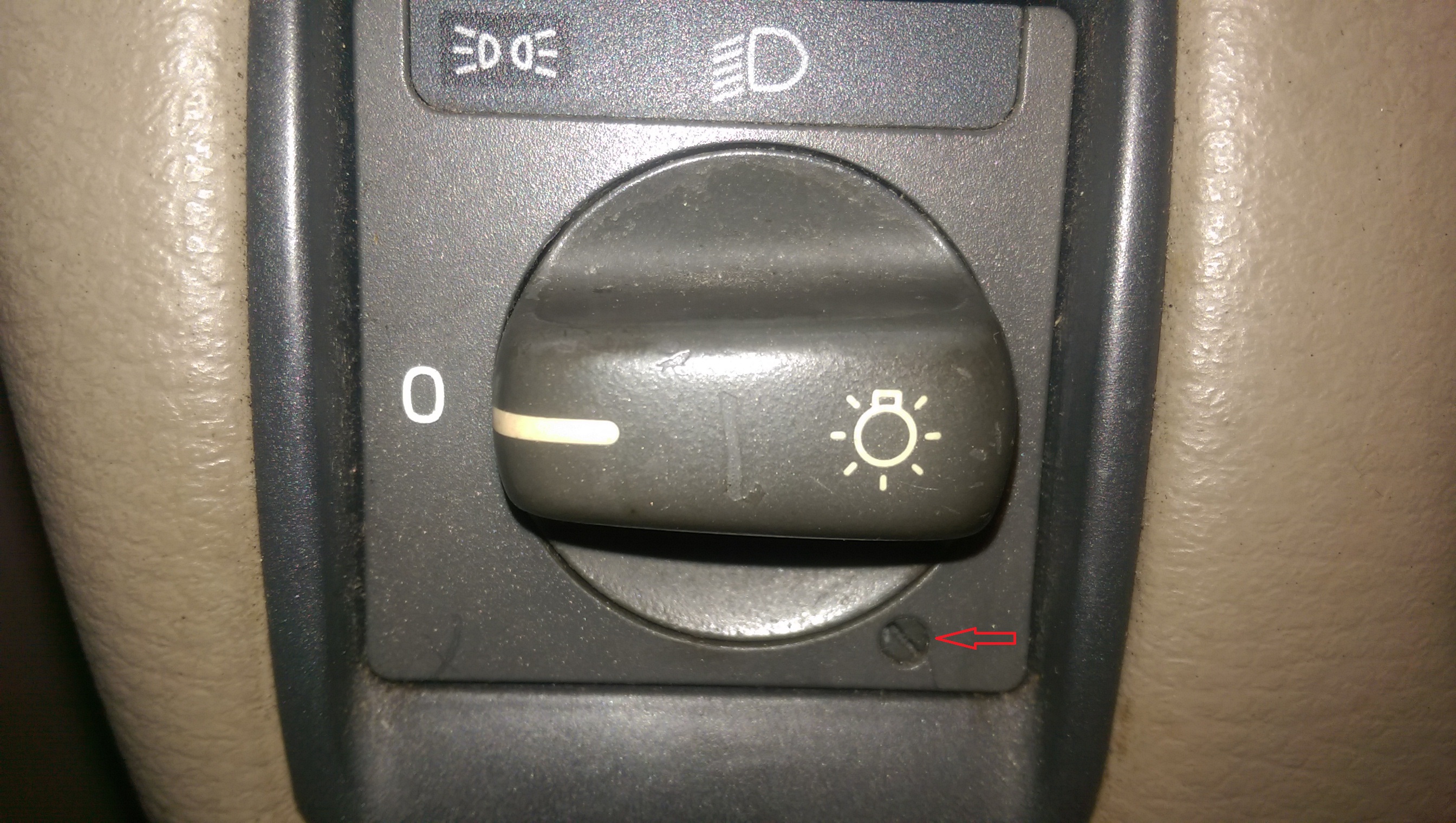

1. First off my headlights in the off position still turn on with i turn on my vehicle and stay on.

1) There is a small (3mm ish) screwdriver hole, next to the headlight switch. If I remember correctly, fully left (press in and turn left) will cause the lights to be off in 0, side lights in the middle setting (with front fogs if you want/ have) and headlight when the selector is fully to the right.

To explain #1 a bit better, so I have a 1998 S70. it has three positions for the lights. OFF/parking/headlights. In the OFF position as soon as turn keys to start vehicle they come on.

As for #1: the car has daytime running lights. Any time you turn on the key, the headlights come on. Unless you move the switch to the parking position. You can alter the behavior with the little screw as explained by Liggywuh. It is explained pretty well in the owner's manual, look in there if you have one or look here if you want to see it online http://new.volvocars.com/ownersdocs/199 ... 2.htm#pg26.

(1) Daytime running lights are active, required in Canada but in the US you can turn them off. The read arrow is pointing at the Daytime Running Light Switch, not a screw.
