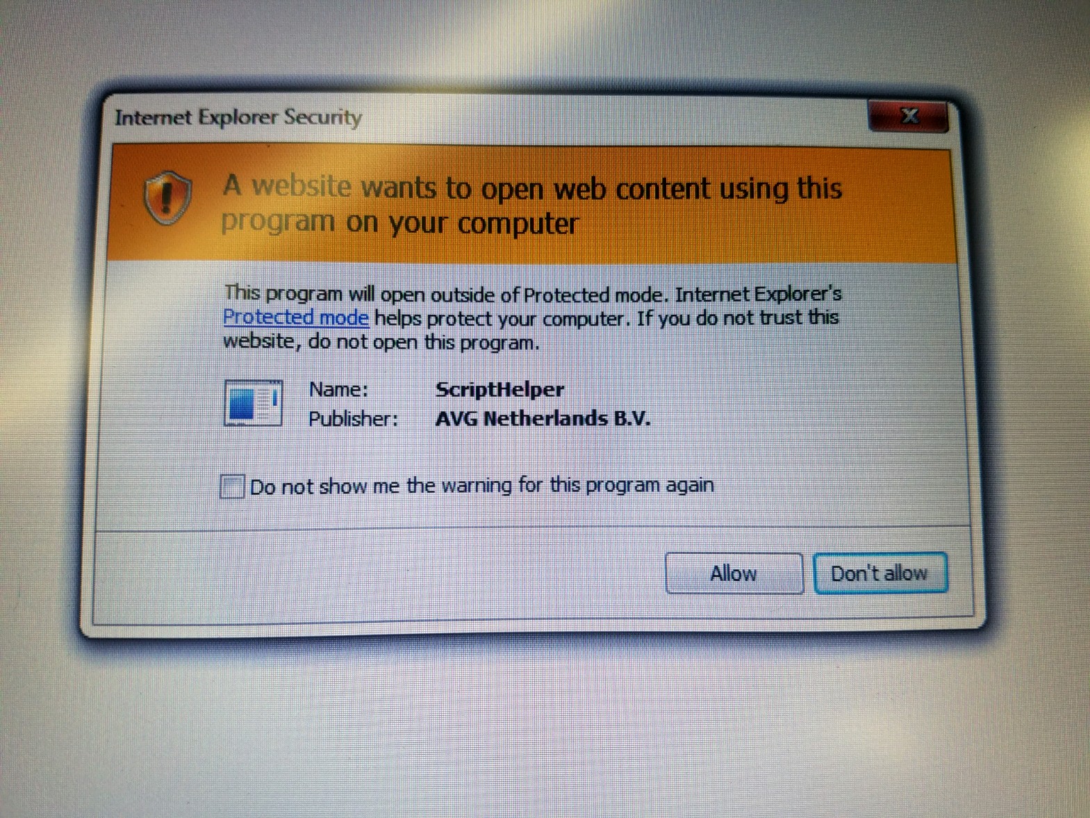

hello, new here and im having a problem with my vida. i bought this laptop off ebay a few years back with vida installed,works great and i also did the patch for the log in issue and it s been great. now all of a sudden i go to double click on the vida all in one icon and it doesnt start up. i get this internet explorer security window that comes up and i cant get rid of it unless i restart. any help would be great. ill attach a pichttps://www.matthewsvolvosite.com/forums/downlo ... 0952efture here of the window that comes up. thanks,Ray

That is your AVG Secure Search toolbar. It has nothing to do with VIDA. If you want to get rid of it, uninstall it from IE add-ons.

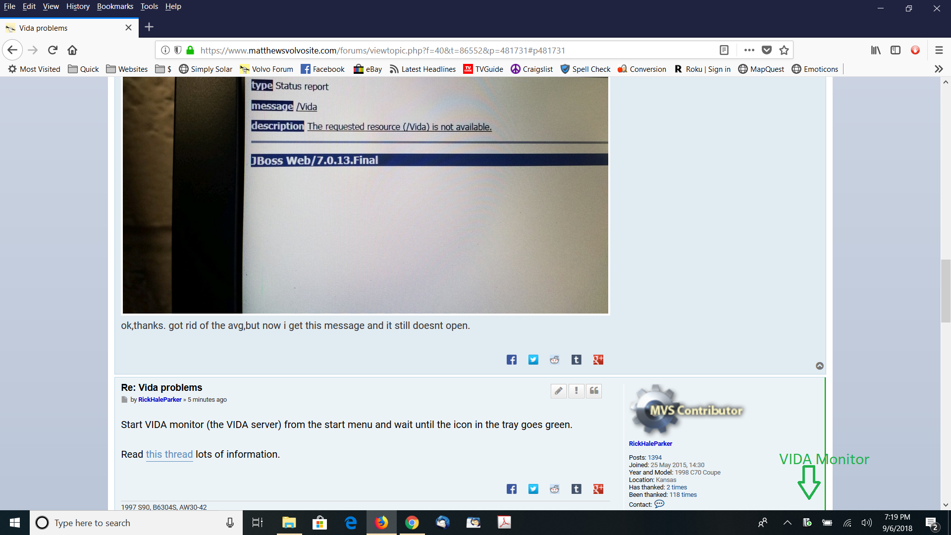

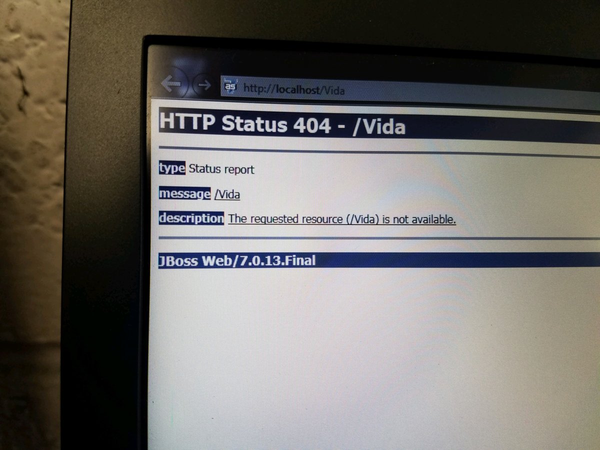

Start VIDA monitor (the VIDA server) from the start menu and wait until the icon in the tray goes green.
Read this thread lots of information.
