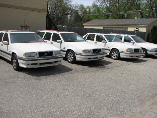

ask me how I know. Look at my "Stable" below.
My most recent purchase, '96 850 R. Had an upper intercooler hose with the same symptoms I had found the cracked hose by" Goosing" the gas from under the hood. I heard it first and found it.
Replace it and a couple other soft ones.
Knocks me into my seat now with its Chipped ECM And muffler delete from the previous owner.
The '96 R Wagon in the foreground.

Ben, do you seriously have 8 P80ies as in your signature? Or is it 'just' the 4 white ones? What a benchmark. I thought owning 3 is crazy ... that R misses 17 inch wheels, though.
