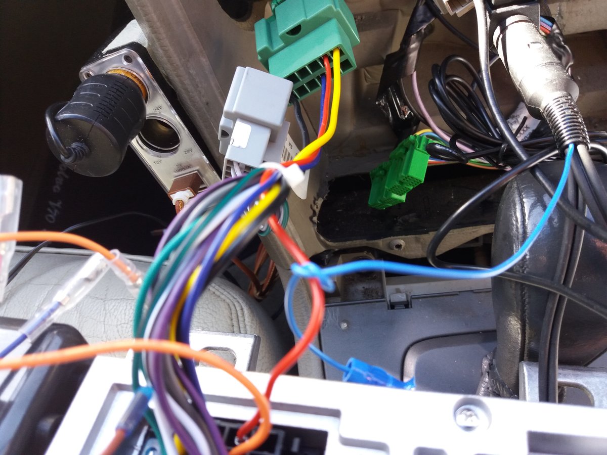

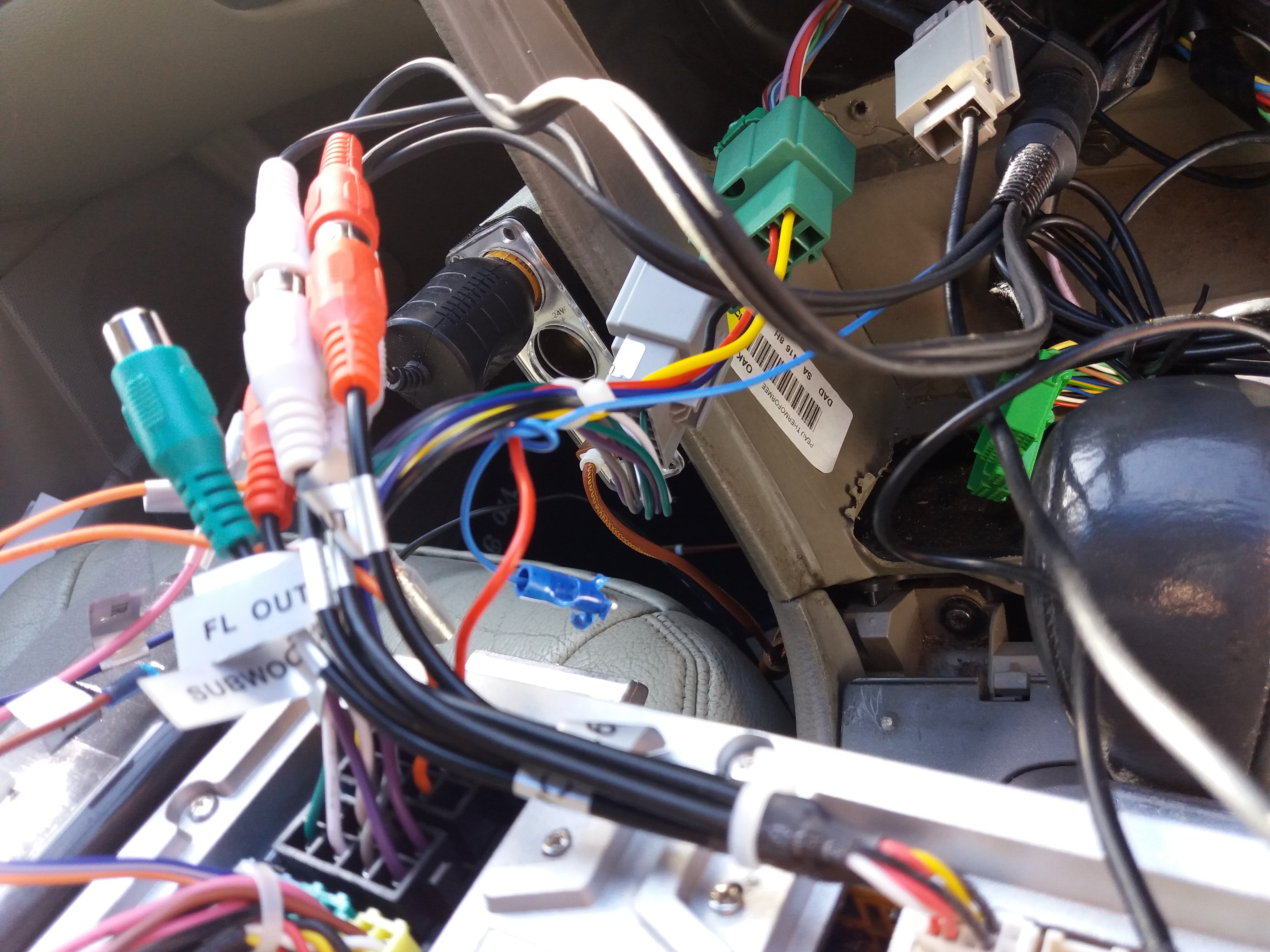

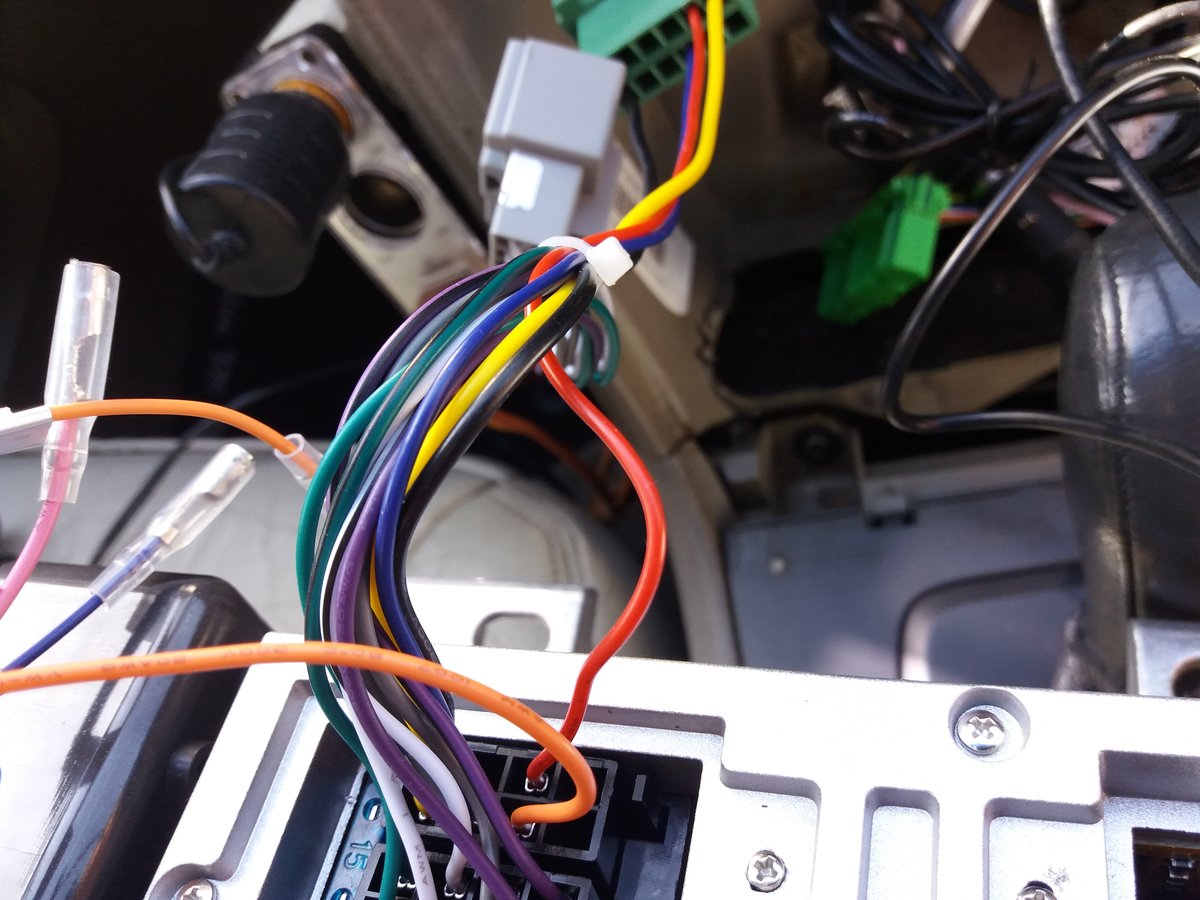

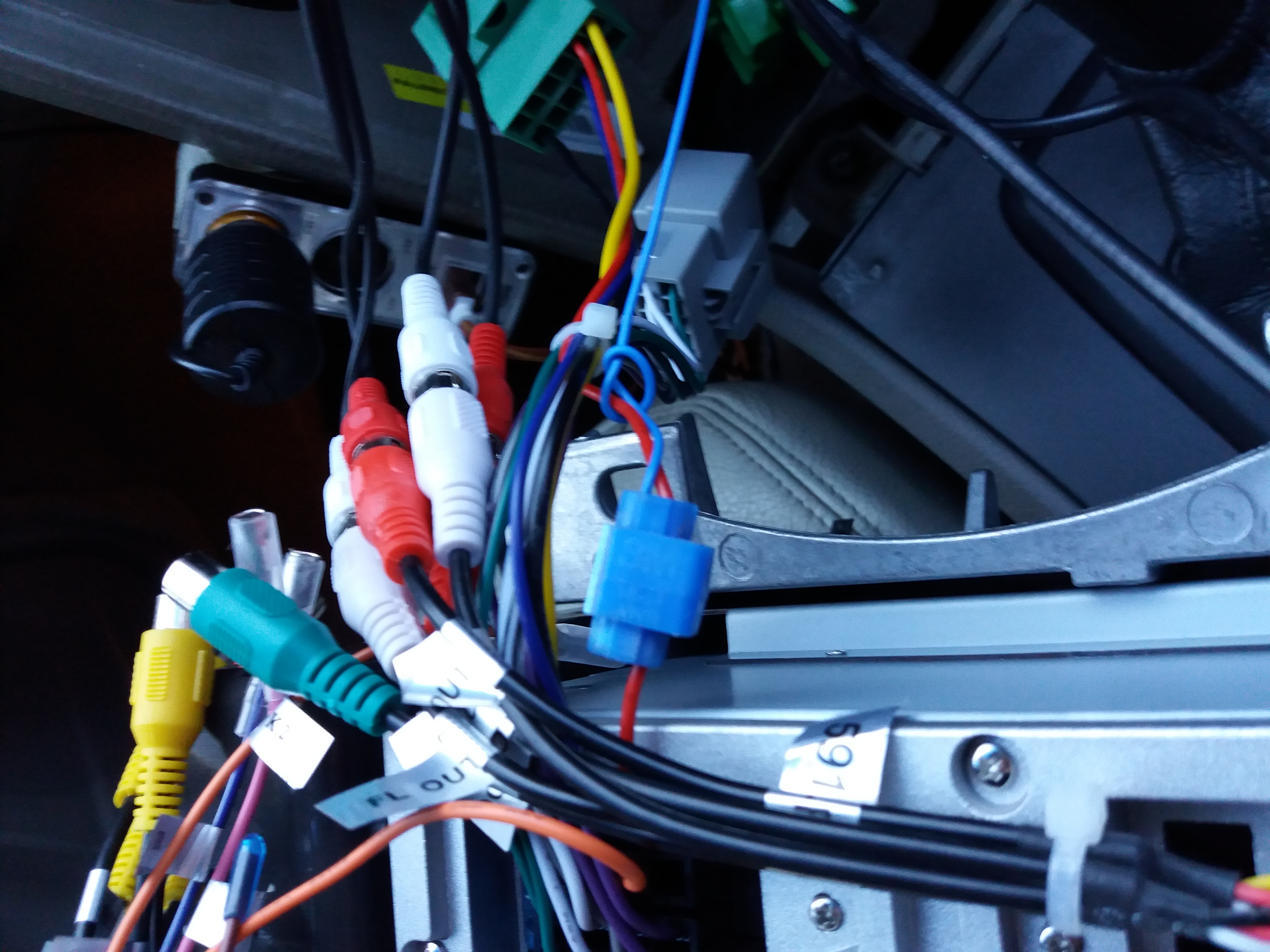

good morning you all,
Got also the same problems as no sound at all.
Every thing else is working perfectly but no sound getting out of it.
Been in contact with the supplier but also there is now a no-go anymore, even he don't know and send me to this site, so sorry if I jump in here.
But we all drive a Volvo and joyful like to drive this fantastic car.
I will place some pics here to make it all more clear.
quote:
I did all what was needed to have the sound cables connected.
Have a small blue colored cable but I presume this is the ground as the round stick is no w not connected to the unit (as original Volvo), all other cables connected but still nothing.
Have you got any further trick what to do to have sound in the unit?
unquote
quote:
Hi Peter, are you saying that this blue/white cable is not used at this moment? It is the remote turn on wire for factory amplifier. If it is not connected, then the amplifier does not turn on at all and cause no sound.
Please connect this wire to the red wire from our unit's harness to get +12 V power.
unquote.
So far the communication with supplier that actually a good man that try to help me, must say that.
Have done all what was needed but now still not having sound.
I read here that the Amp is under my seat??? Can somebody explain that to me as I never saw an Amp under my seat.
Anybody that can give me a hint what to do is highly appreciated.
Pics show the new after market sat nav and the wire system on back side of it. You can see there that I connected the red with the blue cable on the suppliers request but still nothing.
Waiting yours,
Have a nice day,
Peter den Breejen.

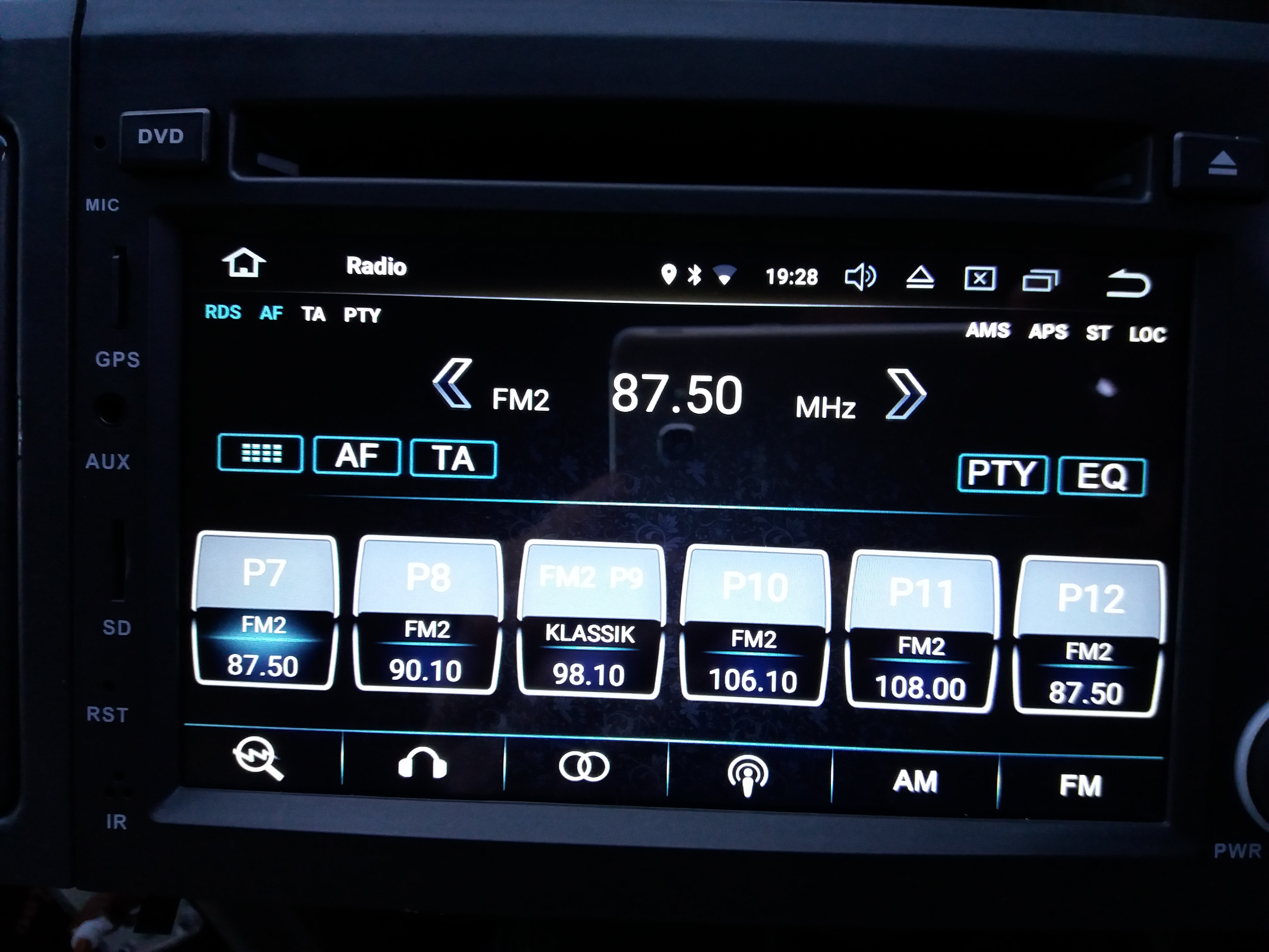

Problem solved!
I did give it a last try yesterday and used NOT the combination thin red-blue but YELLOW-thin blue and voila, it works all!!
So even if you buy an aftermarket Sat Nav from China without any further instructions it still can get it to work!
Now having sound on my radio, CD, mobile and sat nav., even can change the language between nearly all in this world but took English. So if anyone has the same problem as me let me know as now I know where to look for. Must say that NO wheel controls are working like changing radio stations, changing CD, but I don't mind.
Anyway, this topic can be closed as all solved, thanks.
