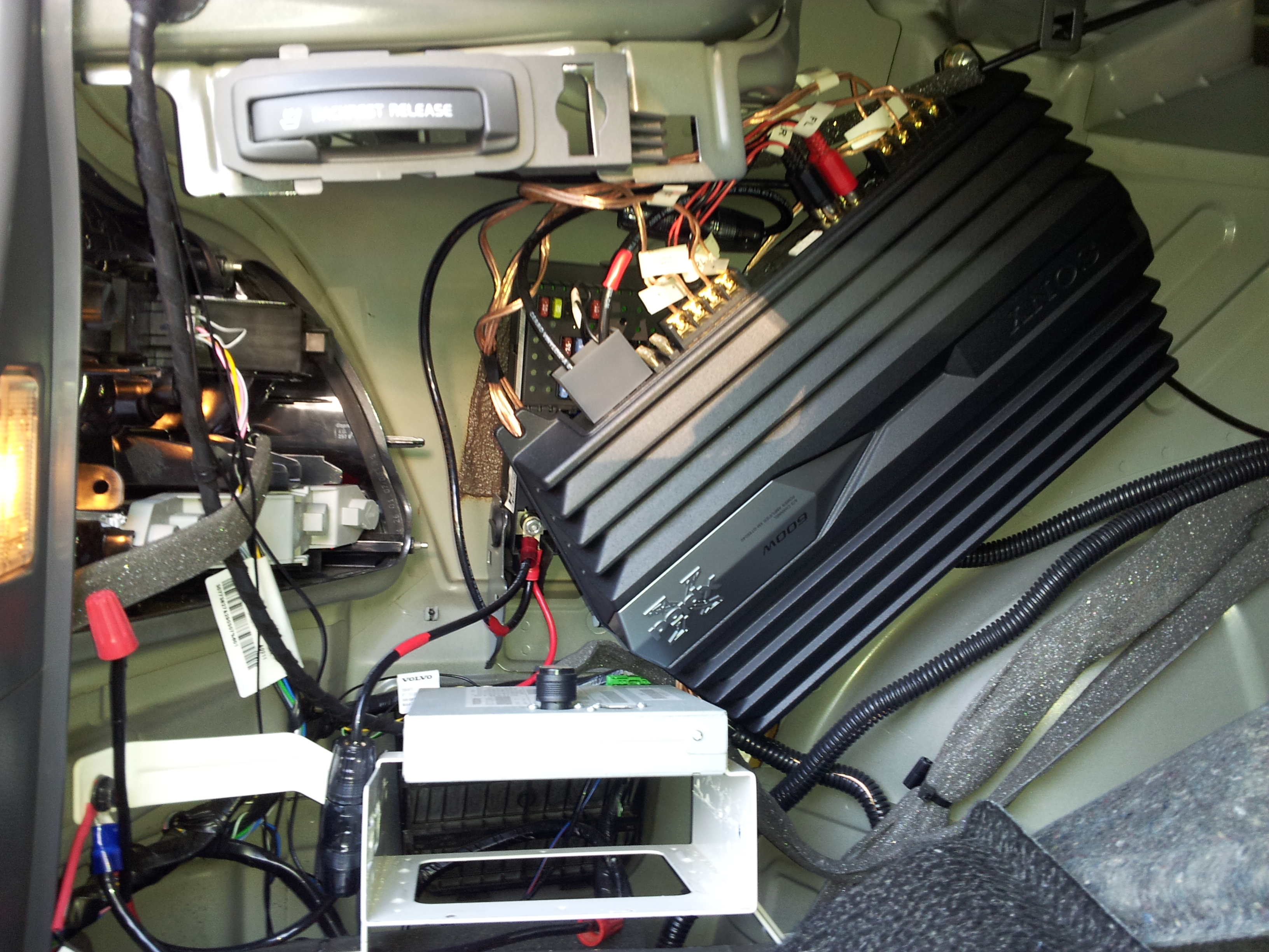

I added a Sony 600W 4-channel Xplod-series amp ($99). I mounted this in the trunk on the left side behind the truink liner. I had to drill mounting holes and tilt it on an angle but it fits great and is very secure. I did start with a mail-order clearance Hitron amp but it was defective out of the box. Since the car was torn apart already I ran to the store and bought the Sony amp. For power, I ran an 8-Ga with ring terminal right over the RCM power in screw - simply put ring terminal and new nut right over existing one. This ran to a Lightening Audio 50-Amp inline fuse holder, then to my amp. Total distance about 16". For ground, I ran up the left side and to one of the two ground studs under the back seat. Total distance about 30". ($20)

In this photo, you can see where the amp is mounted on the left wall of the trunk, behind the liners.
This is a close up, showing amp mounting. I had to drill two holes and it fits perfectly.
