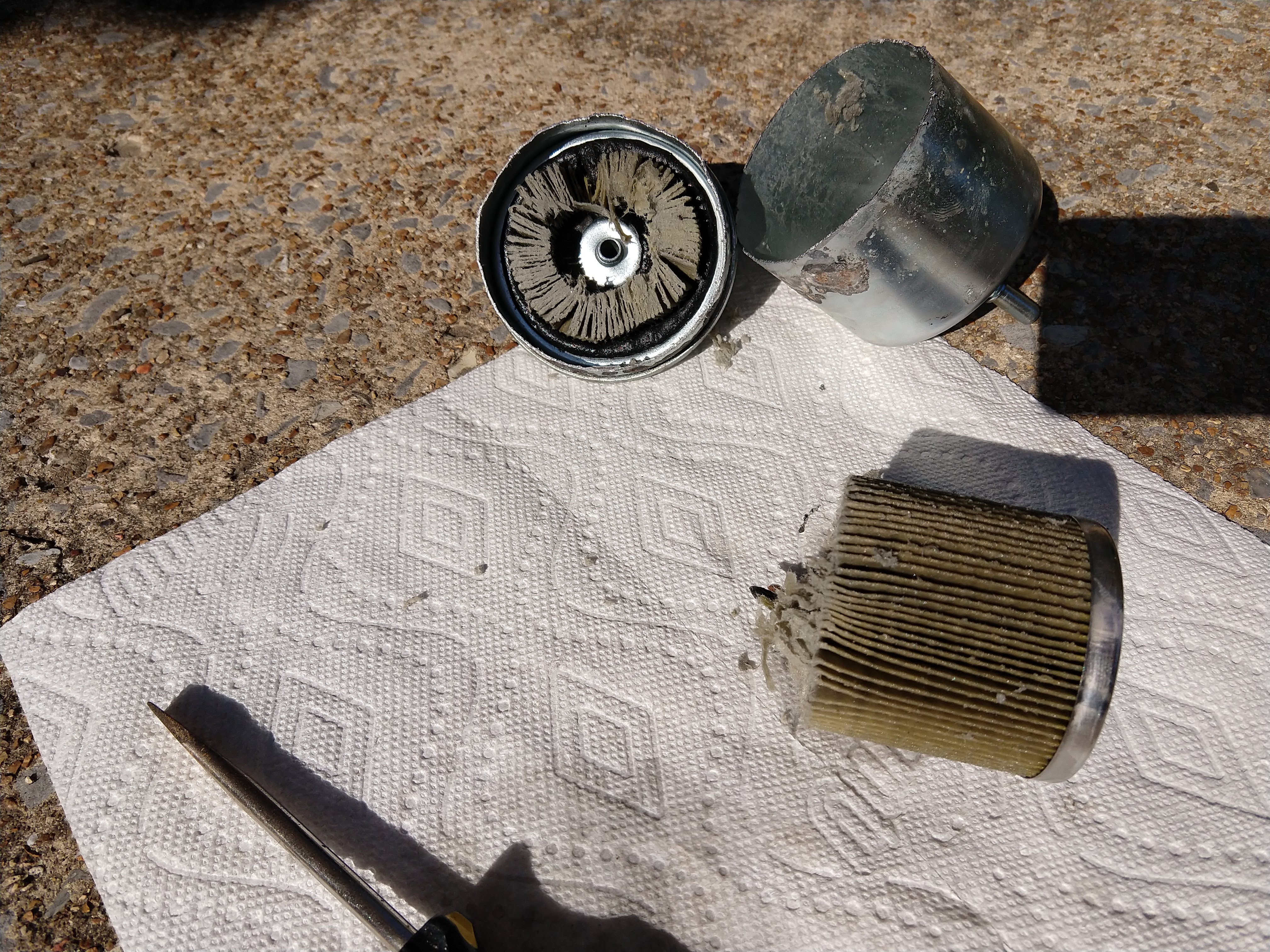

More today, Waiting on tool to remove fuel pump ring. Took off the fuel filter and cut it open only to find it clean. I was told that this tank was full of rust This fuel filter has 300 miles on it and not a speck in it. Still going to pull out the fuel pump and endoscope tank. Maybe lager crap in there..
