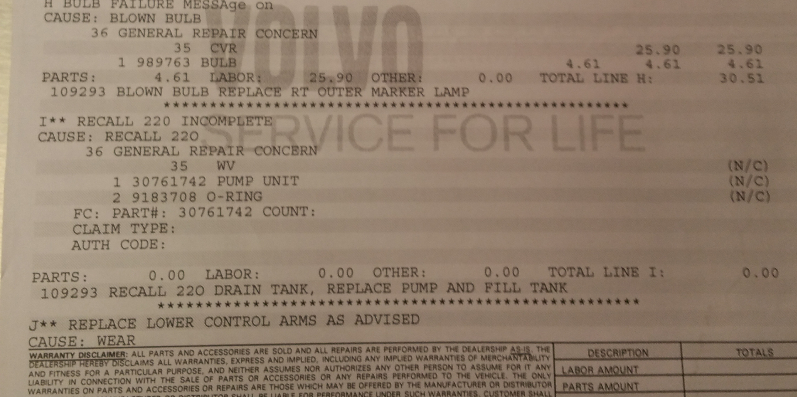

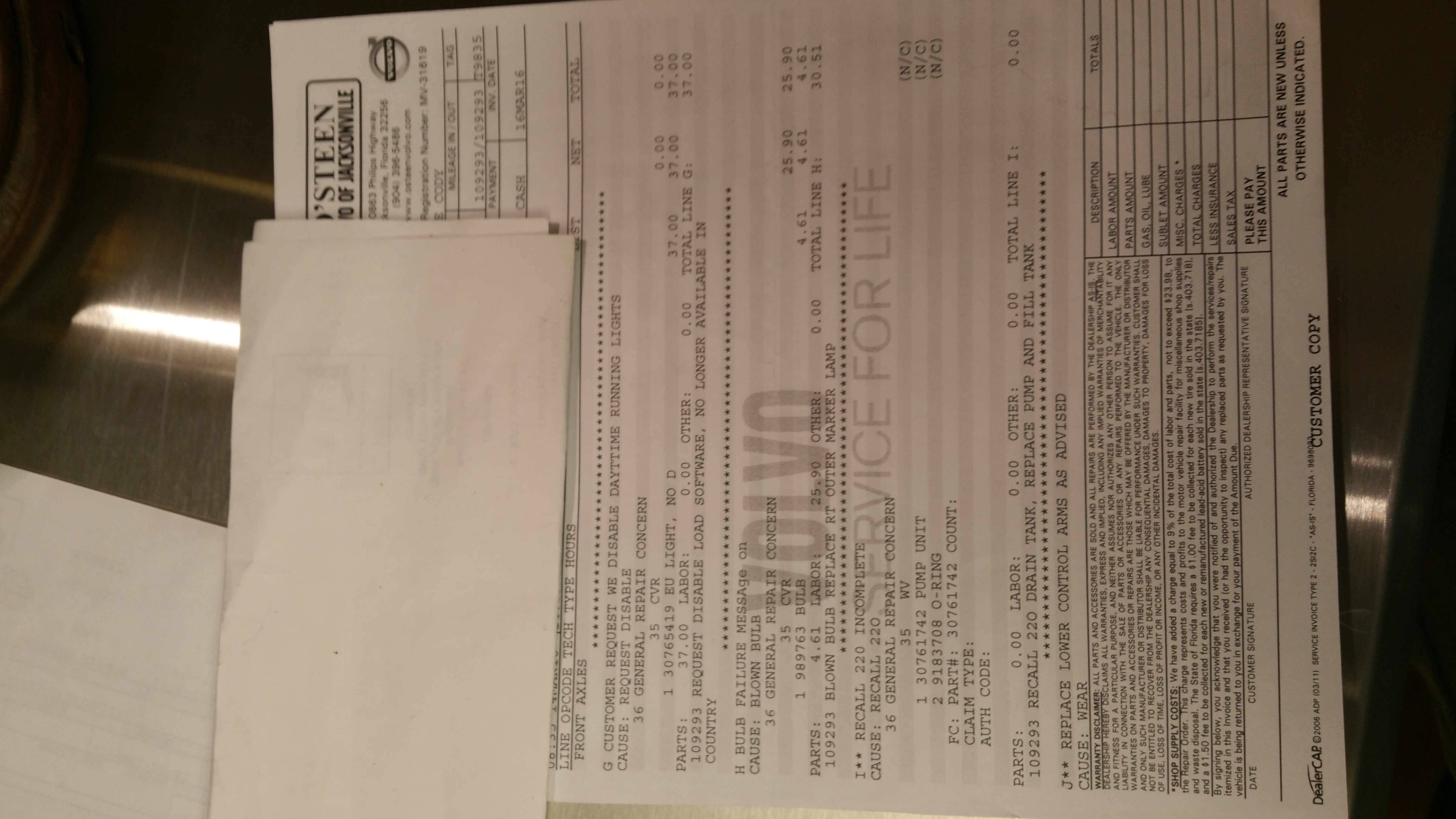

I had that happen in to my 2004 S80 and Volvo had a recall and fixed it for free March 16, 2016. It would be worth checking. June
