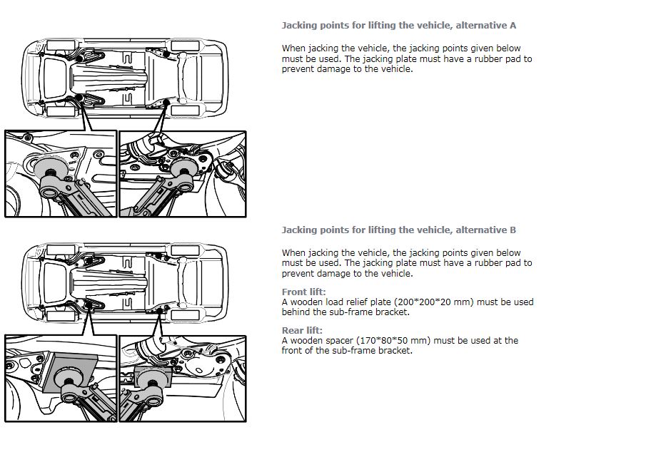

Someone on another Volvo centric site that does not play well with inline attachments was asking about XC90 lift and rest points.
For what it's worth-
XC90 Jacking Points.JPG (104.7 KiB) Viewed 6363 times

Raising it from B and then placing jack-stand at A has worked for me.
