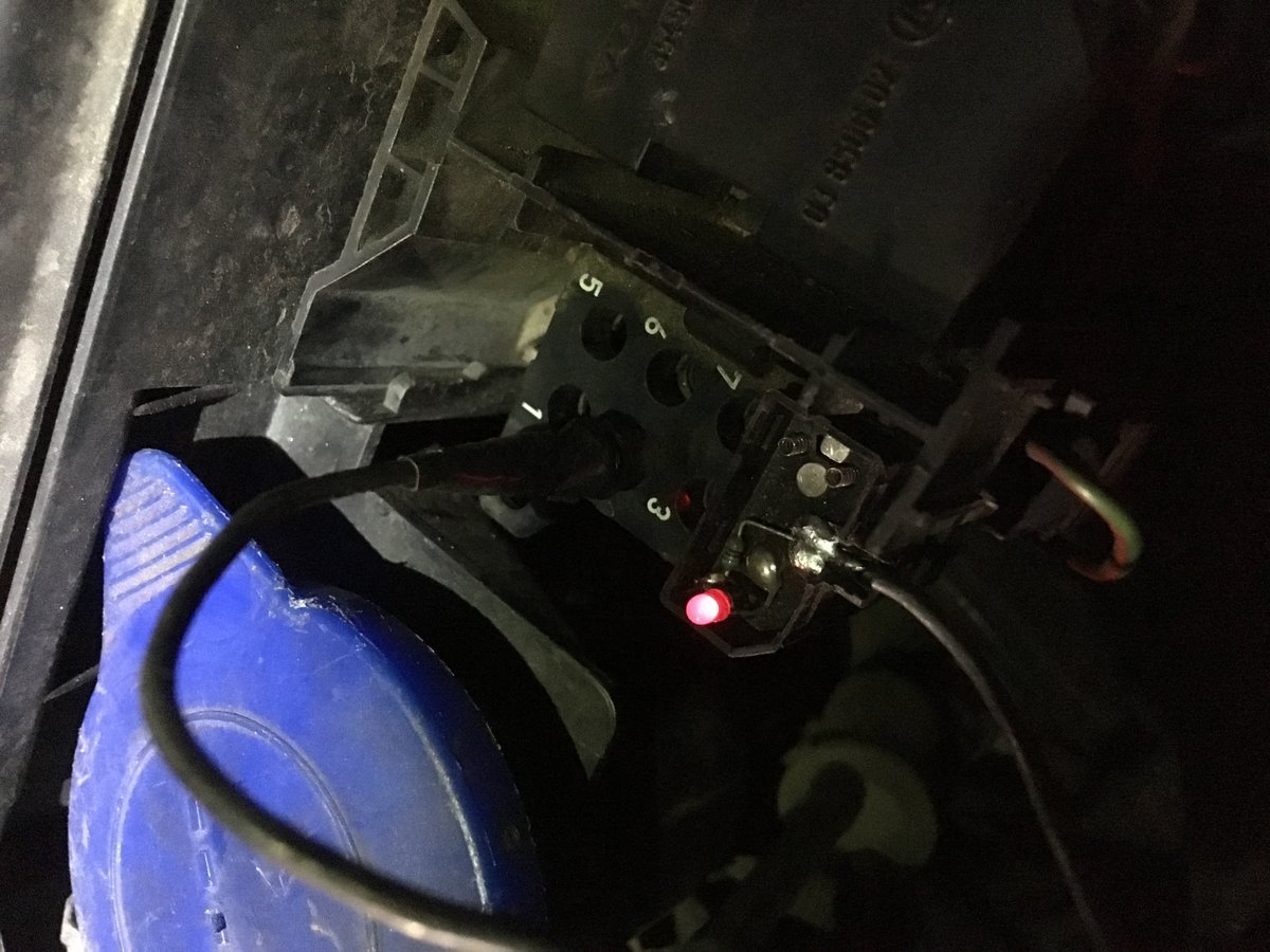

DIAGNOSTIC UNIT “A” LED DOES NOT FLASH
1) Disconnect diagnostic unit “A”. Turn ignition on. Check for voltage at diagnostic connector terminal No. 4. If voltage is not present, check fuse and wiring. If voltage is present, turn ignition off.
2) Connect an ohmmeter between diagnostic connector socket
No. 8 and ground. Ohmmeter should indicate approximately zero ohms. If reading is not approximately zero ohms, check wiring. If wiring is okay, replace diagnostic unit “A”.
Googled around a little.
The whole push the button thing might be a little tricky. There's definitely a window of time between pushing it, and letting it go. Hold it longer than necessary, ya get nothing. Hold it not long enough, ya get nothing.

Misha, I tried that already and it was worse so scratch that, there’s two ecm in the box...
Villagepc, I’ll try that tomorrow and get back with results

The OBD-1 button box is has a connector on the bottom of it. My suggestion would be to remove the button box and then take it inside to a well lit area to disassemble it. There are four plastic tabs that hold it together and the outer shell needs to be pulled out at those tabs to get it apart. I use a small screwdriver to pry the shell out and then toothpicks to hold it out while I go to the next tab.
It is amazingly simple once you get inside of it. The one thing you have to be careful about is that there is a spring under the button and it wants to sail when the shell comes off if you remove the case quickly. Once inside you just need to clean the contacts and repair the flywire. I have just made a new flywire in a couple of cases by soldering the new wire on the contact and then using a crimp on "bullet" connector which you can get at any hardware store.
I also always spray the connections, both top and bottom, with electrical contact cleaner. Once the corrosion is cleaned off I have had good luck getting the box to work again.

Thanks, lee. I’ll try that as well. A longer wire is a good idea anyway. I have a feeling O2 sensors are the cause for the way it’s acting so hopefully I can fix the box and figure out which one it is...

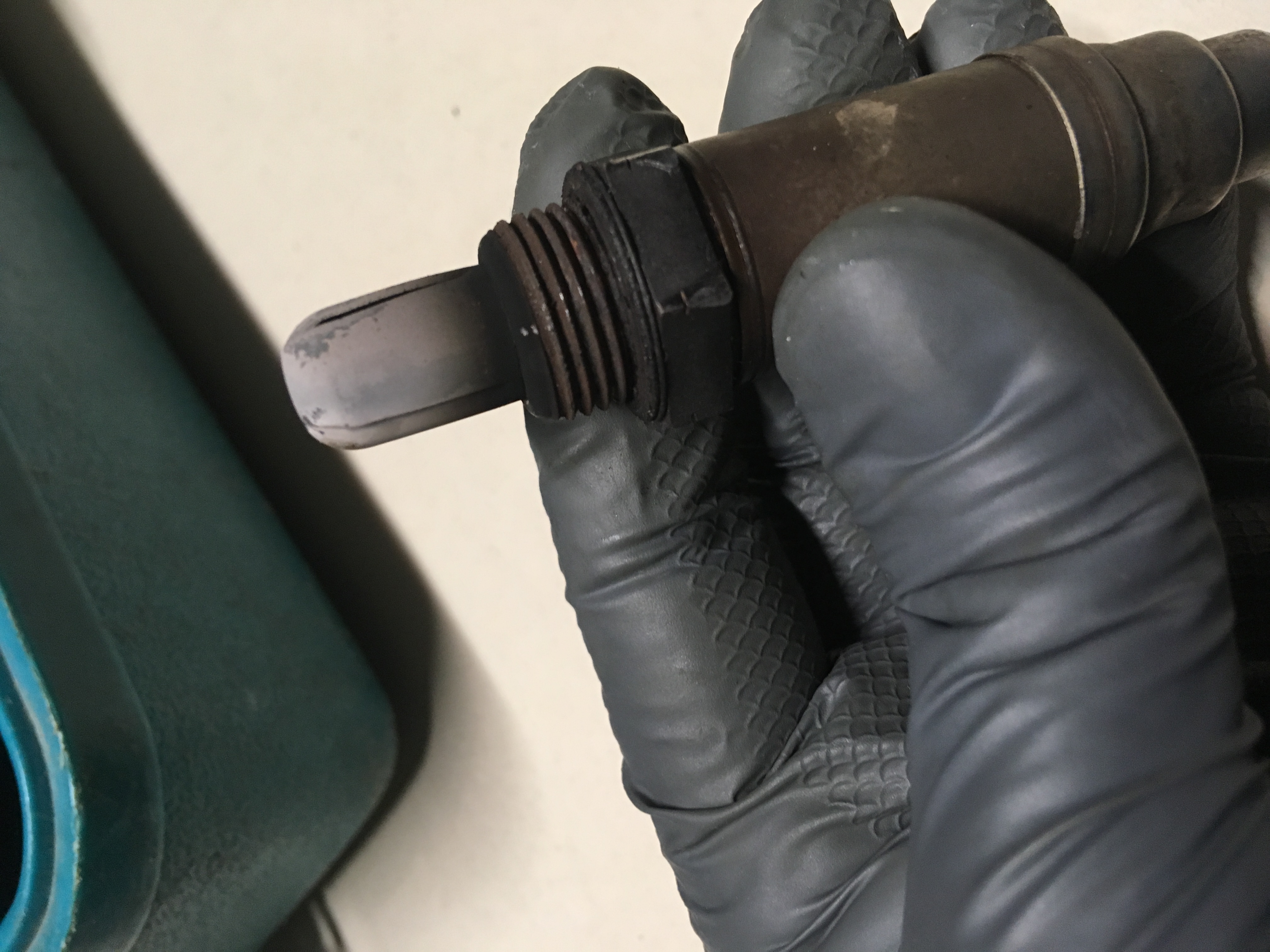

You have only one o2(front one) and idle bouncing up & down is not o2 sensor malfunction indicator.

You’re right lol. I just found that out when I got under it. At least I can return the other one... it does have a lot more pep now, the old one was definitely worn. I mustn’t have explained the symptoms properly; when I shifted, the RPMs would kind of wander for a second and then get up to par, and I noticed my fuel mileage wasn’t what it should be. It’s coming up on a 70K mike service and im going to service the pcv system and a tune up as well. After all that I shouldn’t have to worry about much for at least a month LOL! I’m gonna see what I can do about the obd short now so I’ll let you know...

So I got a longer wire soldered up which is nice, and Everything is clean now but I just realized there is no terminal 4 or 8 so... idk where to go with that but the diode still stays lit when plugged in without pushing the button (not pictured, it’s somewhere here) I used a clean wire to do the buttons job but the response was the same. Fuses are good. The coolant cap was loose... I’m done till tomorrow.

Old o2 sensor doesn't look bad.....your car wasn't running rich...otherwise it would be fouled with black sooth and carbon.
What you see is just a shield,sensor and it's elements are under it.
