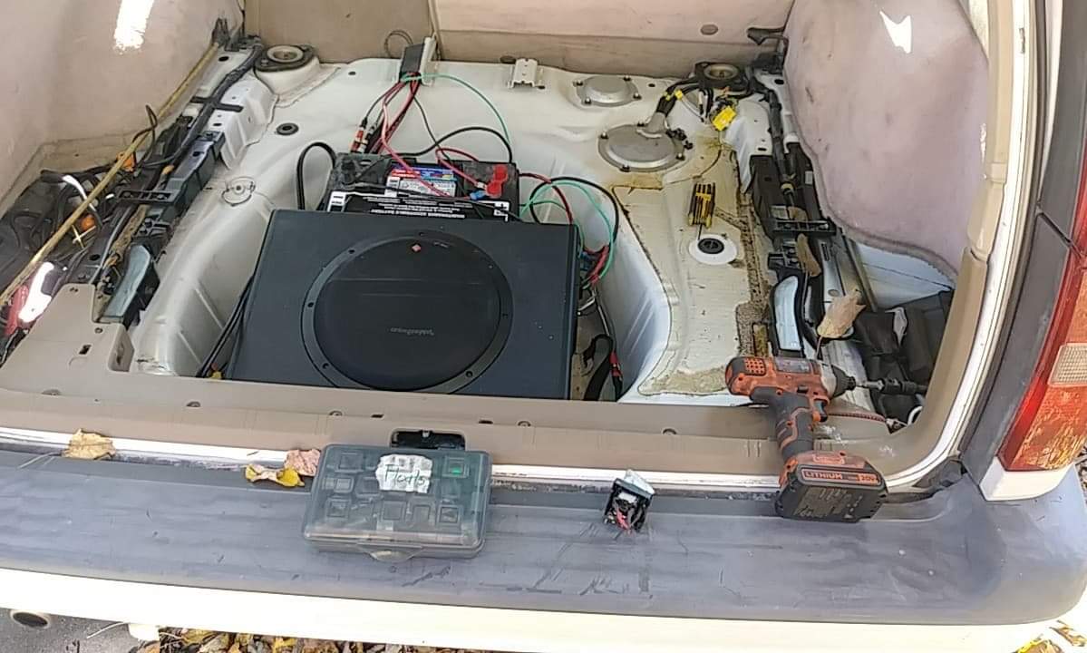

I finally found the one: a 12in powered sub for about $120 by rockford fosgate. No amp needed. Just power and ground. That install was normal, nothing fancy, just a remote wire connected to front cig lighter. (Note: if I power the cig lighter lighter, with the car off, the radio/ac gets power. Not sure if its safe or not, but no key is needed. I found this out when I accidentally powered the remote wire with my 2nd battery during install)
The deep cycle 2nd battery is xxxxtra... I have an inline breaker separating from the main battery that I can open and close by hand when exiting the car so that one battery wont drain the other if something is left on.
This 2nd battery will eventually power an extensive LED light system, I intend to leave on overnight night.
But, it can also be used for camping.... I have a small 140W inverter, but may get a bigger one soon.

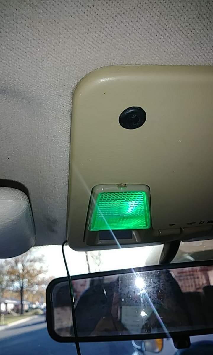

The radio install is normal, but I did drill a hole in the plastic cover near the rearview mirror, and added a rubber grommet that I could push the mic snugly into. I wired it along the passenger side using the entire length of wire.

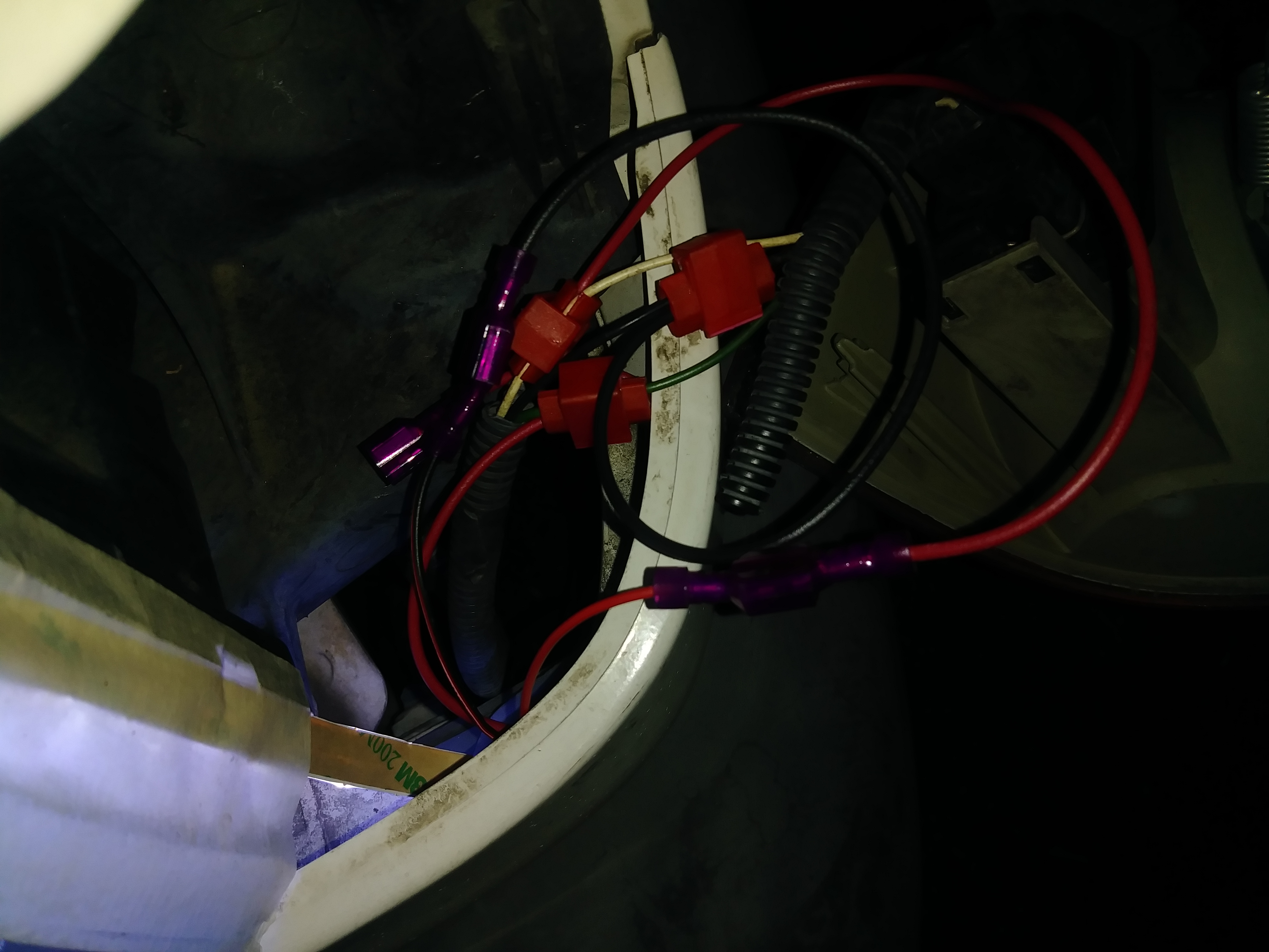

I tapped the running light wires from behind the blinker lights on one side (can post pics if yall wanna see) and added an LED strip facing in, along the top and inside edge of each headlight. Theyre connected across the grille (the strip is 5M long) which adds a cool glow in the middle. I just used masking tape on the headlights, because the hood covers the edge when closed, and its flexible to bend and stick tight and easy to remove or replace.
I tapped the blinker and the running light wires, but only used the running light so far.
End effect: my headlights appear illuminated when just the running lights are on. As a delivery driver, it comes in handy and looks cooler than those audi drls... Lol

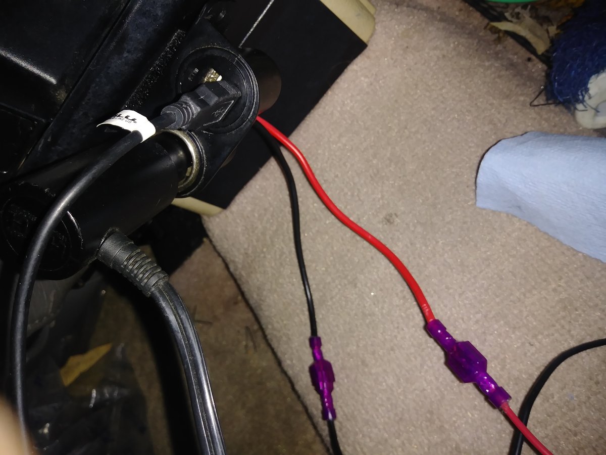

I added another dual usb charger on the back of the middle arm rest, near the floor of the back seat. Its powered from the battery in the back, and I just vecro'd it in place and used plug connectors on the wires so it could be easily removed or replaced if damaged... Or if I wanna use those wires to power something else.

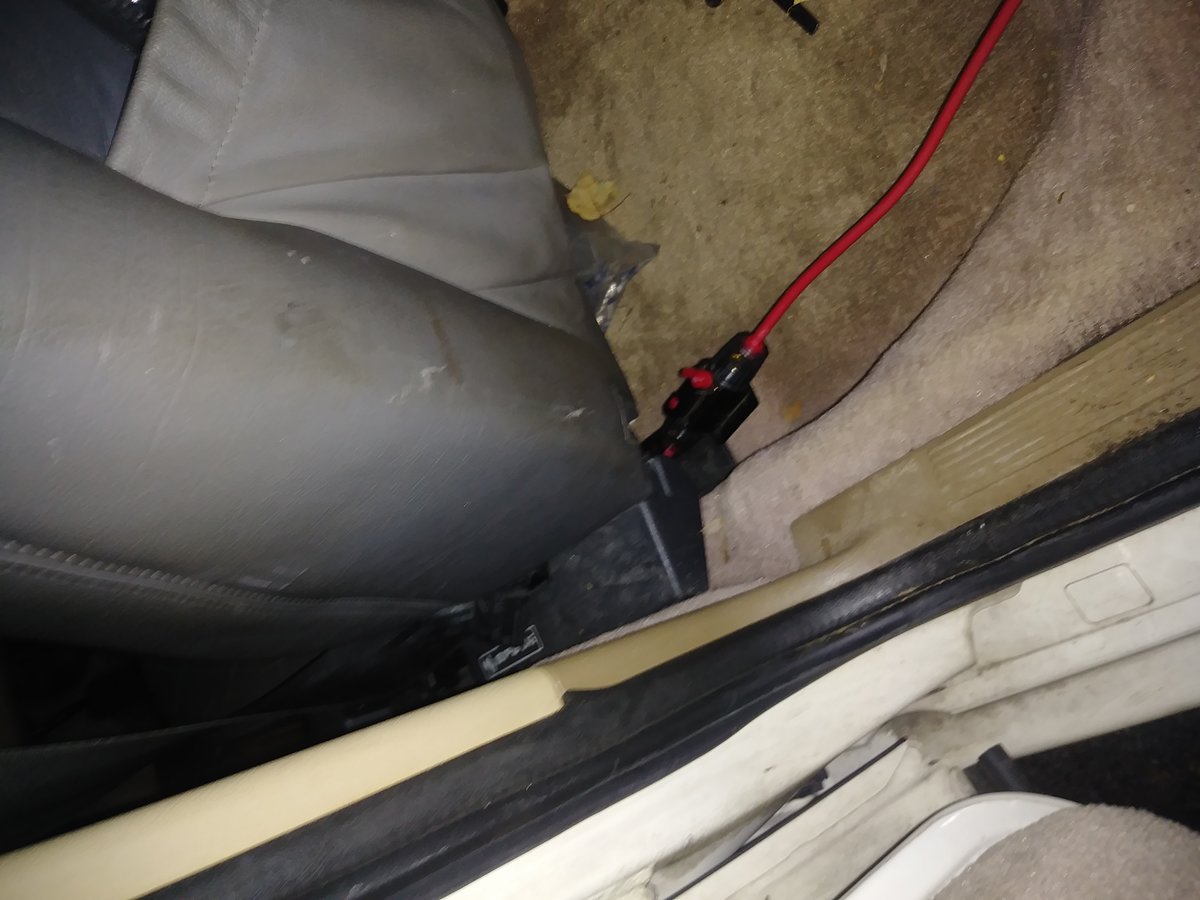

Heres the breaker switch, behind the driver seat. I didnt tuck the sub power cable under the rear portion of the carpet since no one is ever in the backseat. This breaker switch is huge time saver when working on the car, disconnects the 2nd battery instantly. Its a 60amp breaker switch, twice the threshold of the inline fuse located near the main battery. This is all based off my 12" sub's 30 amp fuse.
I used waterproof plug connecters, behind the marker lights, to tap the LED strip into the DRL. I taped it down across the top of the headlights.
