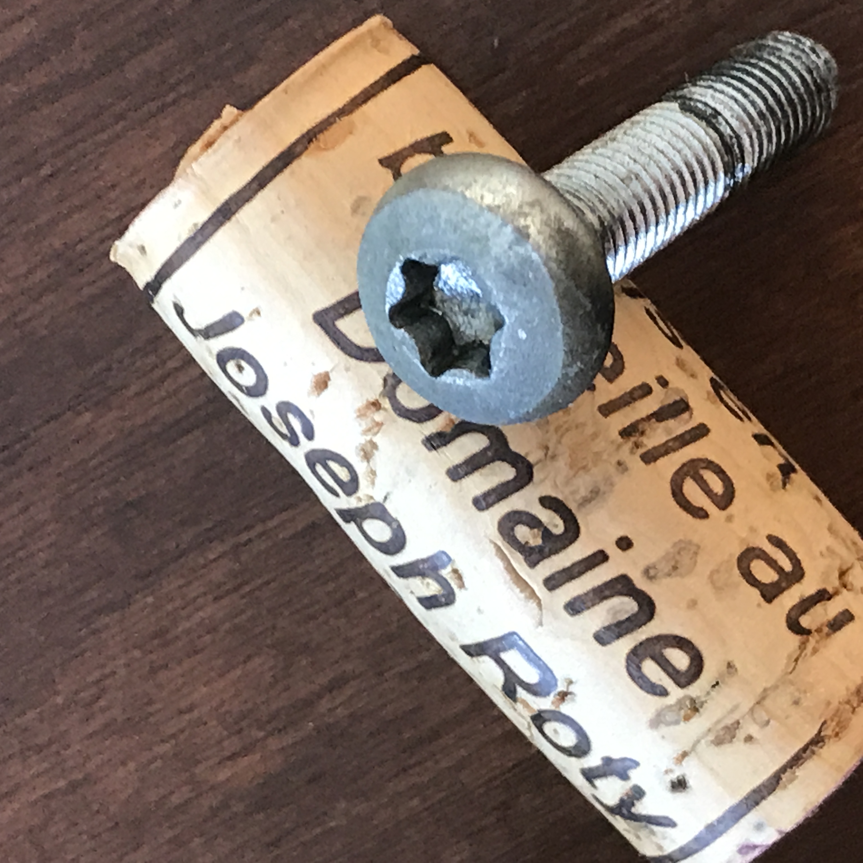

Thread is M6. Length I am not sure, measure one?callahanoffroad wrote: ↑17 Nov 2018, 16:44Any idea what size bolts they are?WhatAmIDoing wrote: ↑17 Nov 2018, 16:05 I've heard of using a dremel with a cutting wheel to cut slits into the bolt heads for removal with a large flat head screw driver.
I do not think these are common bolts to snap, usually just strip the heads, so I would try the impact. But first, soak everything in your favorite penetrating oil. Also, you are 100% going to want new, quality steel bolts.

Length of entire bolt is 1 3/8", threads 1 3/16", head 3/16".

From my understanding it isn't that the bolt is stuck, it's the heads are soft.
I've seen videos where they basically snap the head off and than use vicegrips to turn the bolt out.
