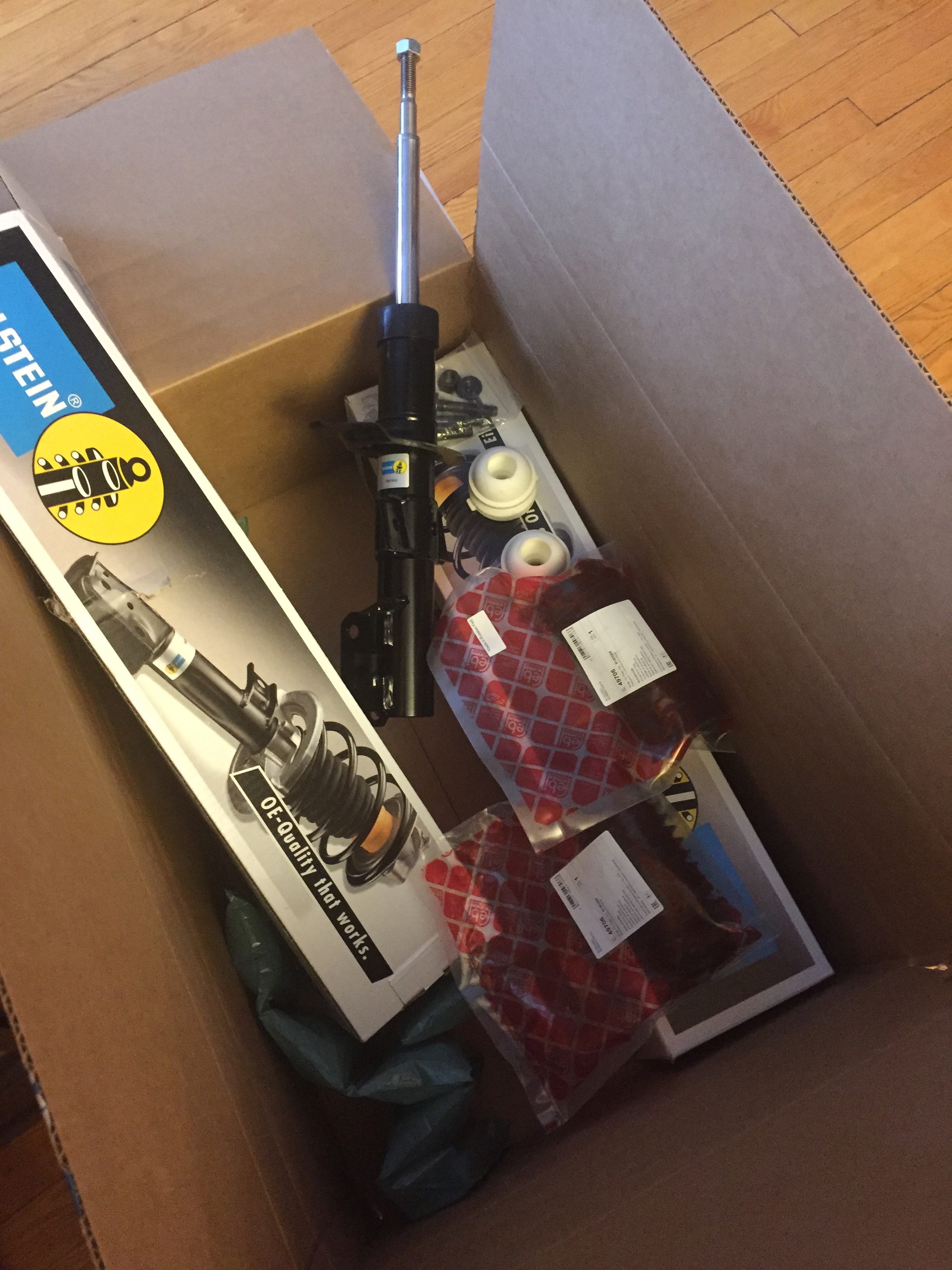

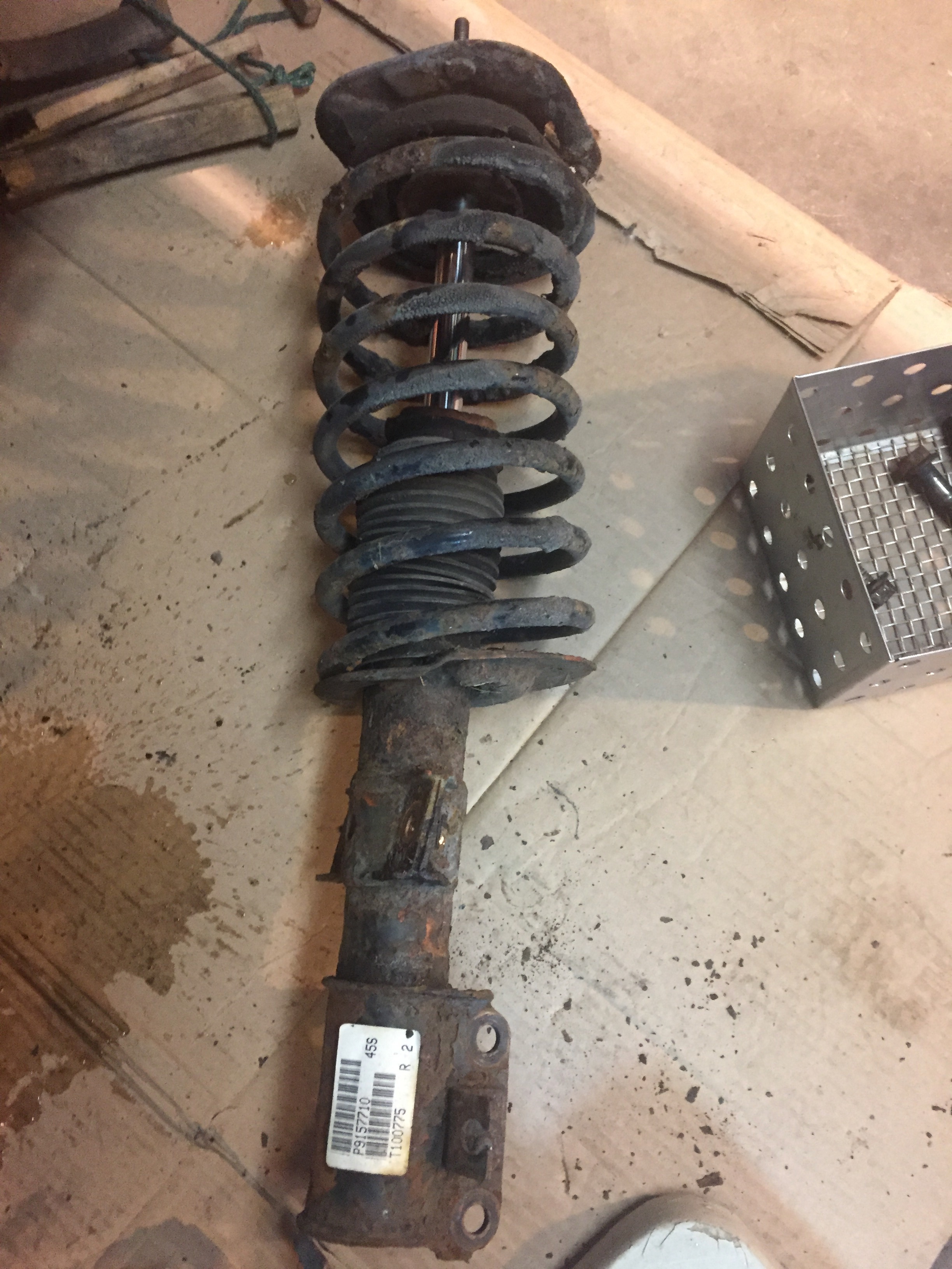

Installed badly needed new struts on the 95 R. I don't even know what these old ones were, the label is no help, they were on the car when I got it. One of them was leaking oil. I got this car for $150 from a guy 3 blocks away after he posted on MVS it had a blown engine and he was giving up on it. Only time ever I've seen someone from my town on here. Six years later almost everything done, I tend to wait until things break to fix them. Although the valve stem seals have started to leak :evil: :cry:

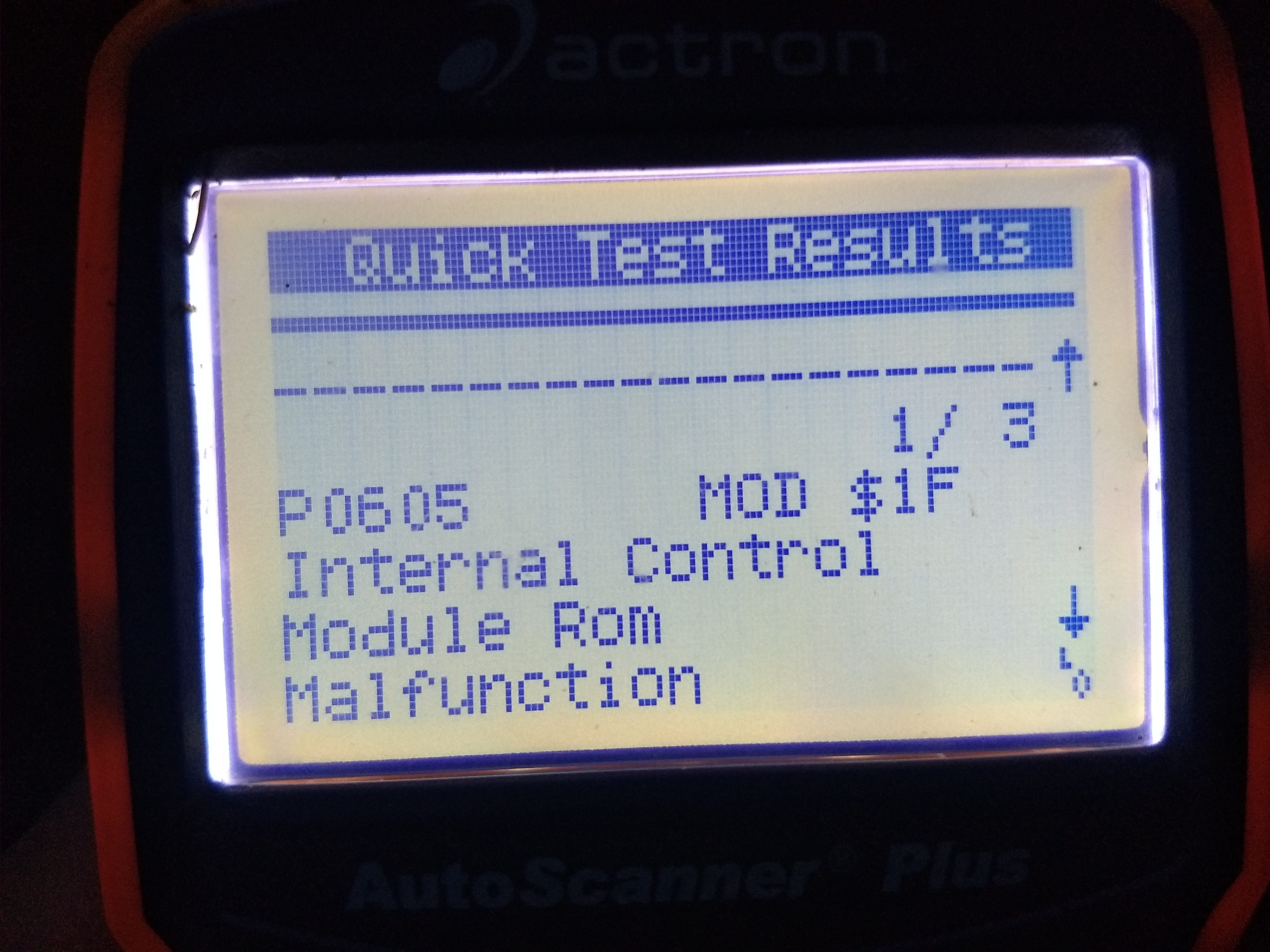

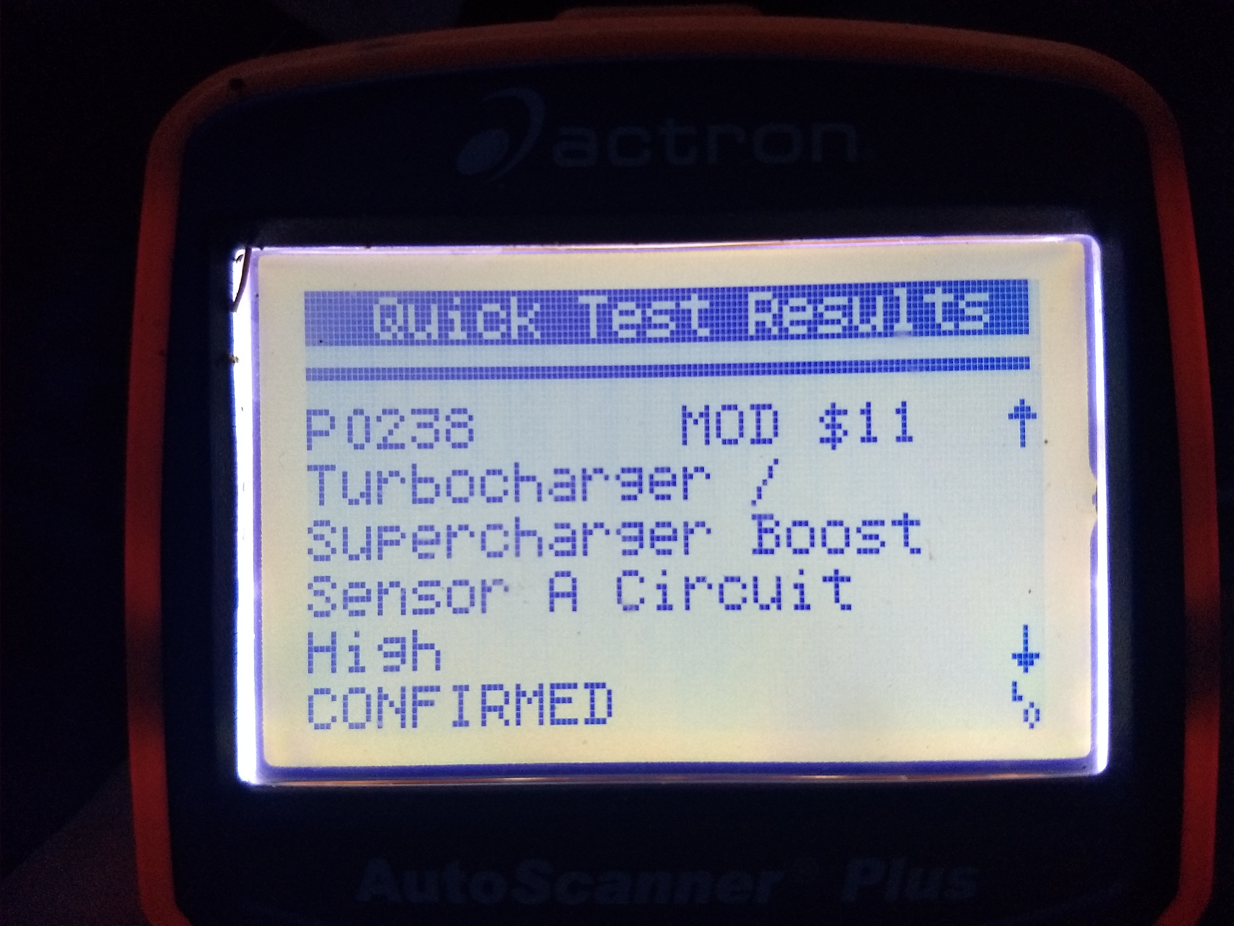

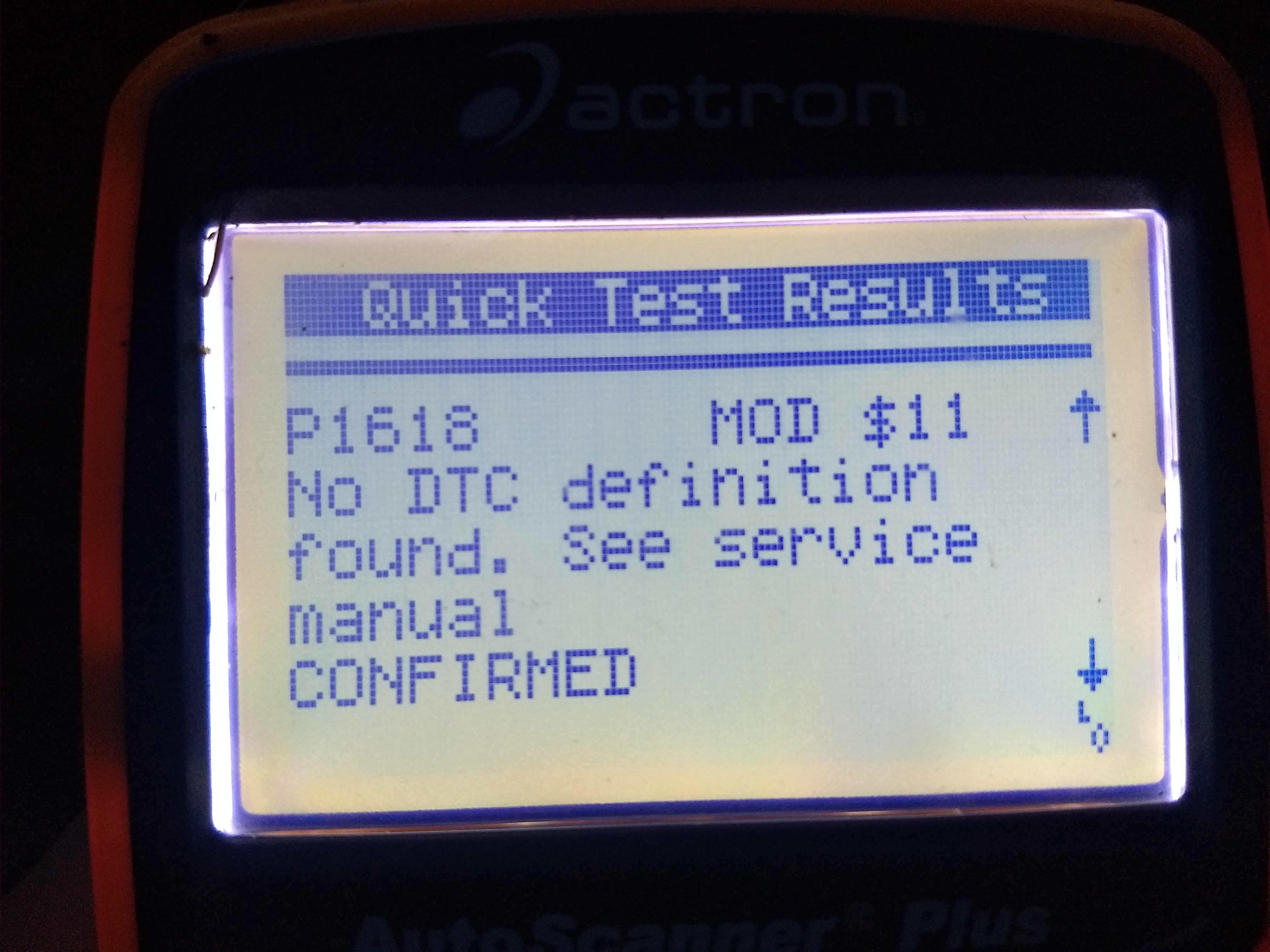

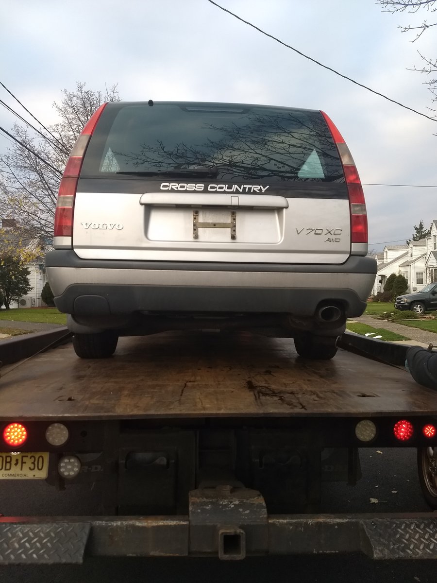

I picked up a cheap '99 XC ("needs starter") with a third row with the intention of swapping them into my '00 V70 MT, but it's so nice inside and out that I wondered whether I should fix it up.
Plugging in the code reader, three issues came up: P1618, P0238 and P0605.
Either way, the third row is already a hit with our three kids, so even if I don't get to save this XC, or the engine, it seems like a win.

Ive got a like new starter for you Bruno
Lets get the real ECM codes from that Puppy - those mapped codes probably arent right.
VOLVO generates ECM codes - VIDA always reads them right
Scanners have a software map that maps Volvo to Pxxx codes, the generic ones like P0455 map fine, the manufacturer specific codes
P1xxs and P2xxx usually don't map correctly.
My 1999 used to tell me Cylinder 8 misfire a lot on my scanner.

That P1618 is a communication error between the ECM and TCM. May be a wiring issue (not as scary as it sounds) but from the sounds of that P0605 code the TCM may be shot. Cheap enough at the junkyard to try one.
The other code is likely unrelated to the other two, but you never know. I'd start by replacing the TCM. Are the TCMs in ME7 cars married to the VIN like the ECU? I'm not sure.

abscate wrote: 19 Nov 2018, 15:40 Ive got a like new starter for you Bruno
Check my 1999 TCM in my Classifieds and see if it matches your number too, Bruno
The 1605 code is just the ECM telling you the TCM is bad.

abscate wrote: 19 Nov 2018, 18:47
Good to know. Thanks!
I should've mentioned, too: The dash is also lit up like a xmas tree, including a flashing up arrow.
