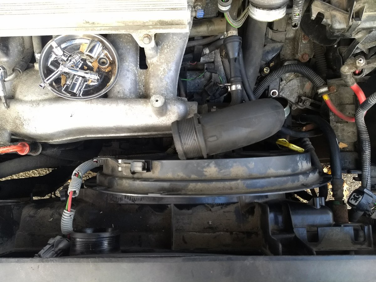

I decided to attempt removal of the starter motor in the cheap '99 XC AWD that I picked up for its third row. I posted about it here: viewtopic.php?f=1&t=87410
This pipe that runs underneath the intake manifold (turbo inlet?) doesn't let me remove the fan or the shroud to access the starter in the first place! Both the fan and the shroud are off but stuck in there, and I've since removed the oil dipstick, too. Still no dice. I'm contemplating removing the intake manifold and doing the PCV while I'm at it. Or maybe draining the (orange) coolant to remove a couple of hoses.
But I don't see how to remove the hard plastic pipe that's in the way. I've looked around on MVS and elsewhere but have yet to see another engine with this obstacle.

Usually I'm able to push the intake tube towards the manifold enough to slip the fan past. If you need to, you can remove the hose camp from where it attached to the ETM and slip that hose off, but the problem at that point is that it's much easier to do this when the fan is out of the way.
I can't stand the design of the '99+ intake.

Thanks! I had been nudging it over but didn't want to crack or dislodge the intake pipe. Even loosening the clamp and rotating it out of the way would help, but I can't see where it attaches.bmdubya1198 wrote: ↑20 Nov 2018, 15:14 Usually I'm able to push the intake tube towards the manifold enough to slip the fan past. If you need to, you can remove the hose camp from where it attached to the ETM and slip that hose off, but the problem at that point is that it's much easier to do this when the fan is out of the way.
The '99 intake is nuts!

It's pretty much right in the center of the underside of the intake manifold. It's not the easiest thing in the world to get to, but hopefully the last person to mess with it put the screw on the hose clamp facing the front or front right so it's a little easier to get to!
