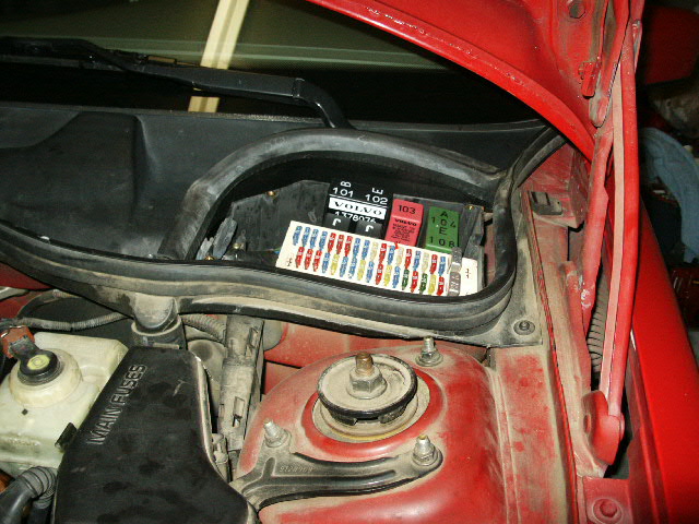

If no pressure at the fuel valve after depressing the valve with the end of the blue cap I would venture to take off the fuse panel (torx 25 X 4) on the driver's side of the engine bay and locate relay 103 usually it's pink or green. You can short the contacts on the car that would have gone across 30 and 87 with a paper clip to see if fuel pressure is restored.
Also that battery would be getting low after so much cranking so it wouldn't hurt to put it on a charger.

Thanks for the advice as well! And the pic. I just tried replacing the fuel relay on Monday so I can definitely get in there and try your advice.

I went to the shop today after work and got a fuel pressure test kit and some supplies to make a jump wire for the fuel pump relay (103). I also took my battery in to get it charged, but when they tested it (so they could get a before and after number to confirm the charge was successful) they said it was in such good condition that the charge would be pointless. It is only a year old, but I was surprised they didn't want to at least try.

I also made the jump wire and connected it to 30 and 87, but no change in trying to start the car.
