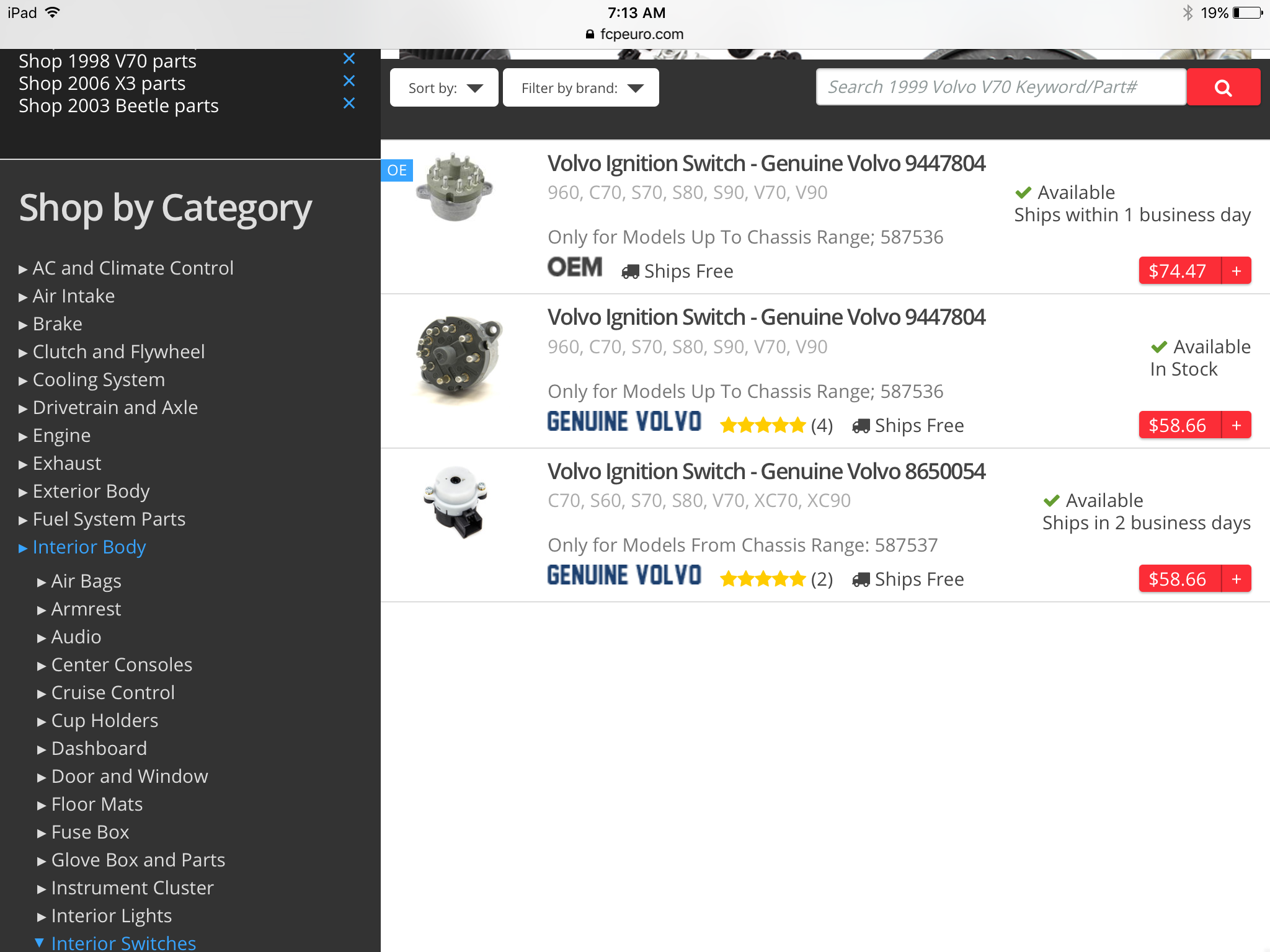

I have probably logged 99% of my repairs in my 1999 T5 maintenance log here
viewtopic.php?f=35&t=57678
And the threads on the switch 9447804 is here
viewtopic.php?f=1&t=55868&hilit=1999+v70+t5&start=10
And here
viewtopic.php?f=1&t=80191&p=432320&hili ... is#p432320

1999 Chassis break info per FCP
