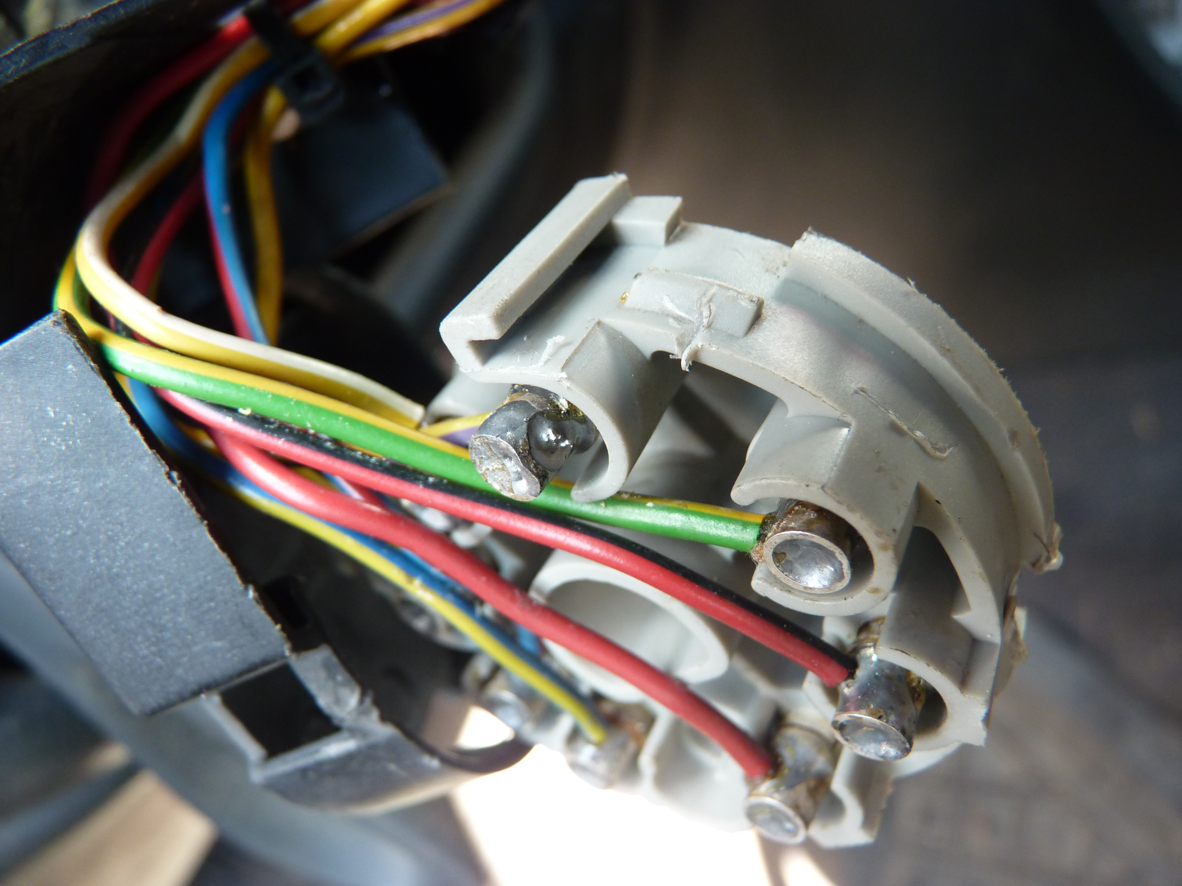

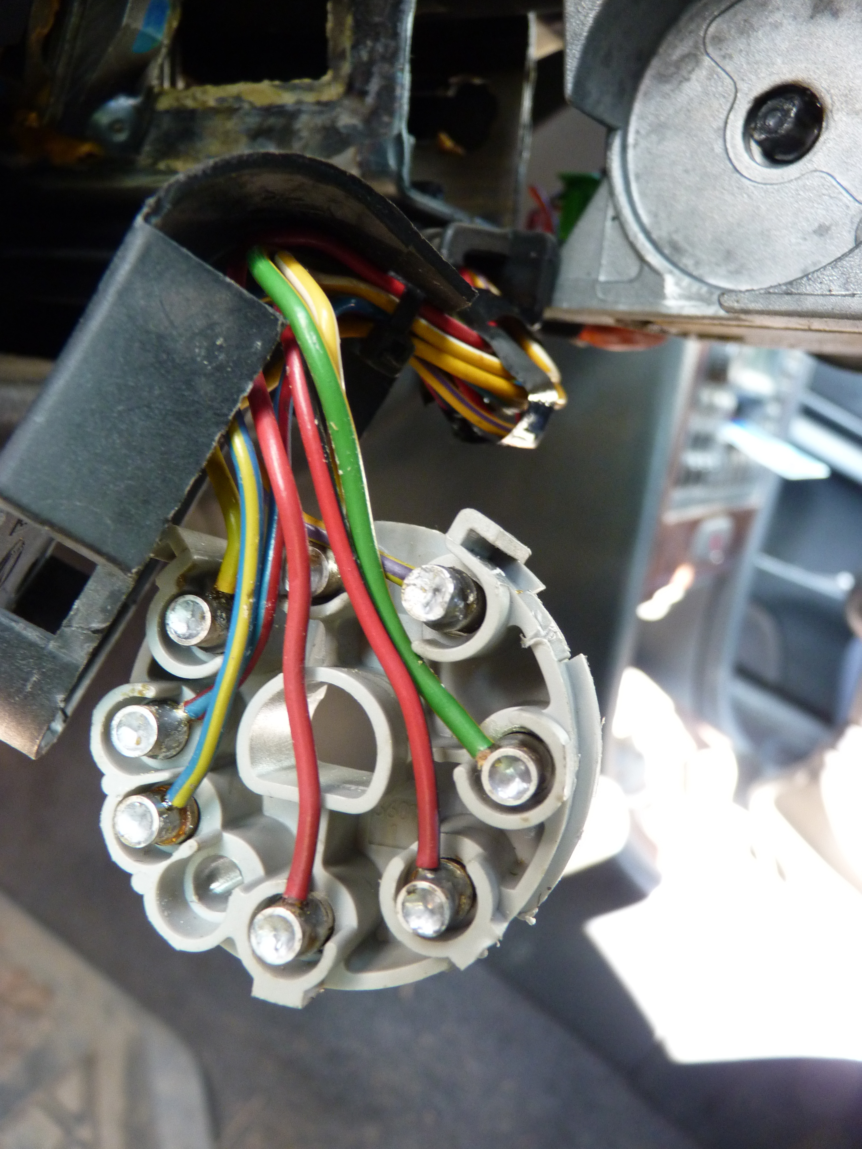

I messed up and lost the correct order of wiring behind the ignition switch.
Could someone with a V70 from 1997 take a picture of what order they are connected?
My colours look like this (the order isnt correct).
Help needed to find correct wiring to ignition switch V70 1997

Hi Erik
Thank you - I did find the wiring diagram for 1998 - and tried that. The number 50: GR-R on the diagram is actually Y-W on mine too (as on Rgiere's in one of the links you provided - thank you)
Nothing. Absolutely nothing happened when I turned ignition on. So after reading your link - perhaps I have blown a fuse - lets hope =)
Ill be trying tomorrow again.
This is a car thats going to the scrap yard and in process of taking the antenna and the switch to an other car that has intermittent stating issues - I was careless and I see now Im not the only one =)
It could also be the same problem as the car, that had ignition/starting problems =)
