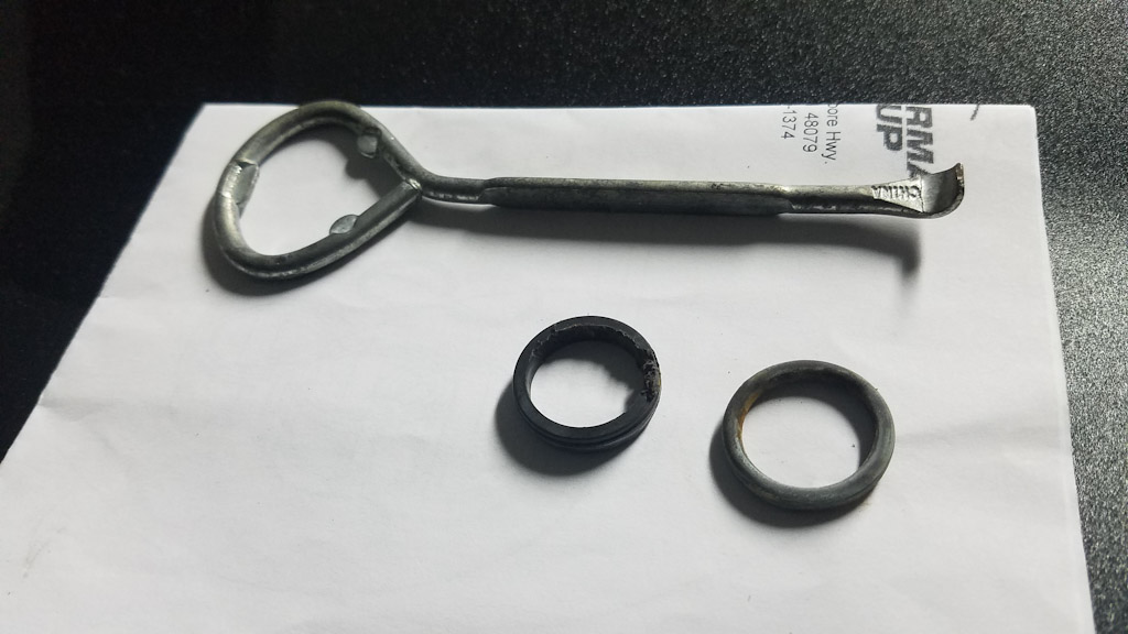

Had a productive afternoon. Pulled my swedish car parts heater core installed 5 years ago and finally ran it through the dishwasher. Wish I did that years ago, the smell is completely gone. In addition to pulling the heater core I undid my bypass of the heater hoses and installed a new junction after discovering the old one was missing a vital piece. Holy hell that is a job I never want to do again. Everyone talks about just bypassing the junction with high quality heater hose but I'm willing to give the over engineered junction one more try. Also did the copper washer spacer mod for extra sealing pressure on the O-rings. Seems to be working well, no leaks and I finally have heat again. Before I knew the junction box was bad I had to pull the old O-rings and spacers out. The tool of the day turned out to be a paint can opener.

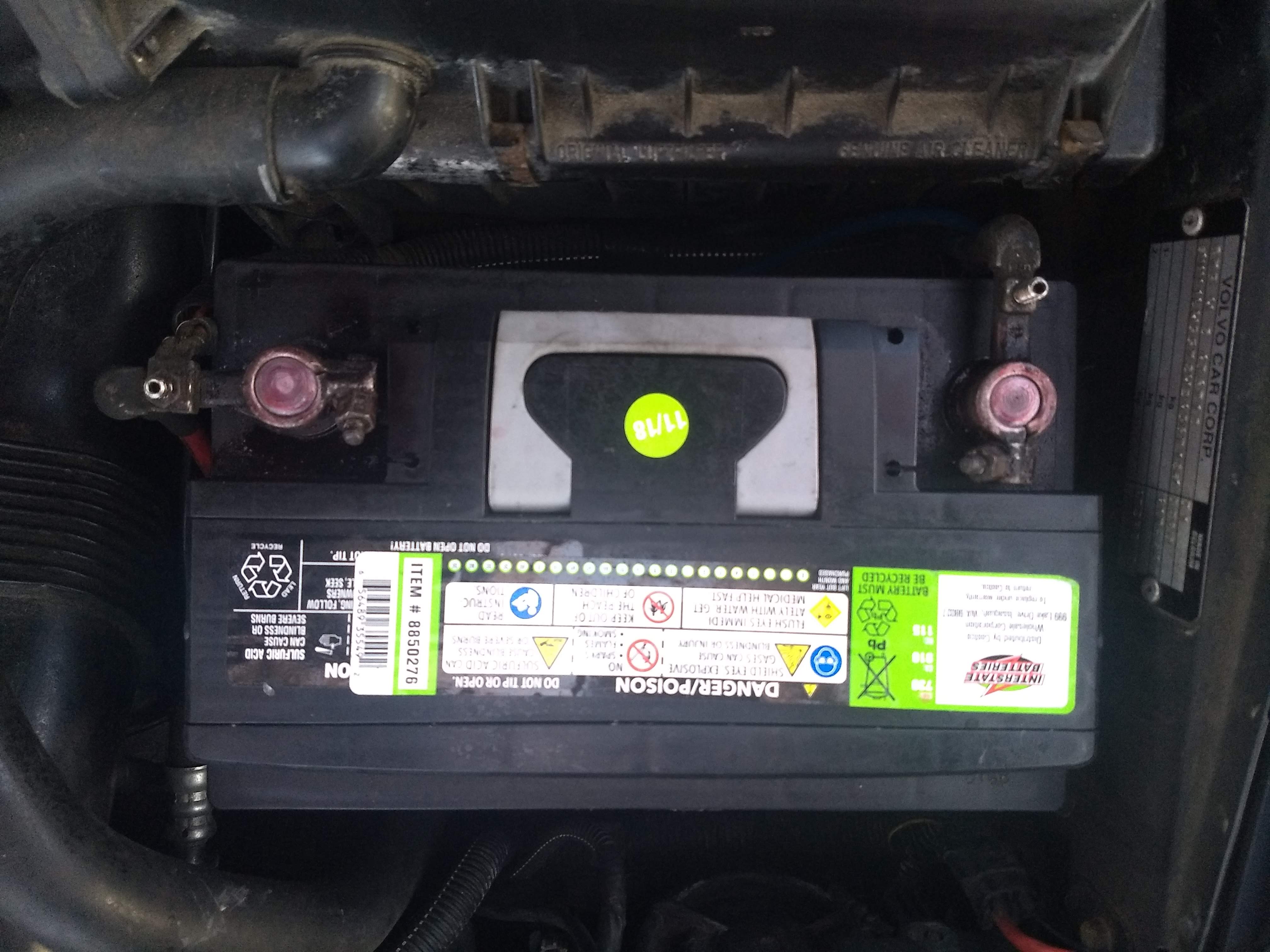

Performed some preventative maintenance on our first Volvo (a 1998 V70, and the one that shuttles the wife and kids) by swapping out our 5-year-old battery with an Interstate (730 CCA!). Cleaned the terminals with a wire brush and added battery terminal protectant.
I also, finally, replaced the serpentine belt — only a couple of years after my brother swapped the timing belt. Used belt conditioner, too.
