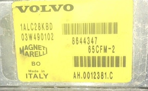

Pull the label info (picture best) from your ETM and lets figure out how many miles are on it, when it was built
You will need to squeeze your phone under the Intake Manifold to get that pic

the orange tag says something about being rebuilt and the tps sensor itself says 'Sacer' on the plastic end of it and is def the contactless upgrade.
- etmnew.jpg (53.79 KiB) Viewed 3664 times

I'm not sure how VIDA talks to a Sacer upgrade but that is probably the next set I would take
Try to get the ECM CODES read out with a good quality scanner, both active and pending ones
