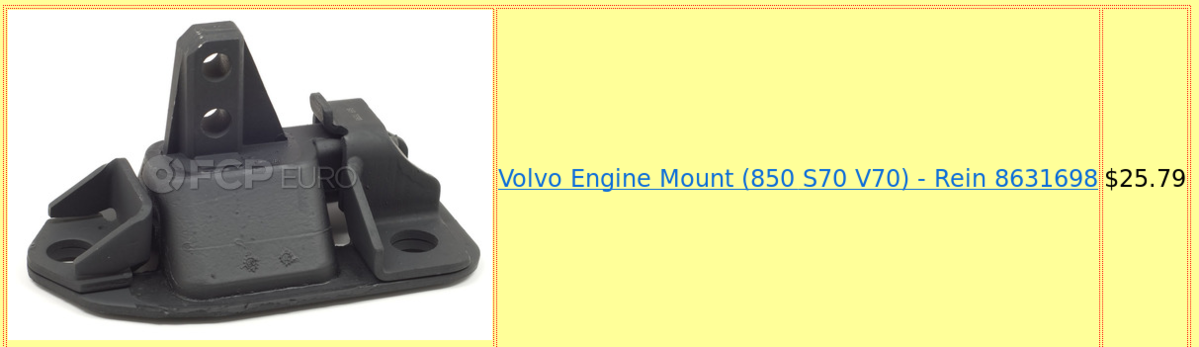

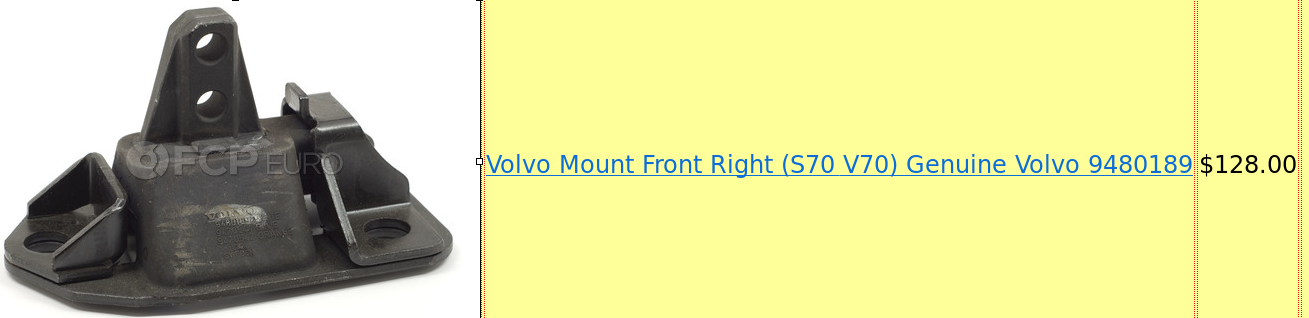

UPDATE/EDIT: Short story is that you need 9480189 if your chassis is AFTER 566268 or 8631698 if your chassis is BEFORE 566268. There seems to be no cheap aftermarket version of 9480189, so you'll have to go OEM on that one. If you look at the photos below, you will see that the upper mounting holes are offset about 3/8" to the side, and that appears to be the only difference. Note the triangular shapes on either side of the upper mounting holes to see the visible difference between the two different mounts. This change seems to coincide with the introduction of the code RN engine when the S80 was introduced. RN had a number of revisions including the variable exhaust valve timing, coil in plug and fly by wire throttle control.

I have a '99 S70 T5. FCP are telling me that I must buy a 948019 right front engine mount for my car based upon the actual VIN number. This is a correct # based upon Volvo parts lists, but I'm not sure what the difference is between this part and parts like the Rein 8631698. Is it uprated for T5 power? Is it related to wheel/tire diameter? My car is NOT all wheel drive. (I know those at least have a spacer.)
I am half-convinced that I should go with the OEM Volvo part anyway, but I'd be interested to hear from people who have worked with both parts. Are these two parts interchangeable, or not?
8631698 Volvo Engine Mount (850 S70 V70) - Rein 8631698 $25.79
https://www.fcpeuro.com/products/volvo- ... 70-8631698
9480189 Volvo Mount Front Right (S70 V70) Genuine Volvo 9480189 $128.00
https://www.fcpeuro.com/products/volvo- ... 70-9480189
EDIT: Adding photos. If you look closely at the upper bolt hole area, you can see the difference between the early engine mount and the later one.

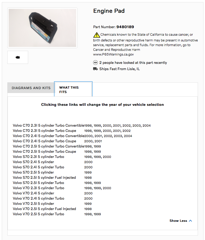

Volvo parts Lisle Info - warning - that engine mount can cause cancer..
- Screen Shot 2019-01-09 at 3.58.25 PM.png (207.74 KiB) Viewed 2450 times

Look at those model/engine combinations it does/doesn't fit. Does that make sense to you?
