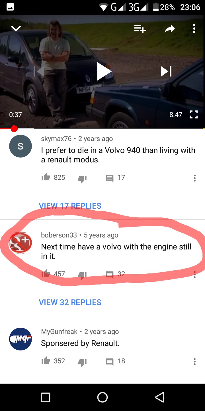

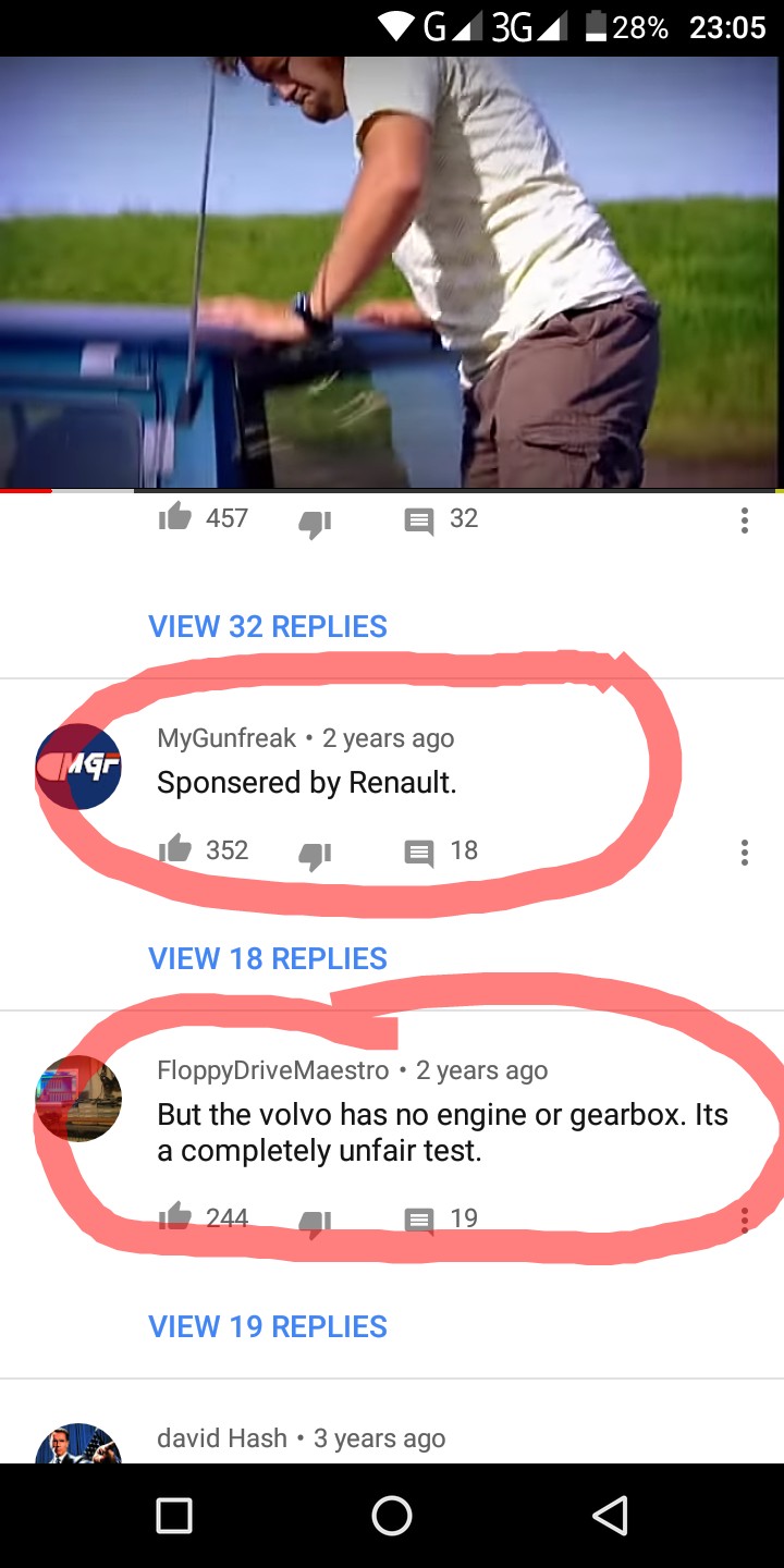

Rumour says that there was no engine in this 900 series Volvo.

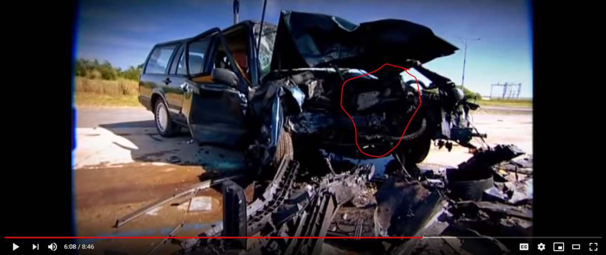

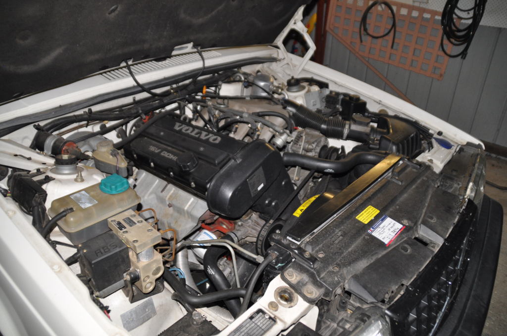

(2) Admittedly it's hard to tell, but [attached image] looks like an engine to me. See the two attached images - one screenshot of the video, one photo of a 940 engine bay. The engine was present in the crash.
(3) A longitudinally-mounted iron block engine is a safety hazard to anyone in the passenger compartment - it will transfer energy from the front bumper into the firewall and cause massive deformation to the floorboards, which in turn will cause foot injuries. There was an engine in the Volvo, but if there hadn't been the outcome would likely have been better for its passenger dummies.

- Engine bay in a 940 - look in the screenshot for the exhaust manifold heat shield and the front of the valve cover

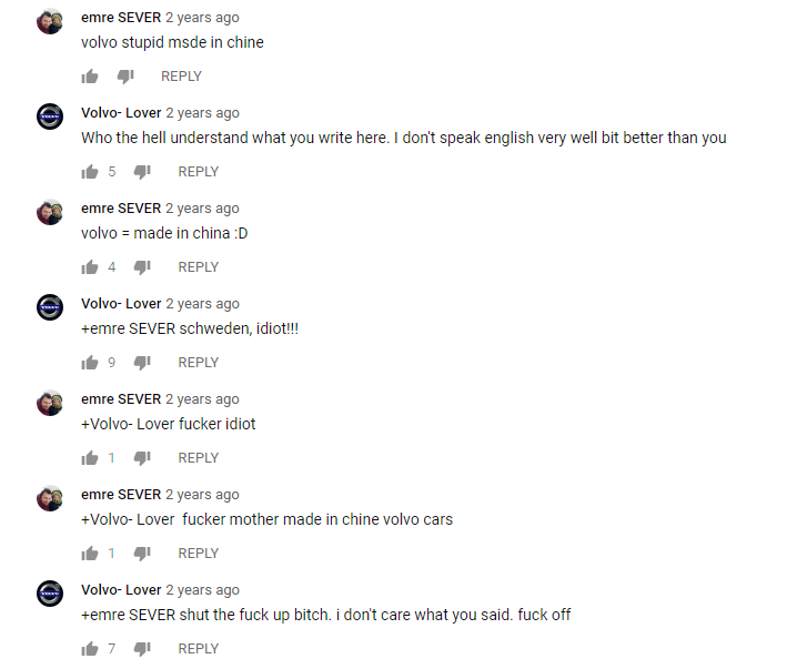

- Here are the peers of the people who suggested, with no supporting evidence, that the video was sponsored by Renault
