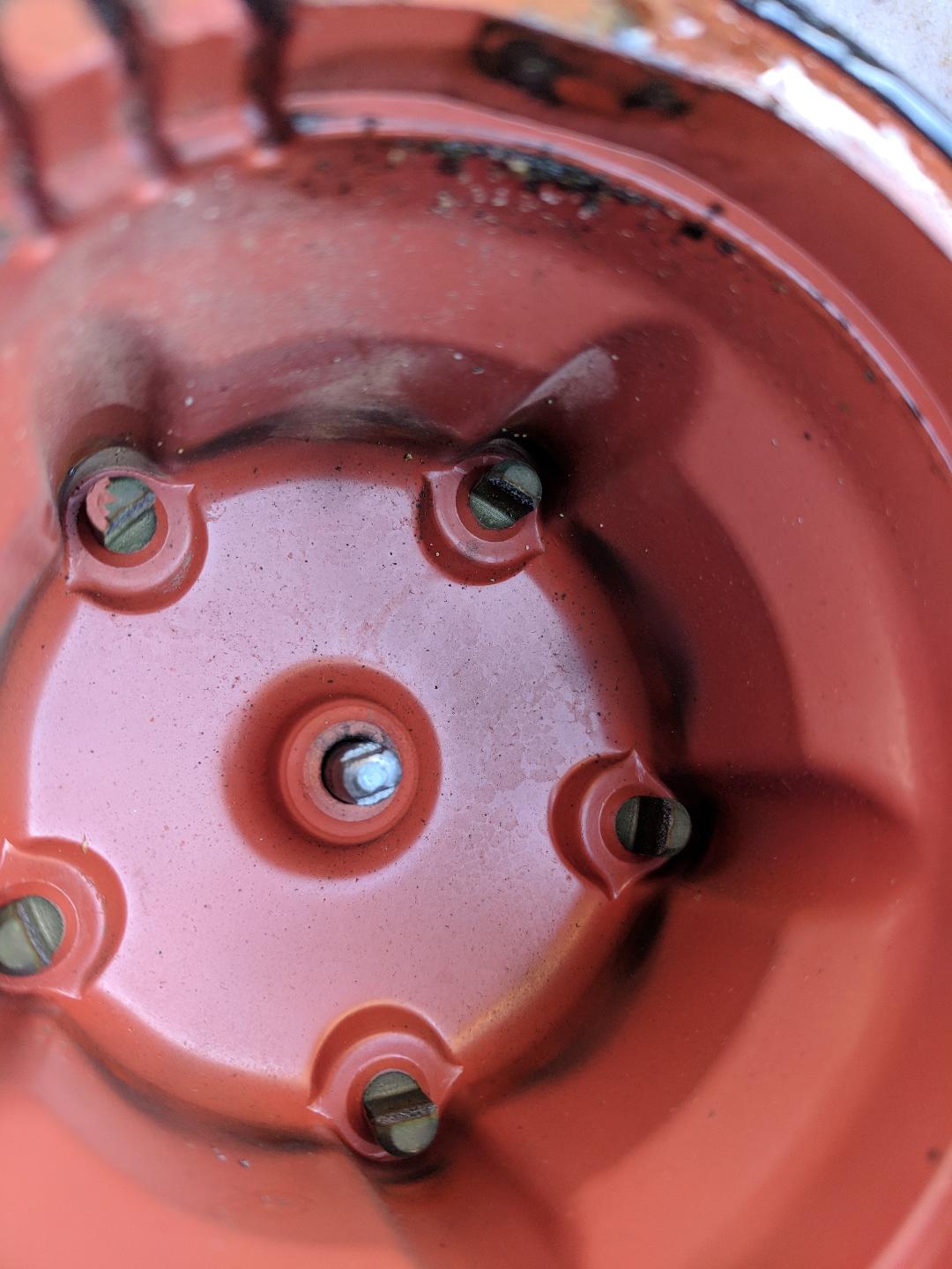

Open up the distributor cap and rotor and let's see pictures of inside

Here are the old cap and rotor and the newer but used cap and rotor...
Here are the old cap and rotor pics and the newer but used one i installed with newer used wires.abscate wrote: 20 Jan 2019, 01:29 Open up the distributor cap and rotor and let's see pictures of inside

First two pics are the newer ones I installed.

Other than being dirty, they look operable. Wouldn't hurt to clean them up a little.
