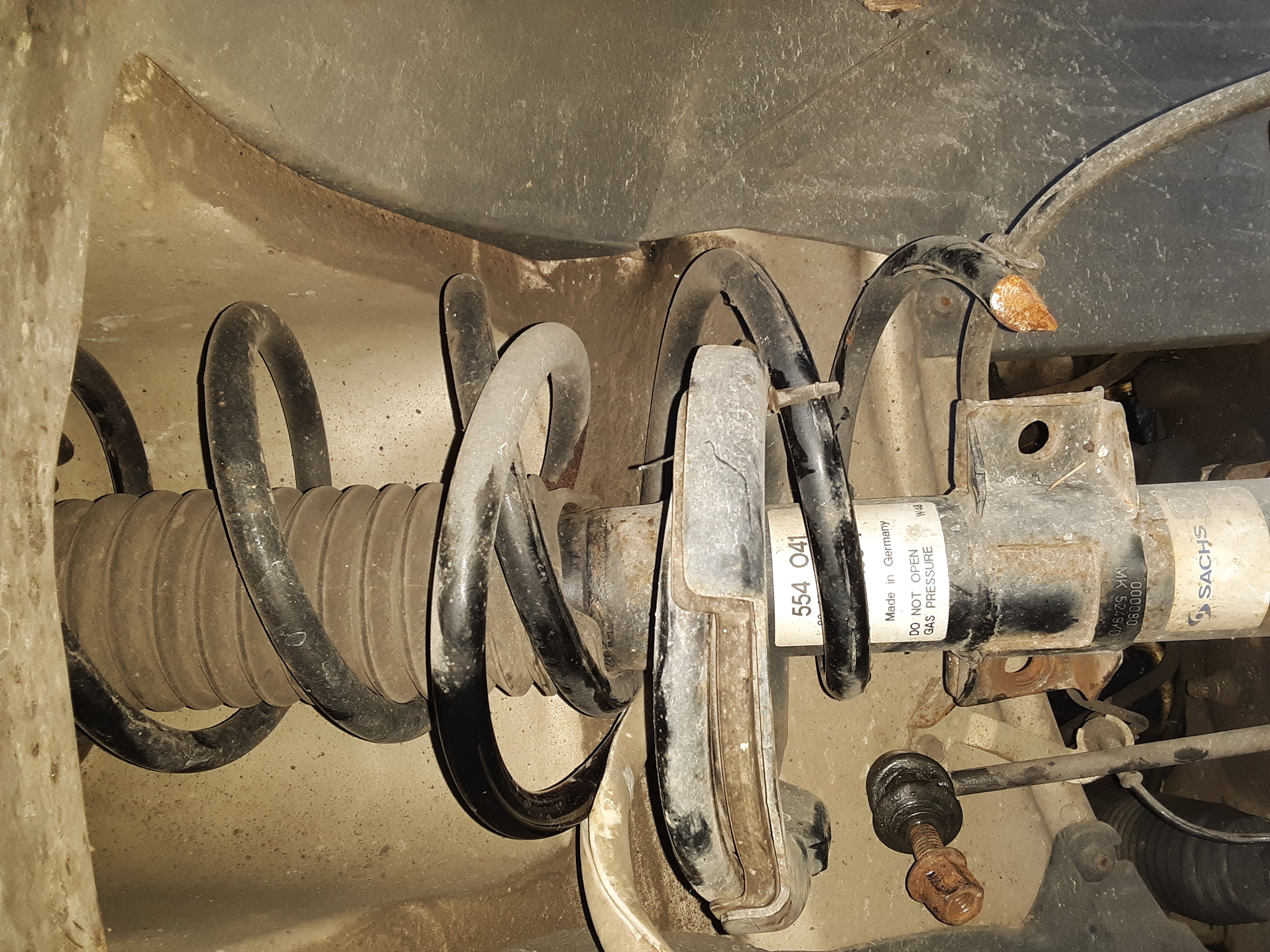

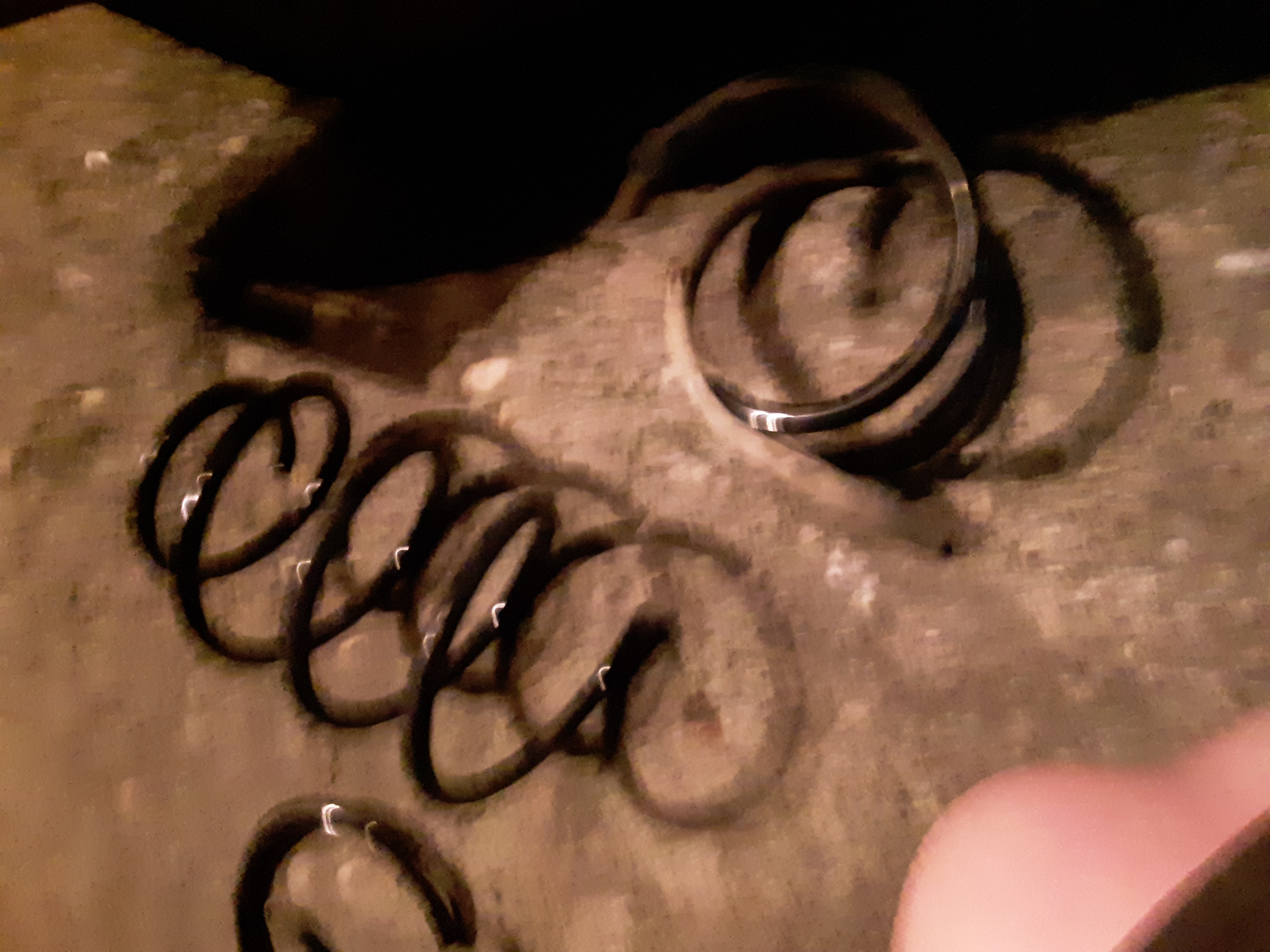

Broken spring
Broken spring
I've had the factory springs break and an OEM set of front springs break on our 04 XC70. I finally bought Bilstein springs. I had replaced everything up front...Sachs struts, factory strut mounts, cross nut, strut nut, bump stops from FCPEURO. Only thing that failed was springs. Sachs are better than most cheap aftermarket shocks like Monroe or Gabriel. But I agree that the original shocks that came with XC70 felt better over bumps.
The pic of broken was third one to brake since ownership 6 years ago. The spring broke and jumped underneath the spring seat. I had to cut spring off of strut for removal after releasing strut nut.
