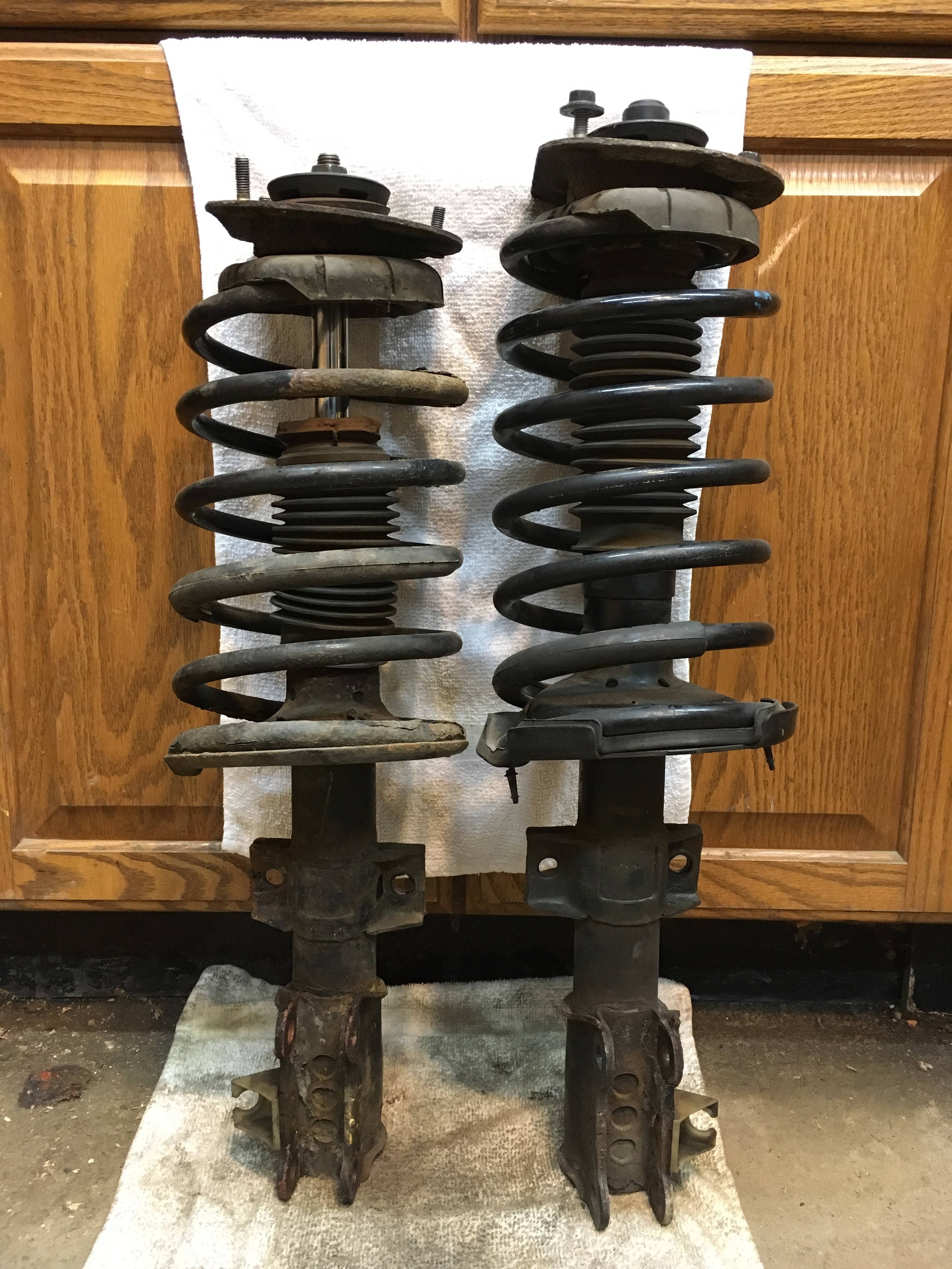

I'd be willing to bet they put in V70 struts. I bought an 06 XC70 a couple years ago. It had been "serviced" just prior to me purchasing it & the "tech" had replaced the drivers front strut. They charged the PO $300 for the "new strut" & another $200 to install it. I bought the car, & when my wife was driving it home I noticed it leaned to the left. Looked it over a bit & sure enough, the "tech" had put in a V70 junkyard strut that looked like it had been at the bottom of the Dead Sea for about a decade :lol:
The shock & spring are both different in XC fitment. The shock has a longer stroke. Side by side on a bench this is pretty obvious.
Edit: added photo

That quick strut seems to be made for the S80 (heavier car), V70 AWD and XC70. I had a genuine S80 spring and strut disassembled, they were almost identical in length with the S60 spring and strut, only the S80 spring had thicker coils (and perhaps a taaad longer spring). My wild guess is those quick struts are actually too short for the XC70
In the above photo I think both the strut and the spring are quite longer in the XC70 (compared to the S60/V70/S80)
